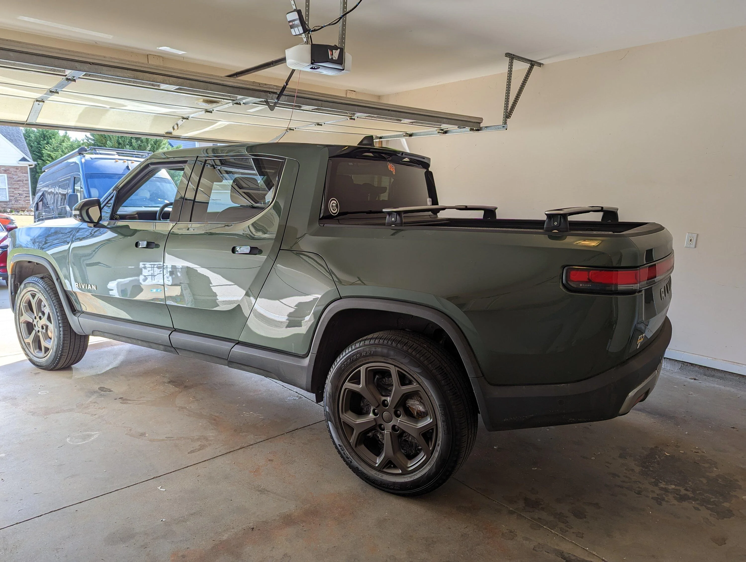

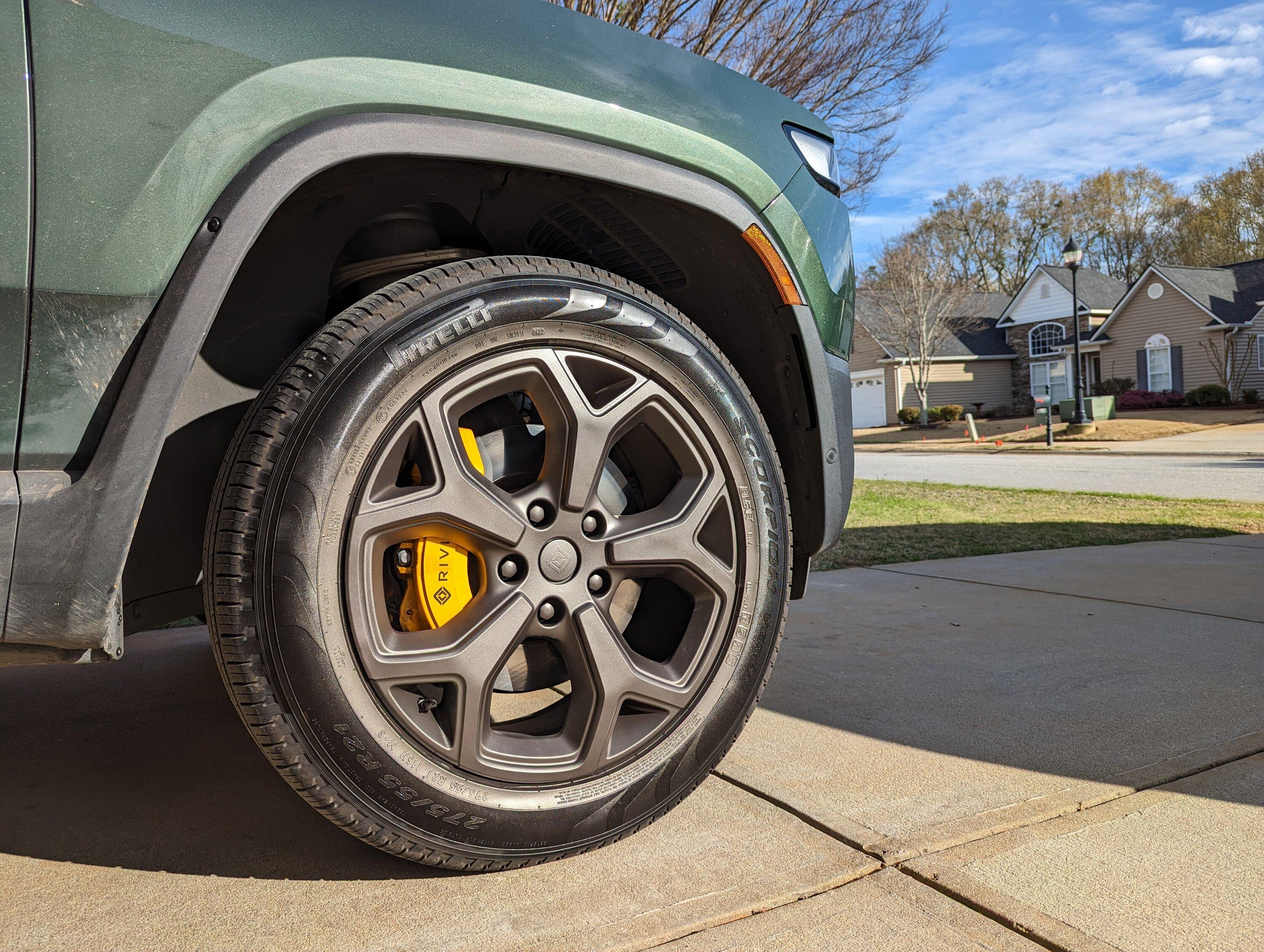

Finally got around to following through on my intent to dip my factory 21" wheels. I used the kit from DipYourCar that comes with cleaner, brake masking bags, dip release, and 5 cans. Prep wasn't bad, and I ended up doing 3 light dusting coats and 3 heavy wet coats. I went with The Hyperdip brand Brass Monkey to pair with Forest Green. It's definitely not a color you'd use with Red, Black, Blue, or Yellow but with Forest Green I think it looks great. Not the cleanest job but the overall look is good enough for me and much better than the factory 2 tone finish.

One more glamour shot

Looks great. Reduces the flower look of the 21’s!
Yeah a solid color really makes it look a lot better. The actual wheel pattern is very similar to one of the primary Jeep Wrangler wheel pattern but the machined face really draws the eye to the flower petal look.

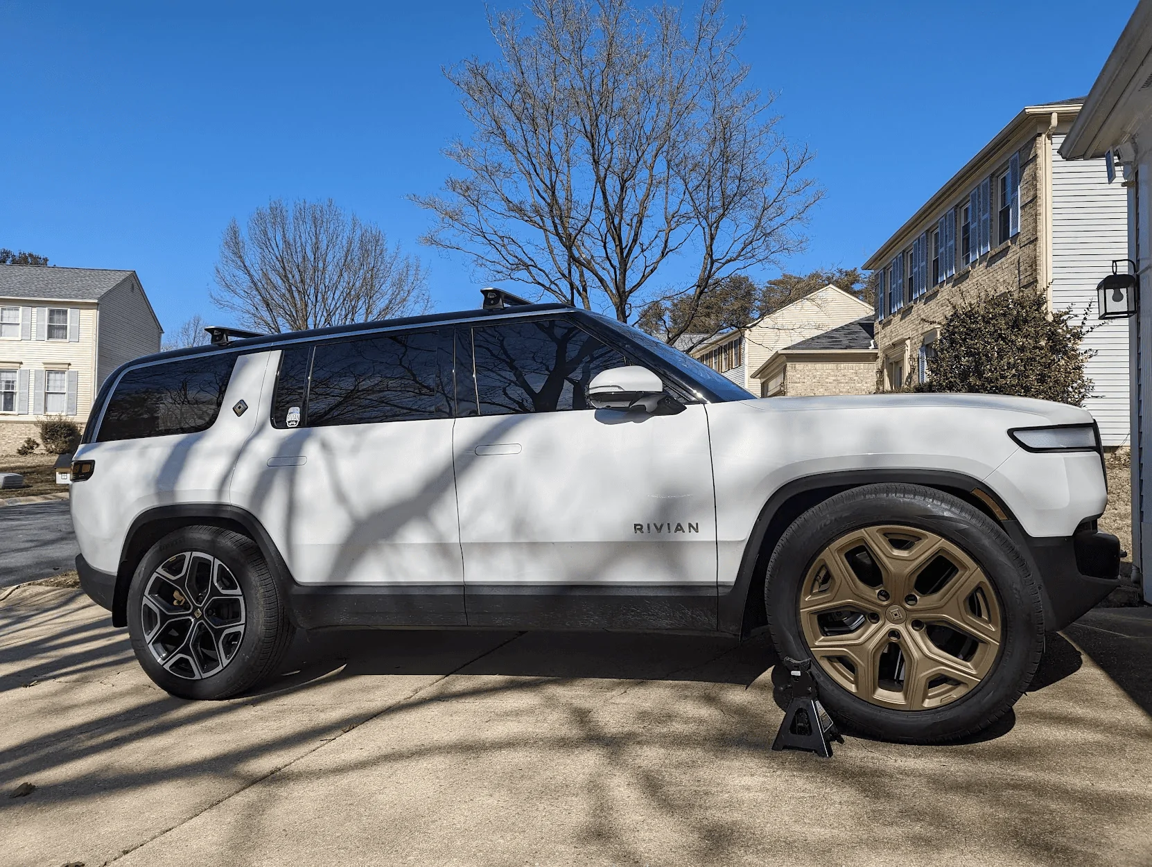

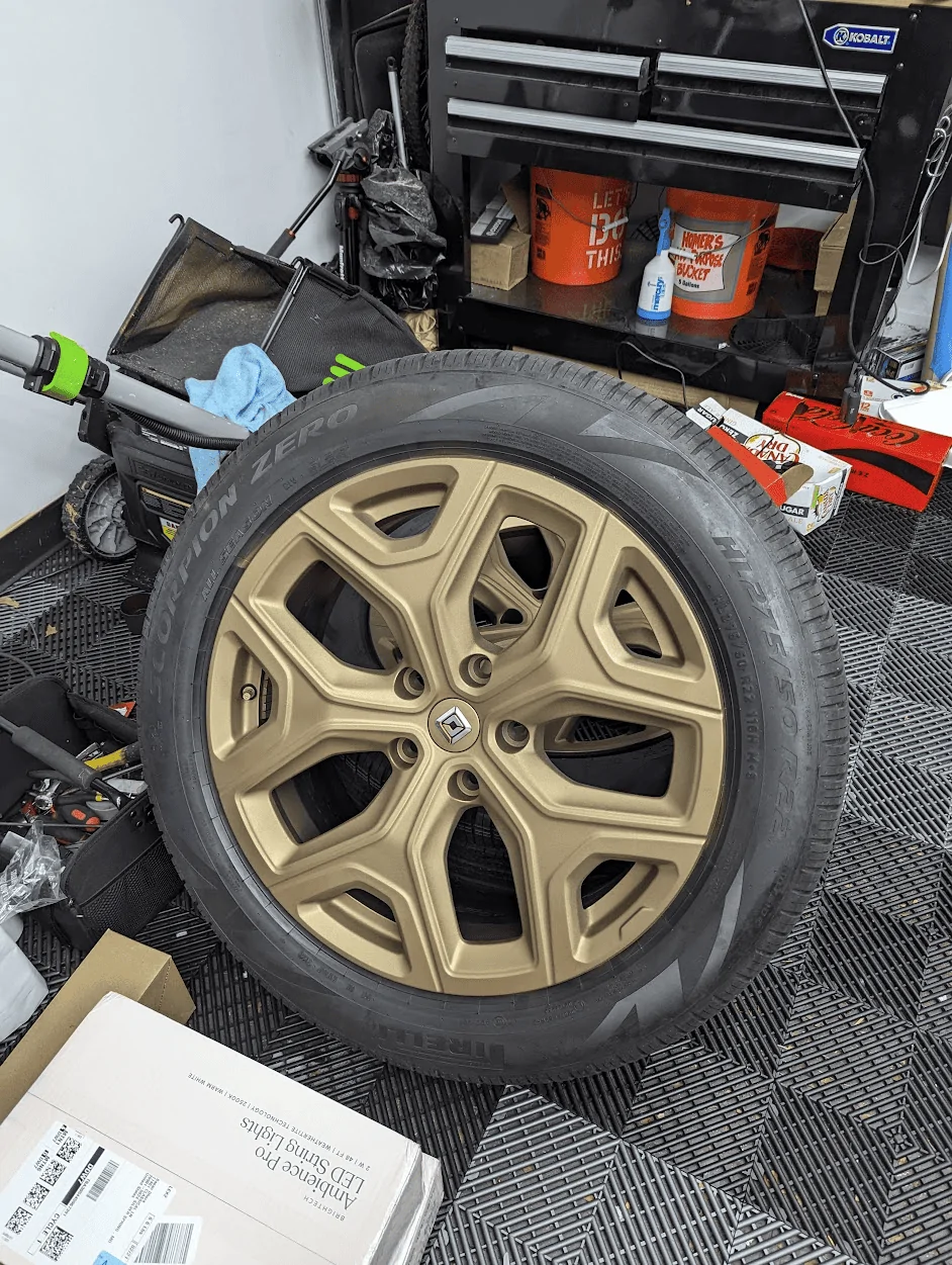

It looks great in the Sun, I was not a fan of how it turned out in the shade/dark so i ended up with the the lighter yellow one (to which I also didnt like) so ill do with black LOL.
Yeah in the dark where the metallic flake doesn't show as much it has more of a gunmetal/charcoal look to it but even that's better than the two tone factory.
I did get a can of the bronze gold as well to maybe do a top coat with it and lighten it up but I was so happy with how it looked that we decided not to use it.

Did you spray the tire as well?
I used the dip release that they sell as part of the kit so you don't have to tape it off. I took these pictures before peeling off the overspray but it peeled off pretty easily. A lot easier than the index cards or trying to use masking tape.

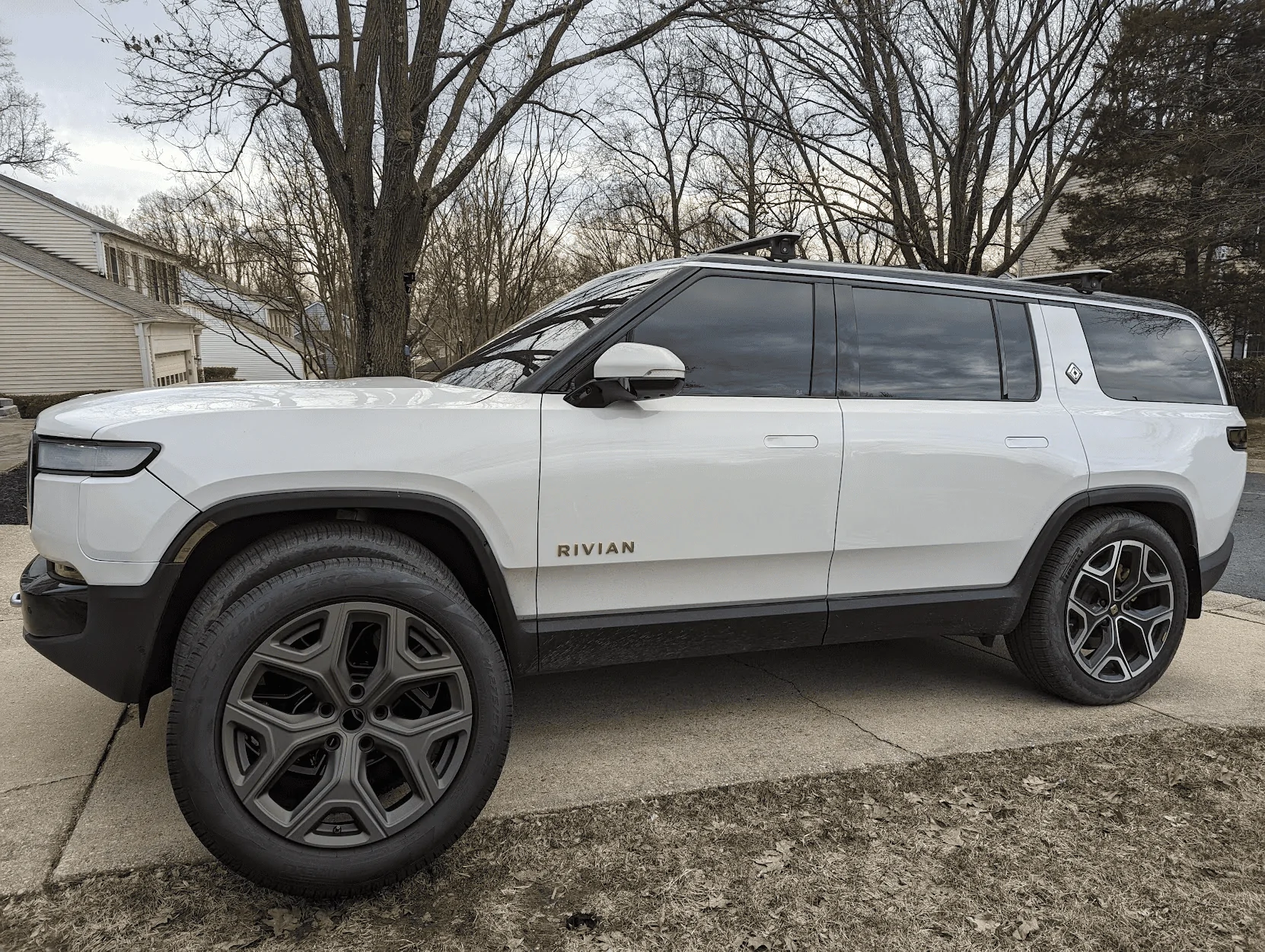

Rivian R1T R1S Plasti Dipped 21" Wheels in Brass Monkey color by HyperDip 1678334126423
Rivian R1T R1S Plasti Dipped 21" Wheels in Brass Monkey color by HyperDip 1678334169070
