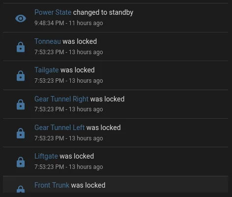

p3ck
Bill
May 3, 2021
198
289
Massachusettes, USA
Rivian R1T R1S Phantom Battery Drain Issue Solved? May be frunk latch failing to fully engage and preventing Rivian from going to sleep fully 1670595022746
Running Home Assistant with the unofficial Rivian integration is amazing. Thanks to the hard work by the community members for this. This info is available and should be made available on the phone app...

DTown3011
Jun 7, 2022
1,666
2,218
Please tell more about this inregration!
