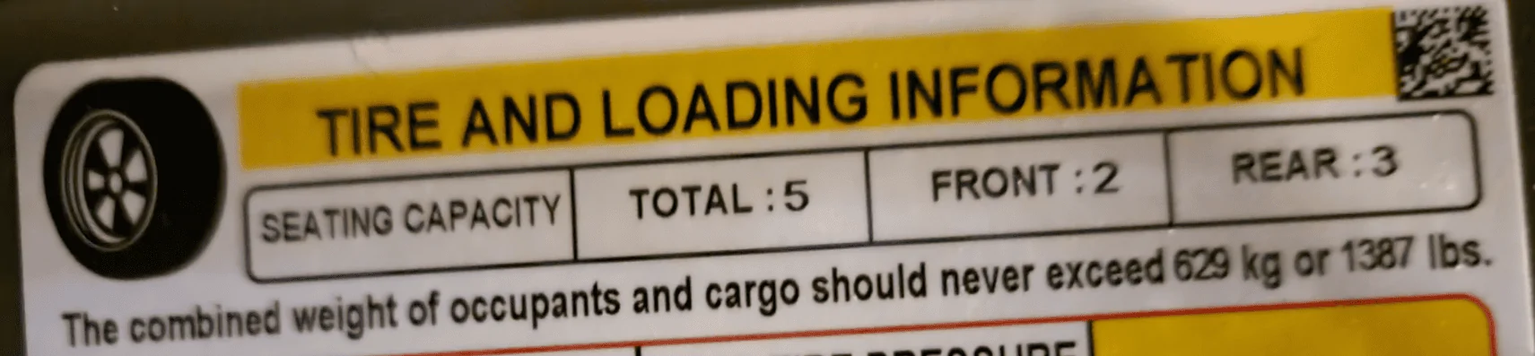

Just so you know, the 1700 lbs is discounted by the weight of options. I have Launch Edition with underbody shield and a spare (22"). Here's my sticker:
Rivian R1T R1S Payload Hauling Range - not towing, just cargo 1661306804030

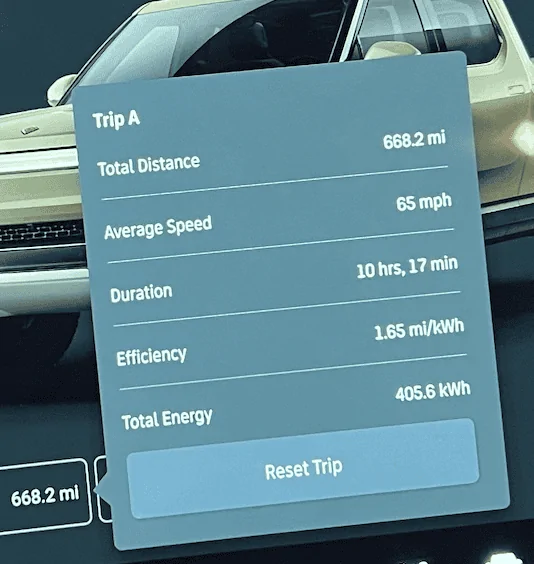

Just finished a round trip from SF bay area to Boise Idaho and back. About 900lbs of total payload heading to Boise and about 1300lbs heading back (above).
Summary of return trip is below.
I'll start a new thread with more details but a trip like this with this payload on this route really needs the Max battery. I don't think I could have done this in the winter - correction, I could not have done this trip in the winter.
Rivian R1T R1S Payload Hauling Range - not towing, just cargo 1663804496601
