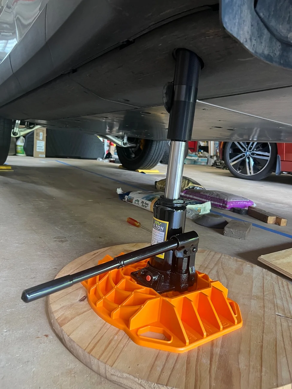

I would not trust any bent/deformed jack, especially with a vehicle as heavy as a Rivian. Not planning to use the OEM jack - I have the revised version. Here’s the setup I used to change from my 20” AT winter set to my 3-season 21” wheels.
EVSportline 6-ton bottle jack
EVSL aluminum billet jack puck
ARB jack base (15,400lbs rated)
And a 1” thick wooden table top needed to change the rear but not front wheels.
I also have the 200 foot-pound torque wrench, longer breaker bar, and rim-protecting deep well socket from EVSL.
