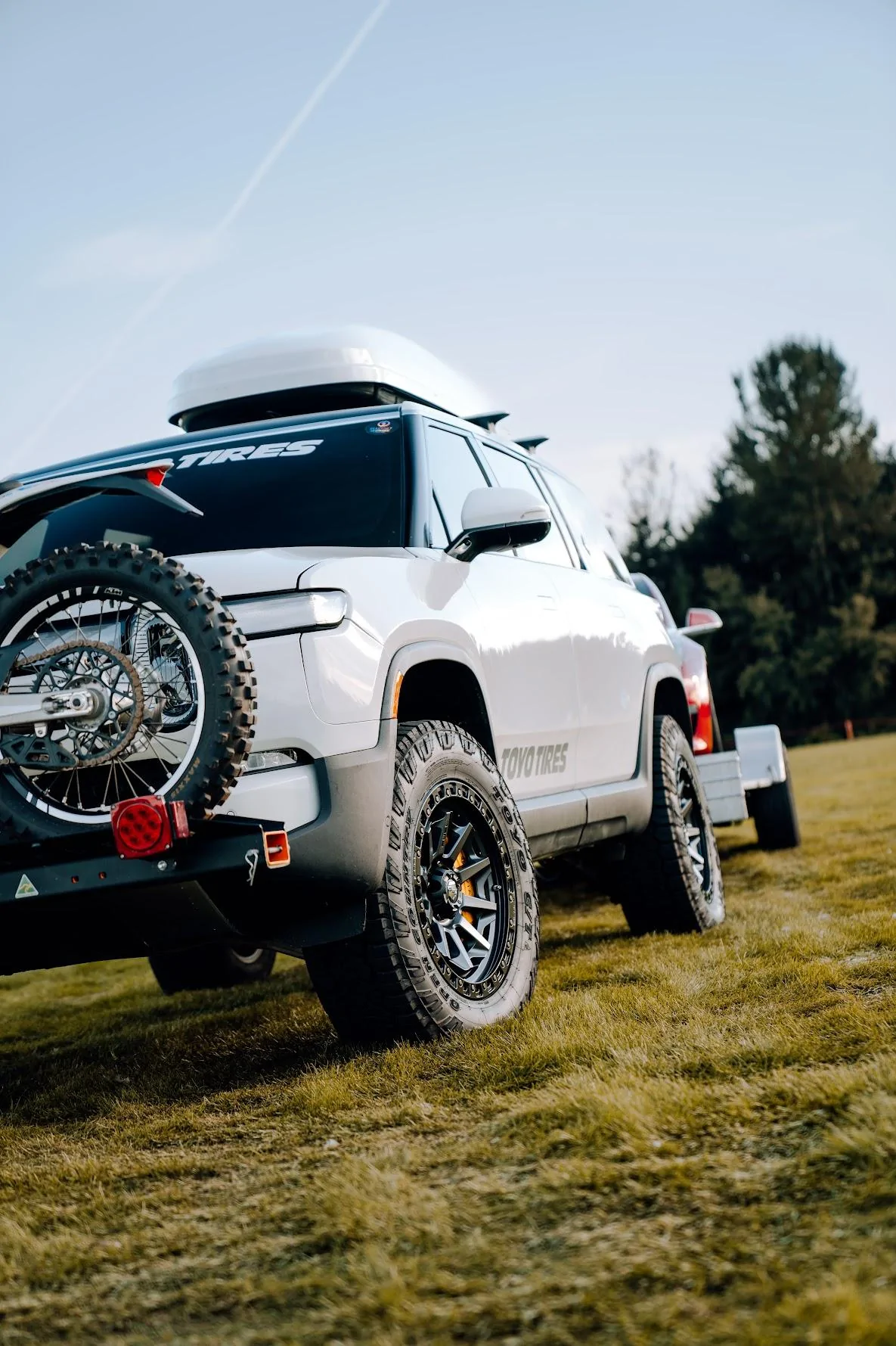

Ordered new 20” wheel with +48mm offset from Tirerack

Just make sure the spokes on wheel clear the front brake caliper. The Dodge wheels have the same offset but some of them will not clear the brake. That's why it's important to get the correct wheel model if going the Dodge route. The wheel spokes are different thickness. The Tirerack wheels may work fine but check them for wheel to caliper separation when you get them.

Following as well. I do like these, and they're tempting. I'm planning to grab a set of Hakkapeliitta OutPost nAT at 275/60r20 and have been debating on what wheels to slap them on.

And also make sure you get the proper wheel centering rings. Not having the proper centering ring will cause all kinds of problems with wheel balance and weight distribution when wheels are installed on the car.

This is exciting! Please tell us if a centering ring is needed and show pics!
I hope the weight rating works for rivian. I sent a note to tire rack to confirm.
Yeah I will get them next week and take a look to see what size hub they are made to accomodate and then order the appropriate centering rings. So little info on the tirerack site about these yet.
My googling makes me think Radius has been bought out by another Italian company, Fondmetal, and I can’t find these wheels listed on their website either.
