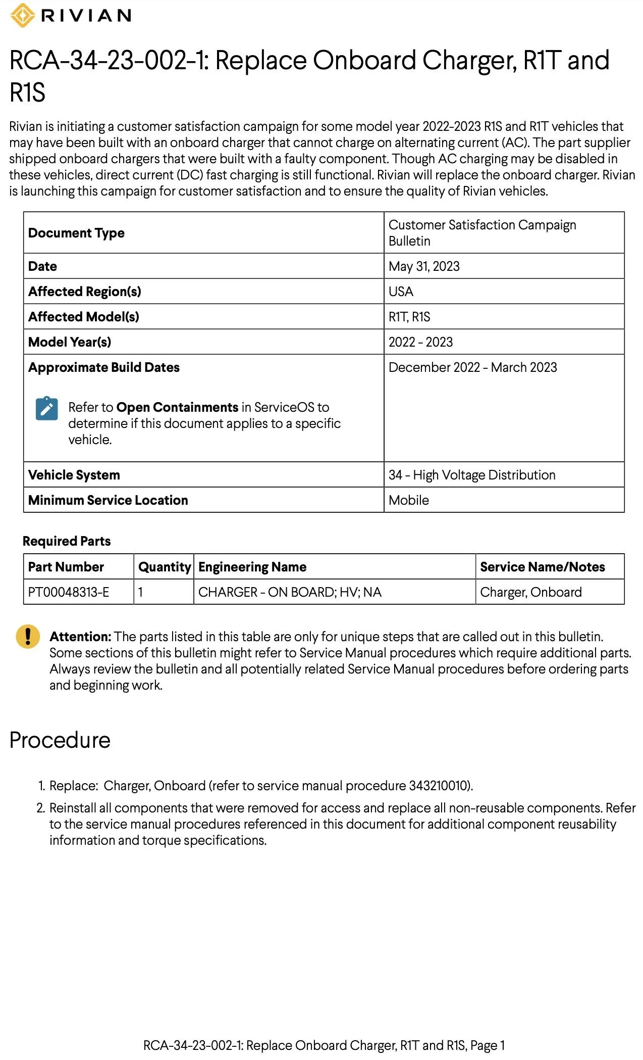

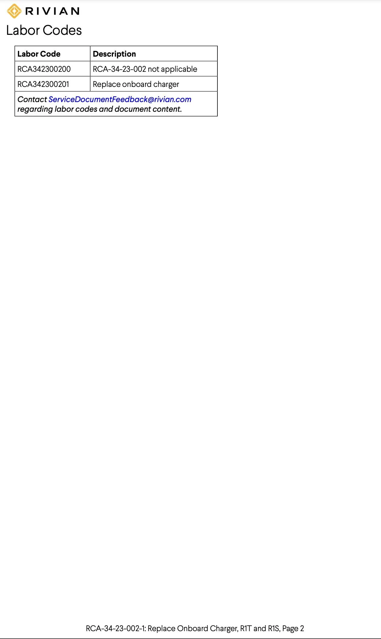

Looking through the NHTSA site again today and saw an advisory for AC charging failure
"Rivian is initiating a customer satisfaction campaign for some model year 2022-2023 R1S and R1T vehicles that may have been built with an onboard charger that cannot charge on alternating current (AC). The part supplier shipped onboard chargers that were built with a faulty component. Though AC charging may be disabled in these vehicles, direct current (DC) fast charging is still functional. Rivian will replace the onboard charger. Rivian is launching this campaign for customer satisfaction and to ensure the quality of Rivian vehicles."
Potential build dates from Dec '22 - March '23
https://static.nhtsa.gov/odi/tsbs/2023/MC-10237165-0001.pdf

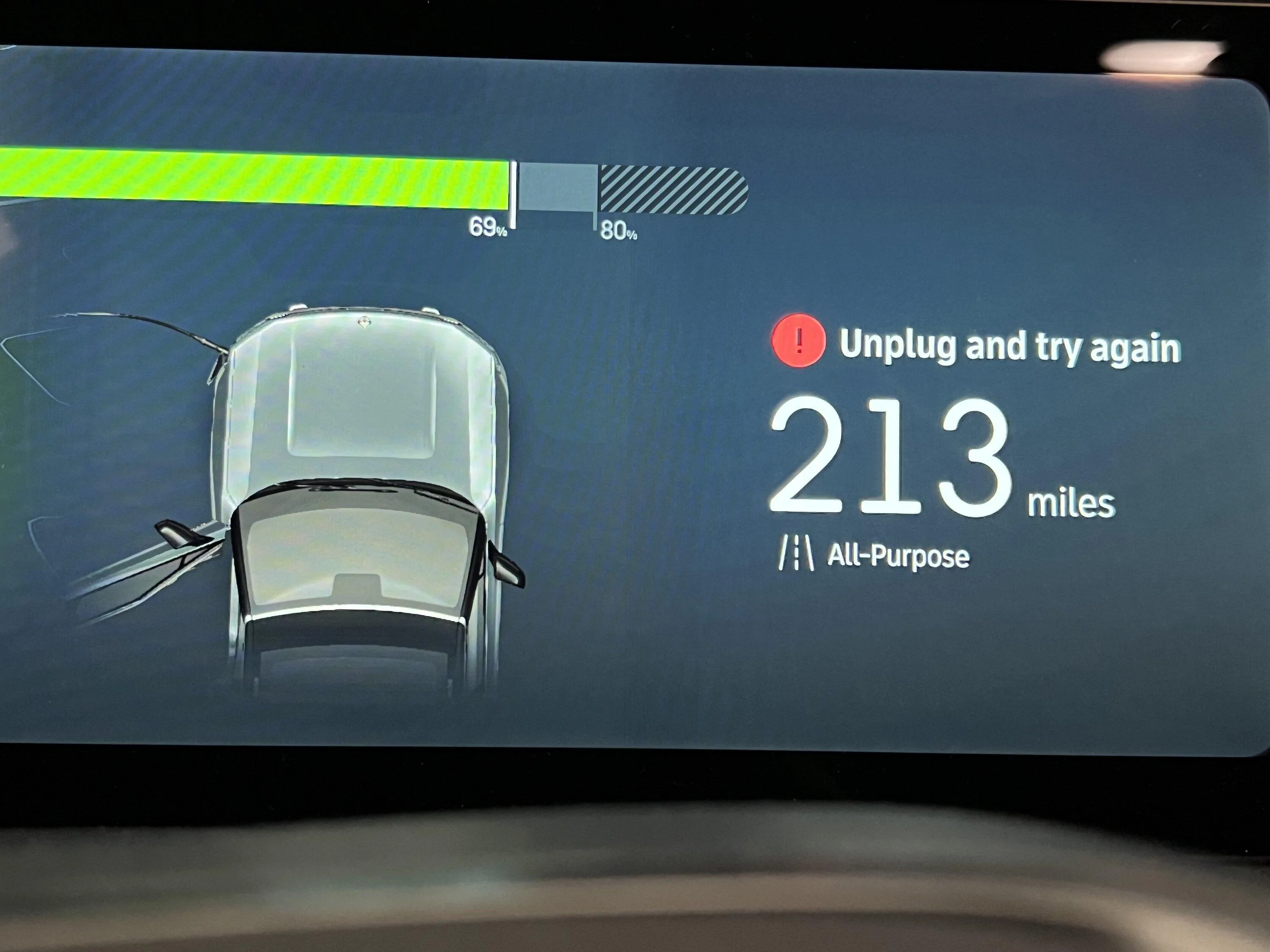

Mine has failed. I'm unable to AC charge. Going on a trip soon and will DC charge until then...
Rivian R1T R1S Onboard Charger AC Charging Disabled [Customer Satisfaction Campaign Advisory] for 2022-2023 Rivian R1T / R1S --- (? RCA-34-23-002-1) IMG_9837
I'm 9300 VIN made/delivered in May.

Try lowering the charging amperage down to 40 or 32 amps and try again.
Doesn’t work. Tried that earlier in the week.
Mobile tech was here Monday and manually turned on the AC module since it wasn’t even coming on to charge. Threw a ton of errors.
Getting it towed to the SC next week after we take a small road trip.
LivingInKaos
Jun 30, 2022
543
1,019
R1T Launch Green Forest Edge
Own Fabrication Company
Oh, sorry to hear that. At least they've already diagnosed the problem, so hopefully they get your R1 back in your driveway quickly.
