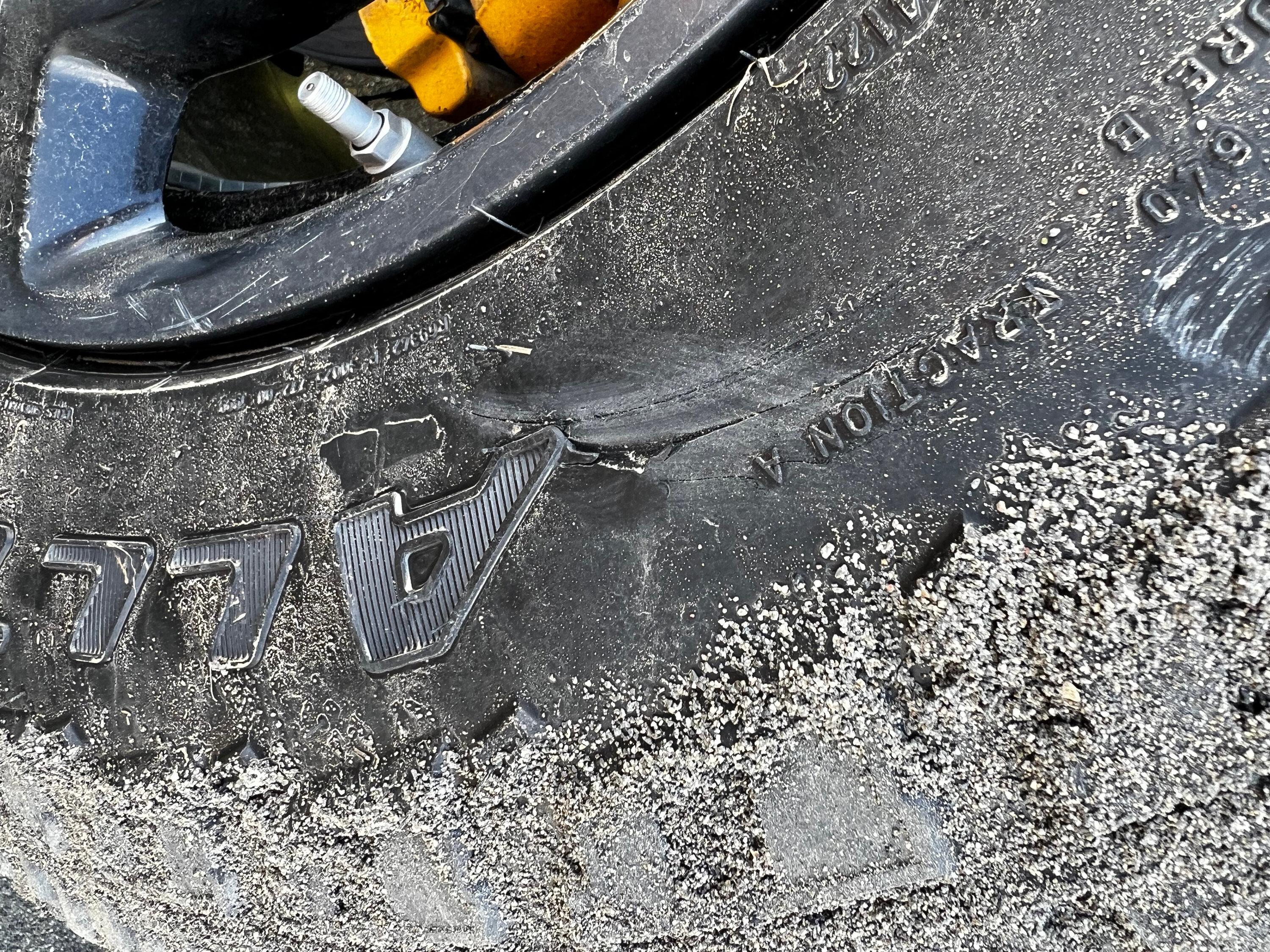

These sidewalls are pretty soft. This was at street pressure, in light sand with a few scattered rocks. Must have clipped one of them.
Rivian R1T R1S Off-Road Tire Pressure? IMG_3894
I aired down to 32psi after that, and stayed away from the sand that could hide more rocks like the one that gashed my tire. At 32 it feels perfect: The right amount of sidewall deflection, it dampens out the sharper impacts nicely.
