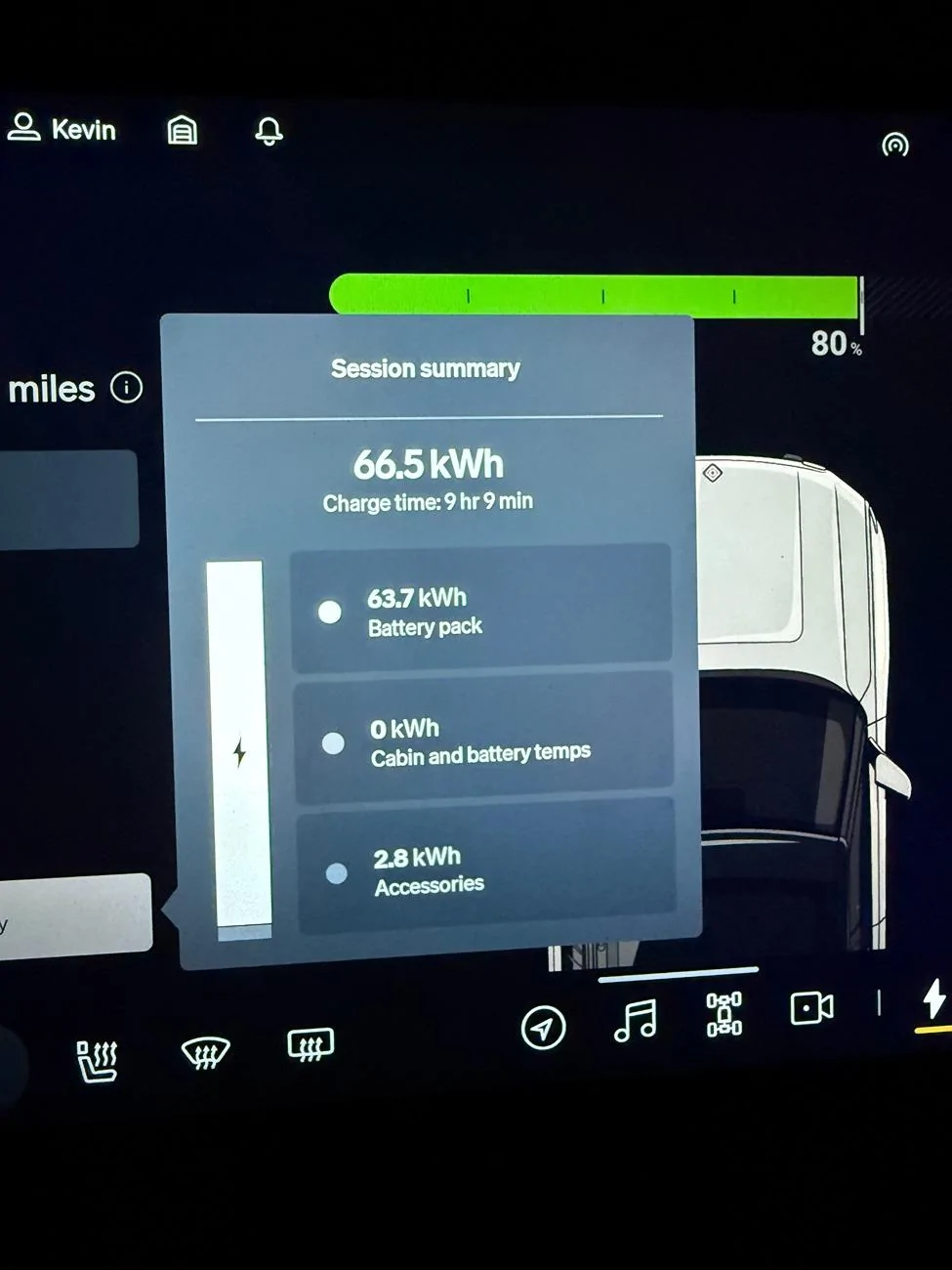

So I guess the charge I received in 9hrs and 9mins to 80% capacity is correct.

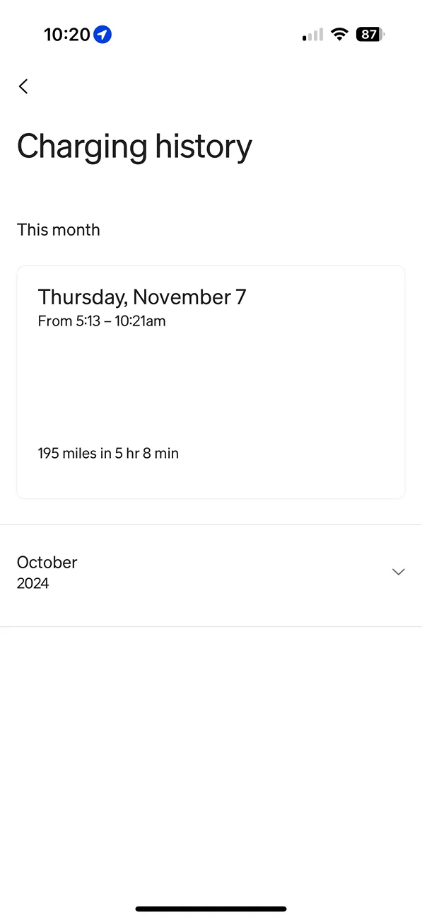

You can look at a detailed charging history from last session on the app
Rivian R1T R1S Not sure about home charging speed? IMG_3139

This is what the app screen shows which is different than what the car shows.

The way that Rivian displays charging time is usually wrong. It will display how long it's been plugged in vs. the actual total charging time. My guess is your truck got to 80% in 5 or 6 hours and then it topped off again around 9am. Therefore Rivian shows that it charged for 9 hours when in reality it's probably closer to 6.

I think the truck is right in this case, you are just using the charger that came with the truck correct?
If so max charging speed of that charger is 32 Amps, or about 7.6 kW/hr. The truck says it took on 66.5kW in just over 9 hours which is about 7.4kW/hr. Take into account some losses and that seems to line up.
I'm guessing you started charging around 30% and then charged up to 80%, if so 9 hours on a 32amp charger seems about right.

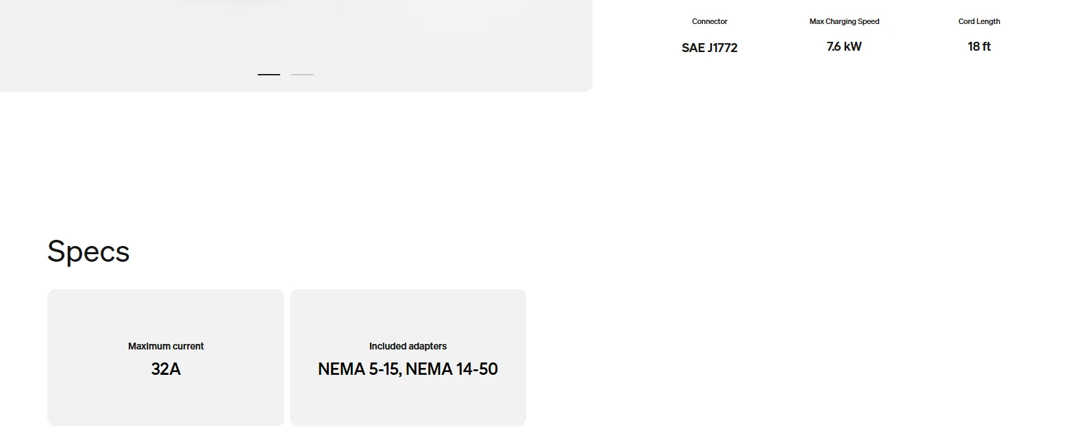

Sounds like you are using the mobile connector, which is limited to 32A.

That indicates you might have charged at 32amps. With your Nema 14-50 and Rivian mobile charger, you should be able to get 40Amps top (equals to 9.6kW), so that same charging session (66.5kw) should've have taken roughly 7hrs.
From the menu where you took that screenshot, check the BOTTOM RIGHT option when your charger is connected, and see if you can up the AMPS to 40A.
I think the mobile charger only goes to 32Amps
Rivian R1T R1S Not sure about home charging speed? 1731081838497-bv
Exactly! I noticed this in my first few days of ownership. I plugged it in about 2% below full and went to bed. The app told me "30 miles added in 9 hours" or something like that. It counts the entire time plugged in vs. the time it took to actually charge it which was about 15 minutes.
