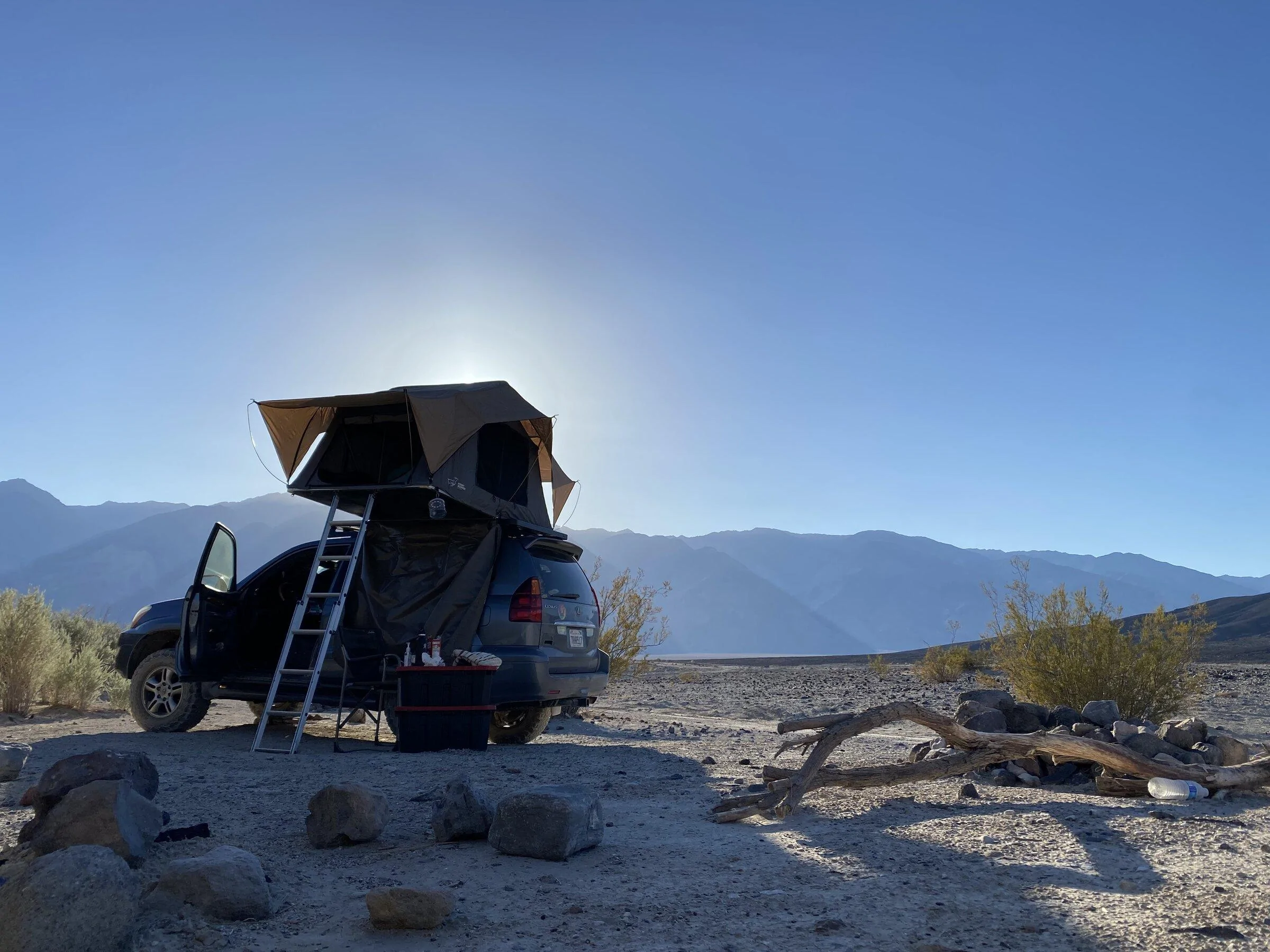

I have a CVT tent...better build quality than the Yakima unit.
https://cascadiatents.com/
Edit: Mine is a Mt. Shasta. They used to sell the Summit Series upgrade that gave them thicker canvas and other goodies like built-in LED lighting, etc. I apparently missed that sizing may be an issue...I'll have to measure crossbar spread at some point on someone's truck to see if my smaller tent will actually work. That said, CVT offers plenty of 3 and 4 person models that would fit if the 2+ size doesn't.
