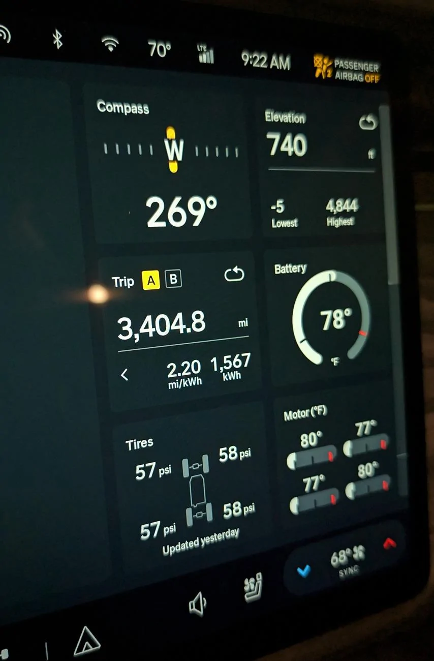

j-Thrice
May 24, 2024
'22 R1T Quad Large 20" Limestone, '24 R1T Dual Large 22" White
For another data point.
I'm up to 3400miles on my nATs. LT275/65/20. Mix of hwy/city commute for the most part except a trip out to the WA Coast and some beach fun, and that ECRC trip up to Lonesome Lake. Keep mine 54/55 psi cold.
Reset my trip computer the day I put them on and have kept it since I was curious about the efficiency difference my truck had vs OEM Pirellis. Reading 2.20kw.

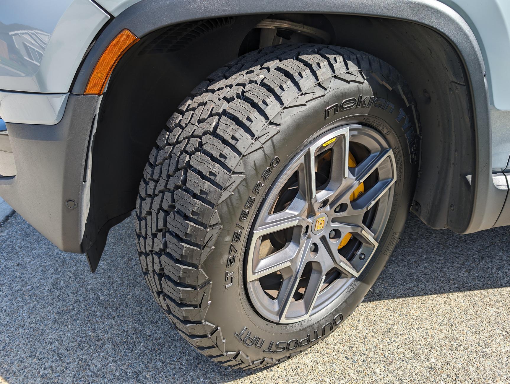

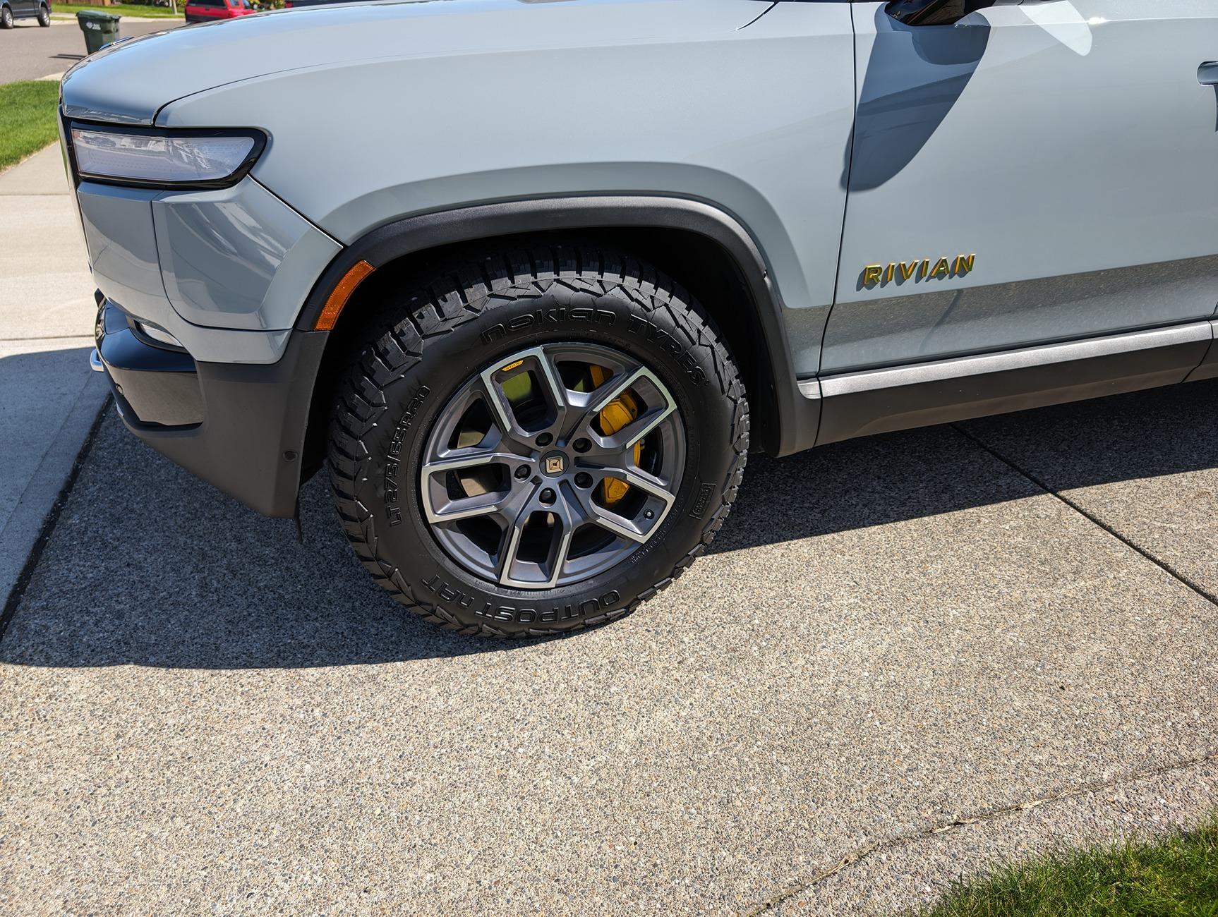

EVTrukHog
Matt
Aug 31, 2021
34
649
997
R1T, C6 Corvette, Ford Explorer
any of you R1T guys have photos of the 20" nATS?
