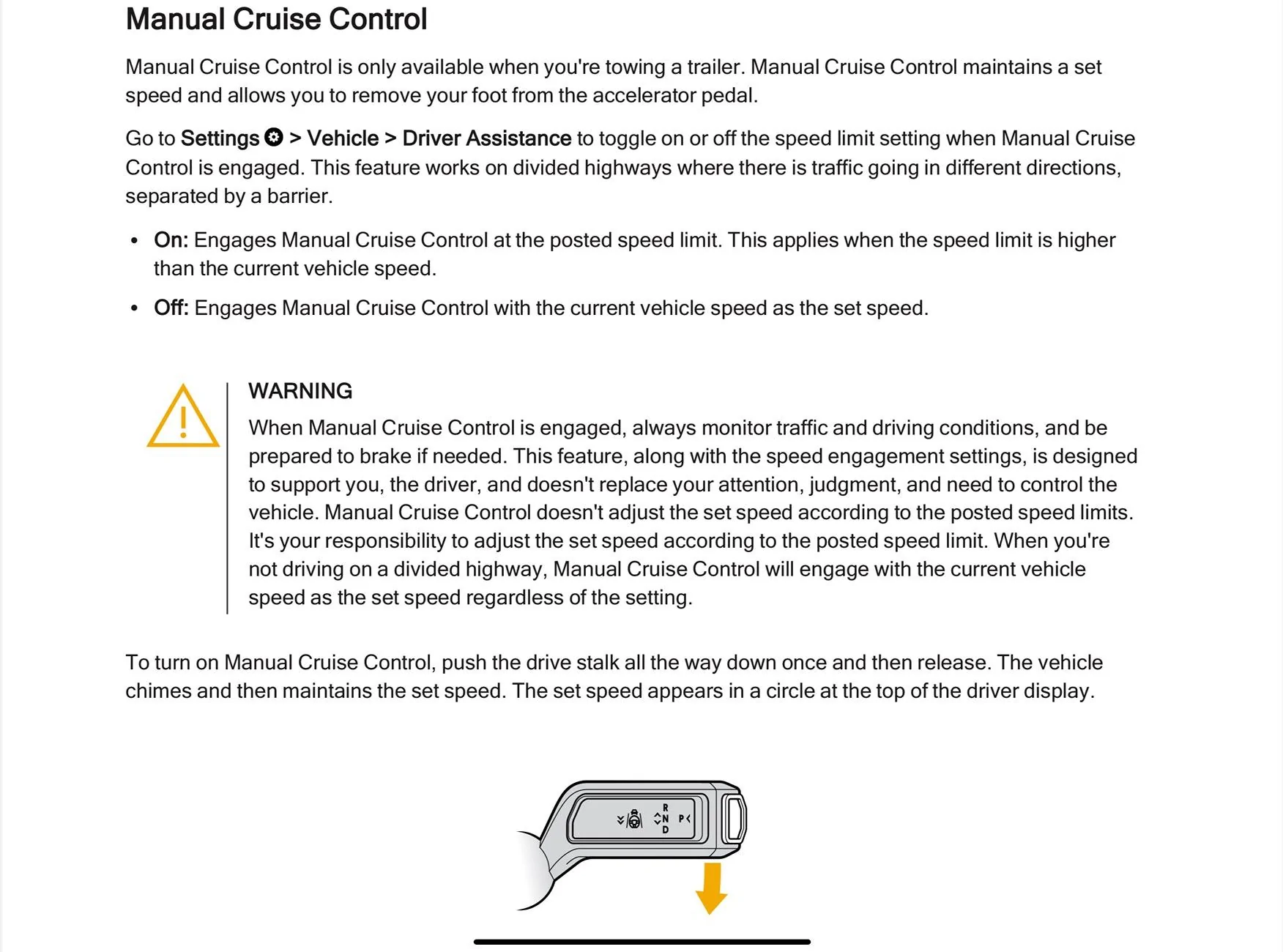

You still have cruise control, just not adaptive cruise control.
That's what I noticed when the truck was getting too close to the car in front of me. Do the radars and cameras stop functioning. I liked my adaptive cruise control on my Mercedes when pulling a trailer.

Dumb/manual cruise works just fine while towing...did a 1000 mile trip with a trailer earlier this month.

Like others said we are unfortunately limited to dumb cruise while towing.
