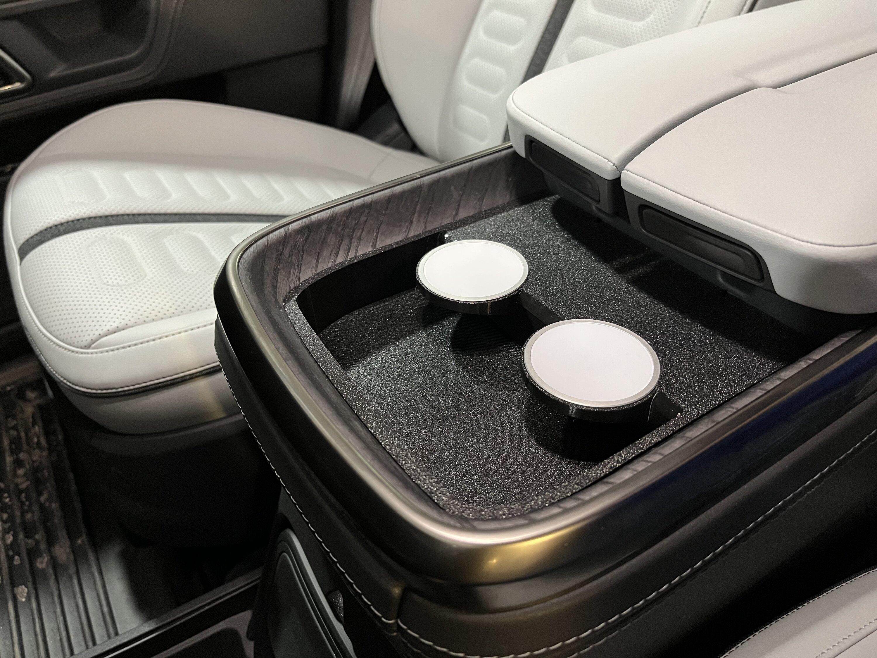

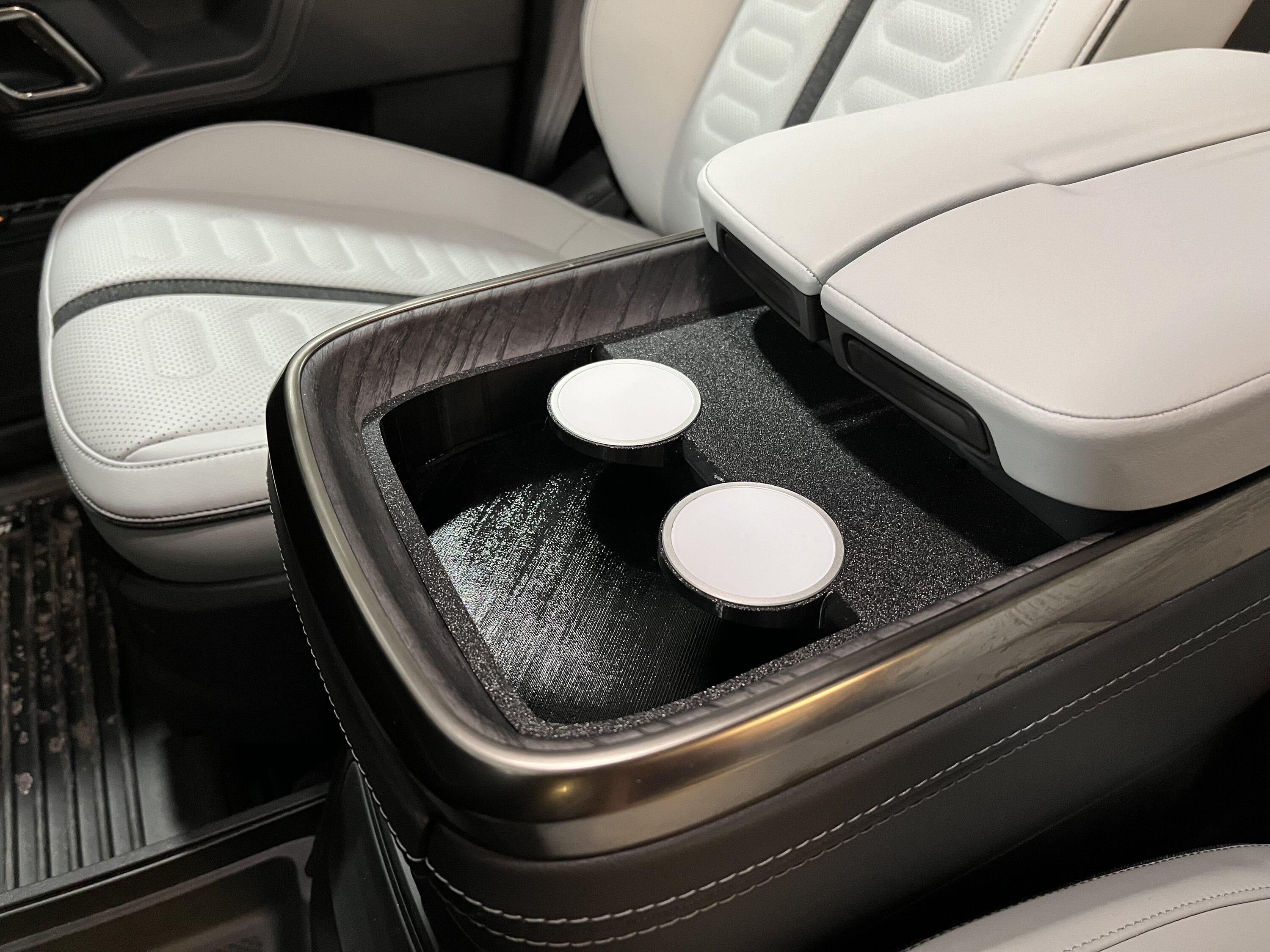

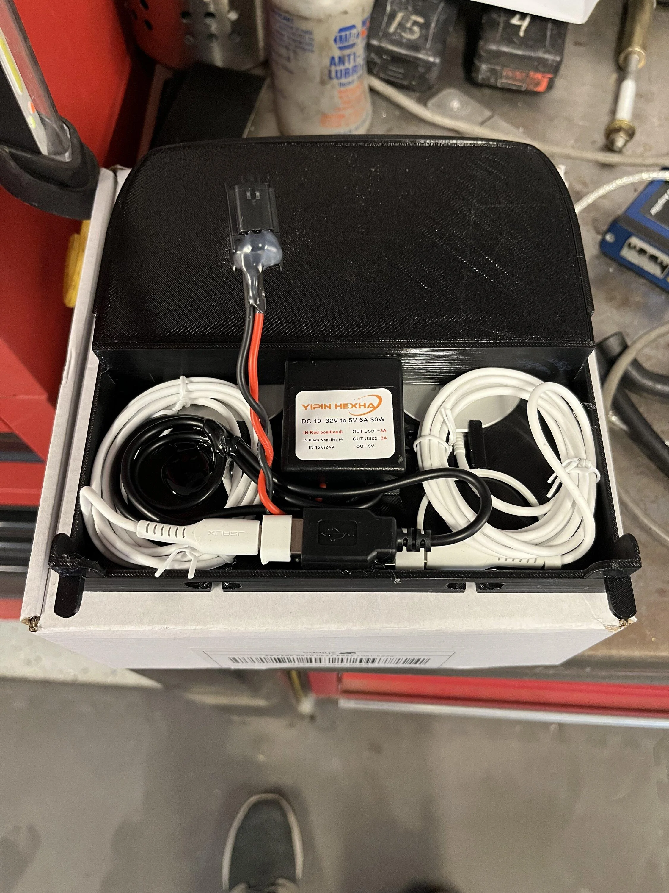

Quick update:
Looky here!
I'm now expecting to start shipping items tomorrow instead of Tuesday the last items arriving look good. It will probably take me a few days to roll through everything though. These will ship in the order the orders were received regardless of where you live or proximity to a service center. :)
There is stock available from this order if you're still looking to get one. I'd suggest ordering soon though. I'm working on a second stocking order, but it's likely to be a bit out.

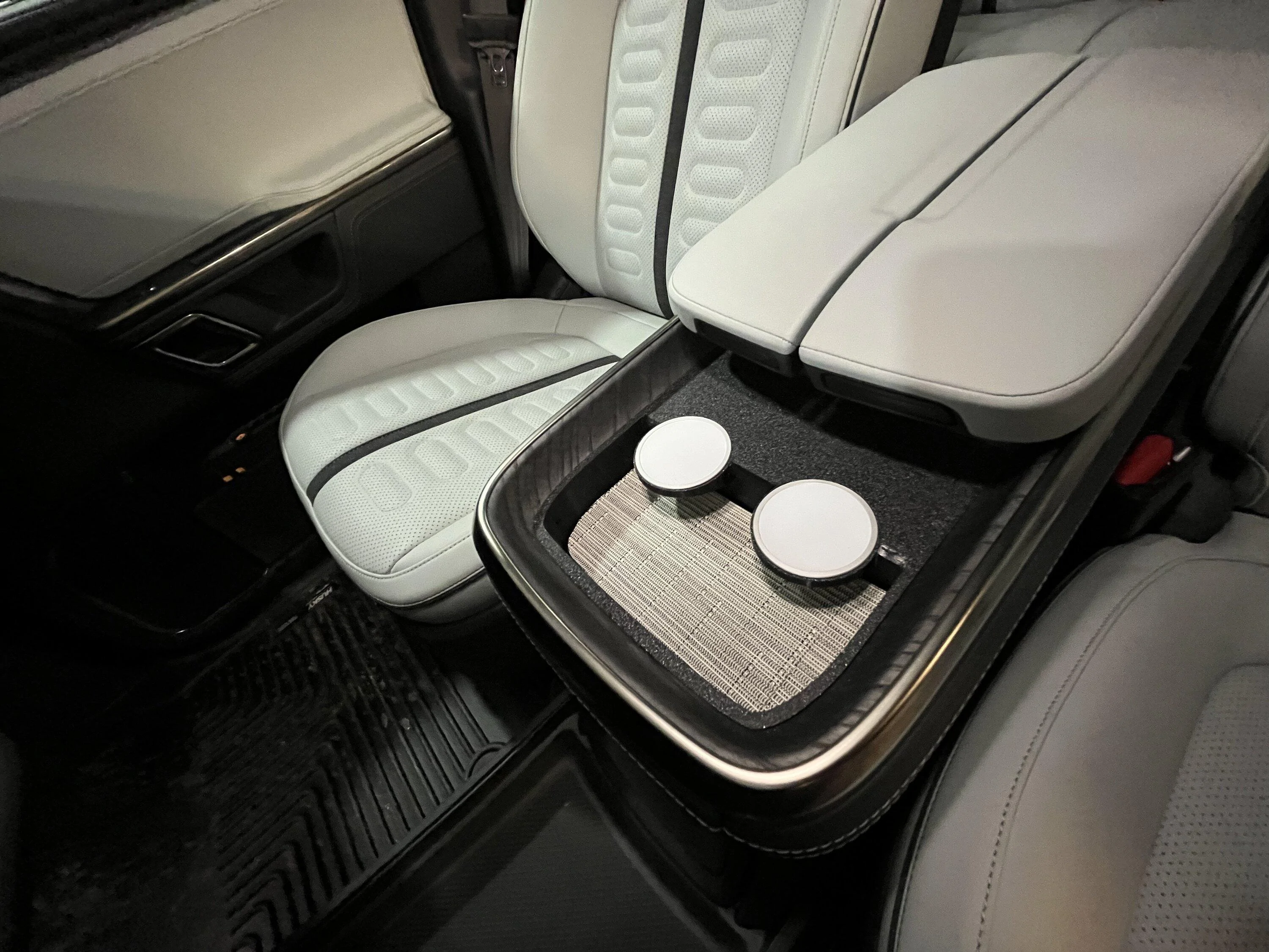

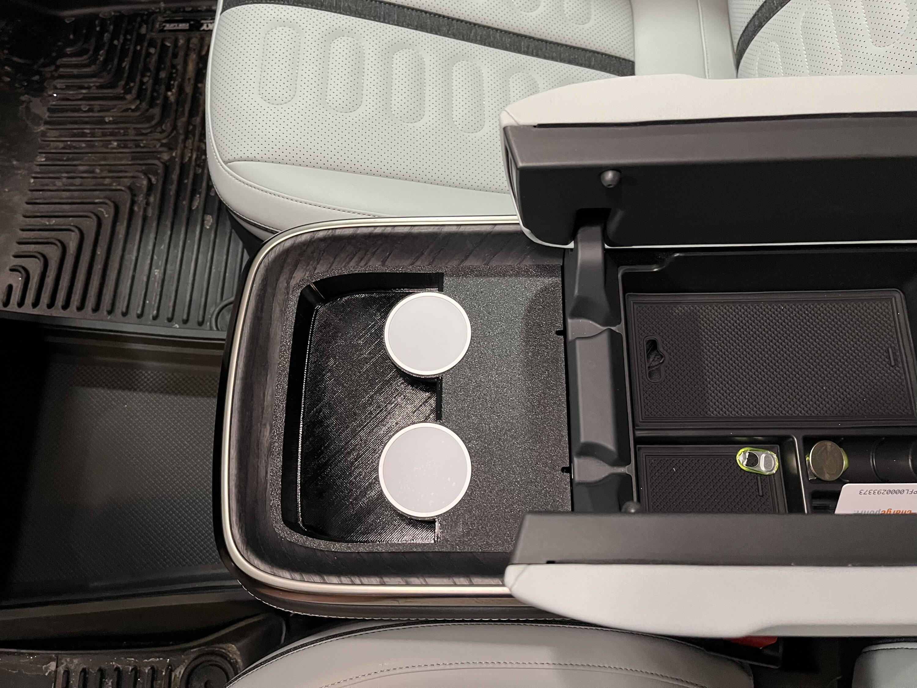

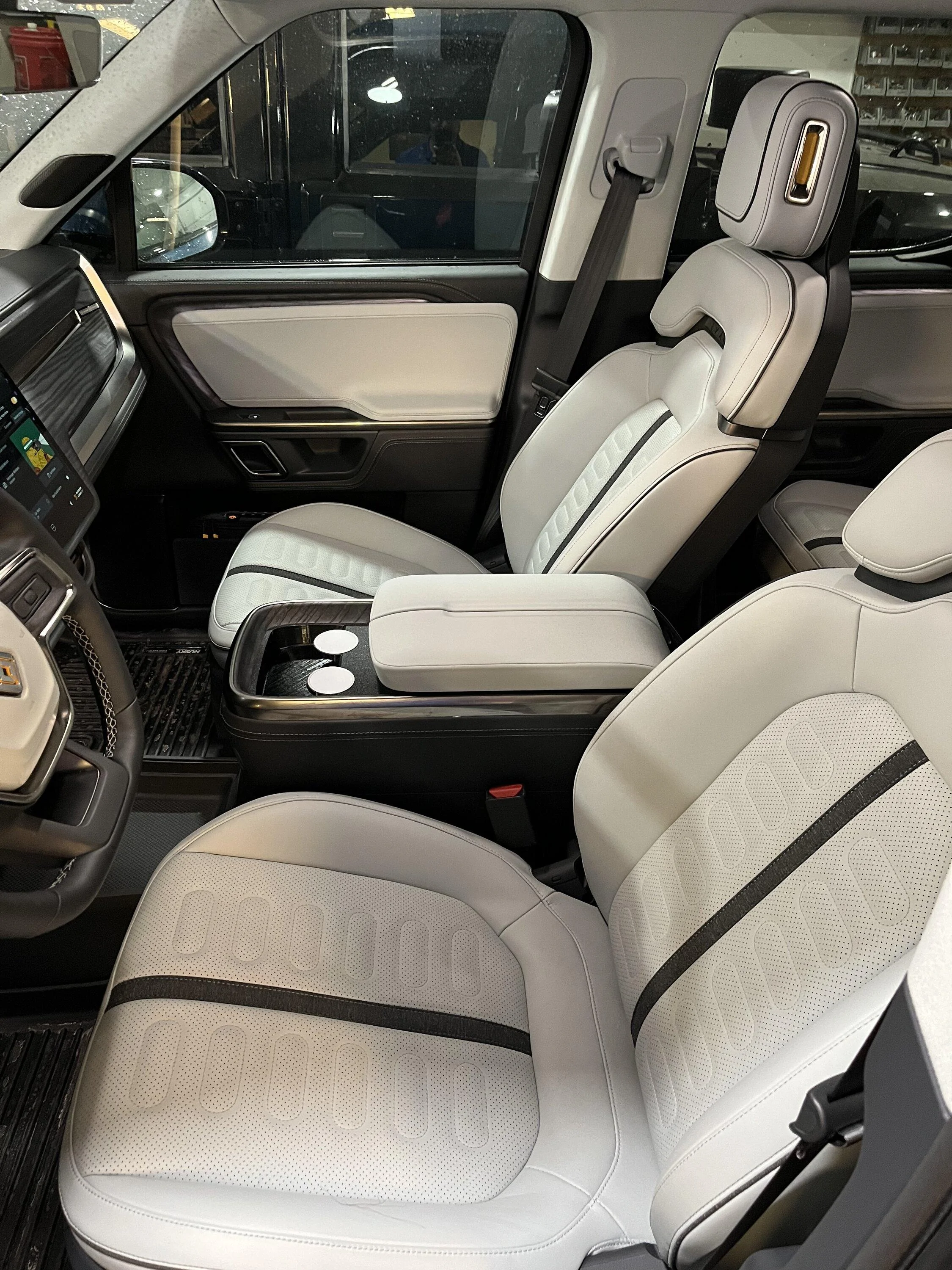

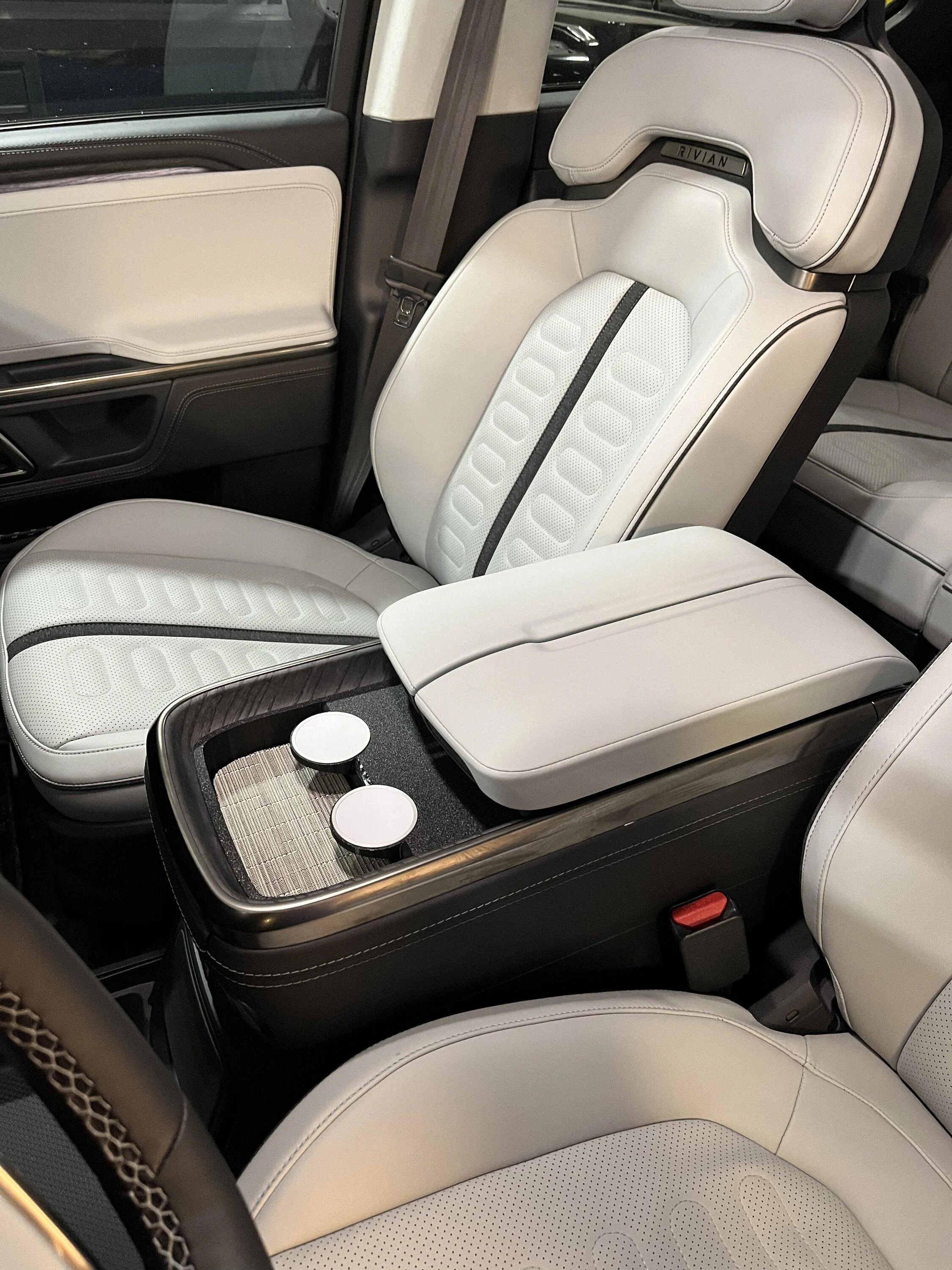

This thing is cool. I wasn’t going to switch the wireless charge pad out because it worked ok for me. This option though I really like keeps the phone from moving around. Also wasn’t a fan of something 3d printed but not that I have it it’s amazing quality I really didn’t know 3d printing has gotten so good.

Also you get the option on the lower Matt for a clean texture finish or with small bored to hold a small amount of liquid. I added some chilliwich that I got a sample of and really dig it.
