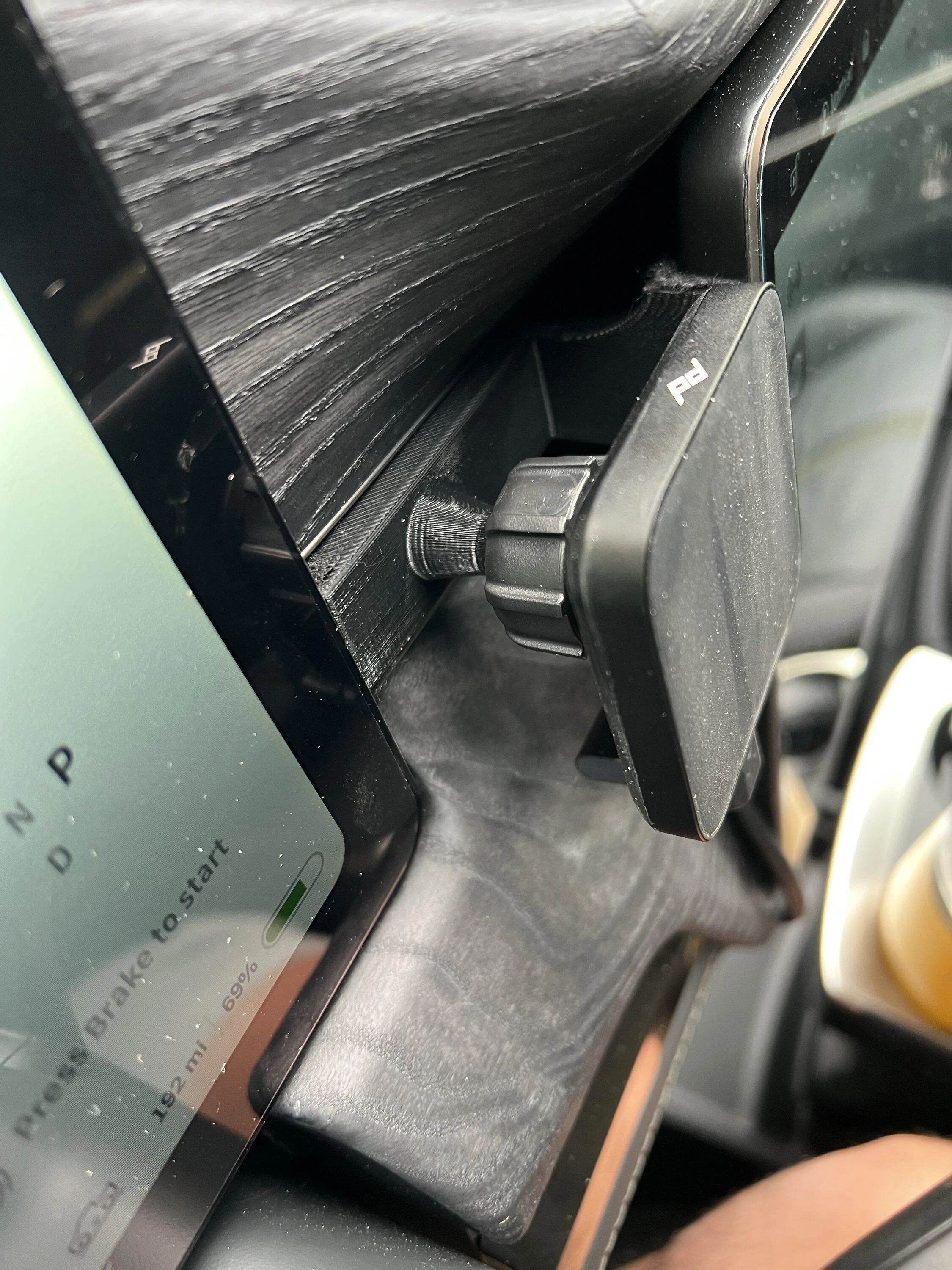

👍 Very happy with this new 17mm Pro version.
Does the peak design charger come with a 17m on the back? How’d you get it attached to the ball on the mount?

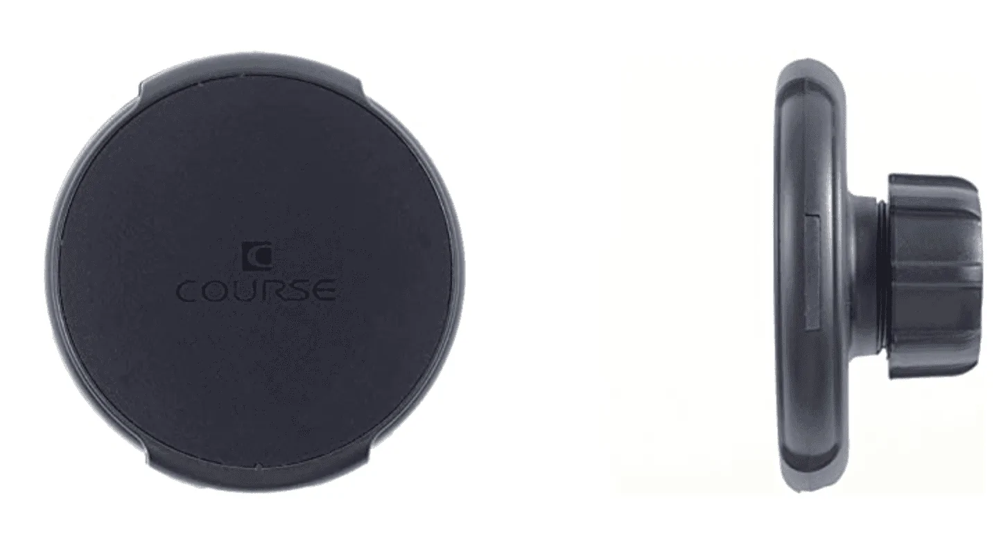

I chopped up a Peak Design charger and a Course Motorsports charger, then mated up the 17mm ball mount with epoxy. Expensive way to charge your phone but it works as intended. With enough people asking Peak Design to make this, maybe they would consider it.
Here's what the Course Motorsports charger looks like. It's made of plastic unlike the PD one. Was easy enough to take apart. I did have to take powertools to the PD charger to get a flat surface on the back. I use a PD case for my phone and really liked the PD charger look as well as the rubber surface.
I'm sure there are other, cheaper mounts that could be chopped up. Just Wireless makes one for example.
Rivian R1T R1S NEW - RIVIPARTS Cell Phone Ball Mount PRO Screen Shot 2022-11-08 at 10.13.51 AM

Ouch that’s an expensive solution
