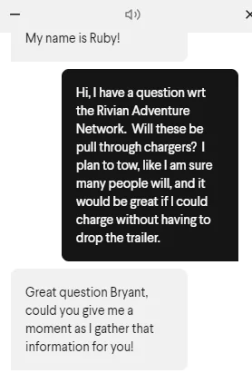

I will be towing a boat when going on camping trips, so I reached out to the Rivian Support team to find out if the Rivian Adventure Network will have pull through charging stations. I noticed that most of the Tesla charging stations require those towing trailers to drop their trailer in order to charge. Below is their response:
It will likely depend on the specific sites they are able to obtain. For example, the site in Salida, CO is planning to have at least one pull-through charger. But this takes up more real estate and may not be possible everywhere. We at least know they are trying to accommodate.
