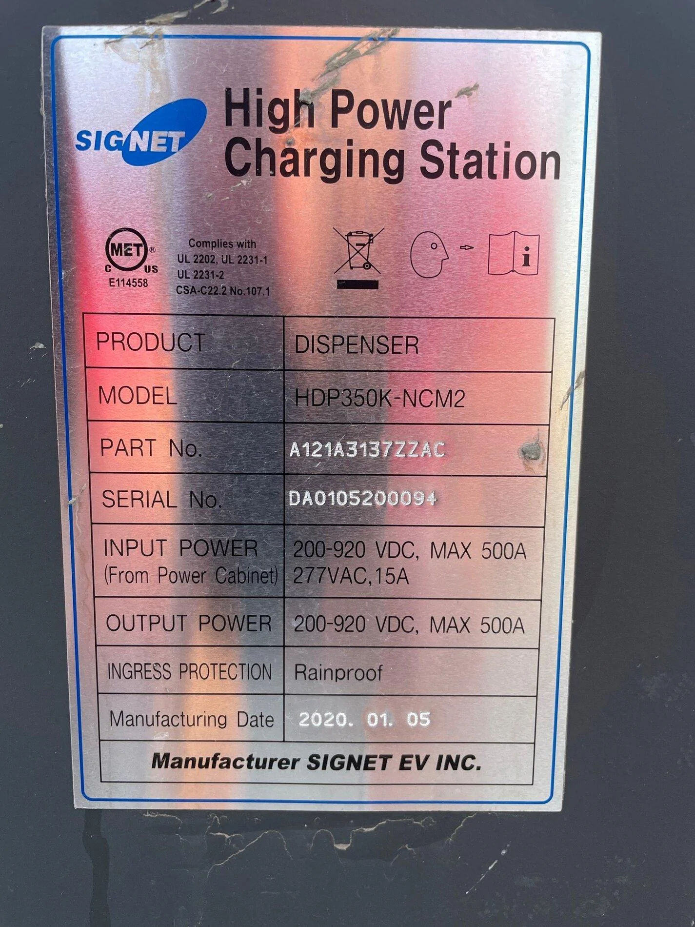

Can you get to 300kw with 480v using any of the available chargers?
Not that I’m aware. I think EA does 350amp max. Tesla does like 525 very briefly. 300kw at 480 would be 625.
azbill
Bill
Jun 8, 2020
1,287
1,579
Arizona
R1T, Mach E, Hummer EV SUT
No you cannot achieve that rate at 480V. You need a minimum of 600V to achieve 300KW, due to the 500A current limit.
FYI, charging at 300KW/800V, will not reduce the current to each cell, it will be more. Take simple example, of having 2 battery cells in parallel, that are say 10V each cell. If I charge at 20W, that is 2A total current. But that 2A is split evenly between the two parallel cells, thus each one sees only 1A of current. Each cell sees 10W of power.
If I reconfigure the 2 cells in series, I now have 20V across the 2. Charging those in series at 30W, that is a current of 1.5A through each cell. That means each cell is seeing 15W of power.
No matter what voltage you use for charging, the total KW power still gets evenly distributed between the total number of cells. The difference in heat is only seen in the single wire going from the charger to the battery, not within the cells themselves.
Mysta
Matt
Jan 30, 2021
482
553
SC
EA does have 500A chargers.
Ah good to know, 350 must be cap at 1000v only, still doesn’t mean 300kw at 480v though.
The EA chargers actually have a limit of 920V. While they can do 500A at some voltages, they are limited to 375A at 920V.
Not all EA chargers are rated to 500A, the picture here is from a Signet unit. ABB units have 400A limit for 350KW chargers and 350A limit for 150KW chargers. There are two other vendors used, but I have not run across those units to have a look at the ratings.
Why is this important to know? If you plug into an ABB charger with a 400A limit, but rated to 350KW, you will only get 160KW when charging at 400V. But if you plug into the newer Signet unit with 500A, then you can get 200KW at 400V. The ABB charger can provide 350KW to a car charging at 900V, since slightly less than 400A is needed. But at 800V, you can only get 320KW with the ABB charger.
