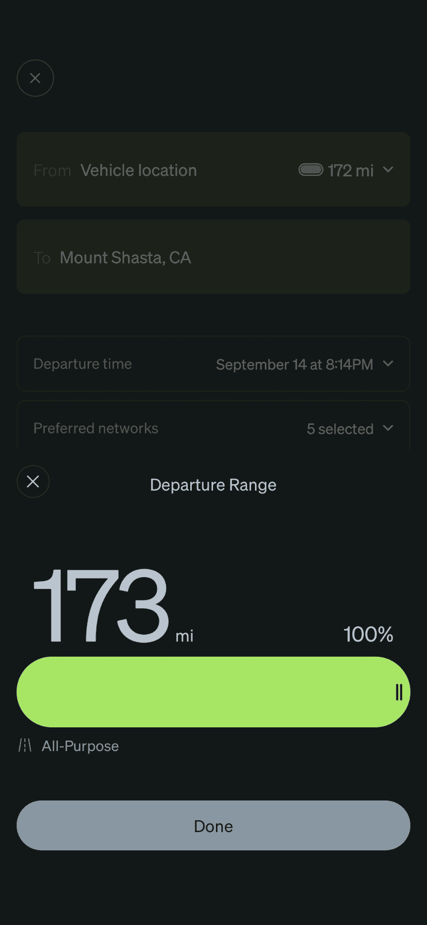

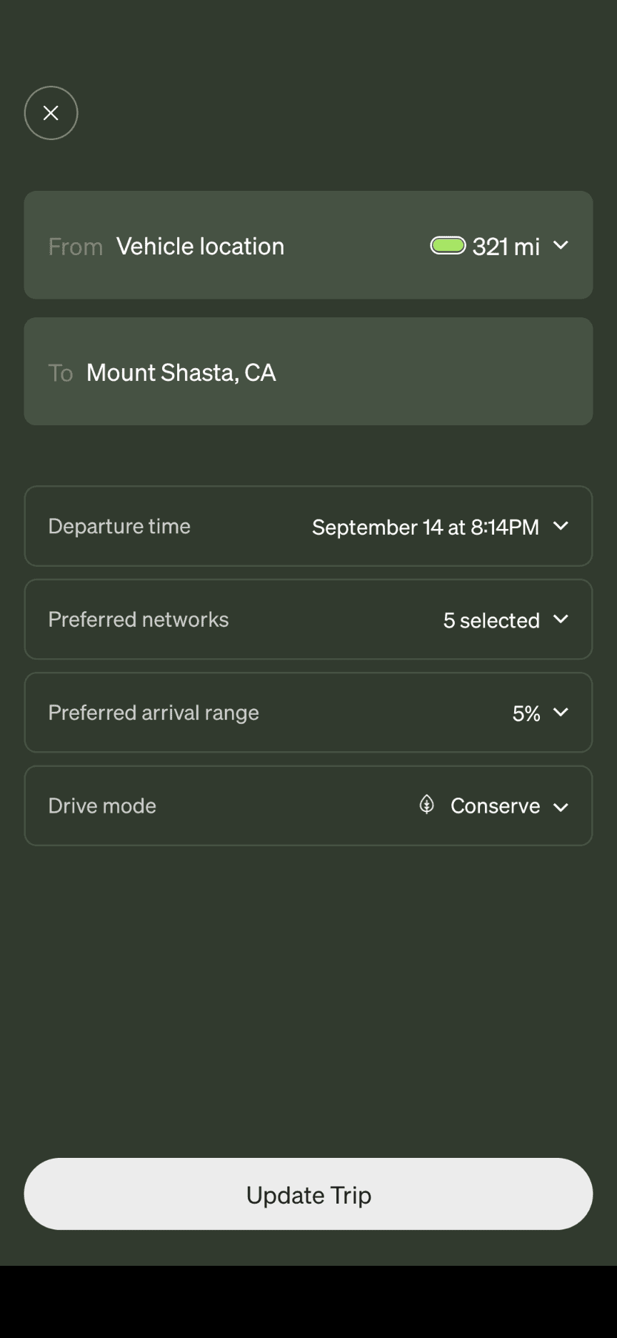

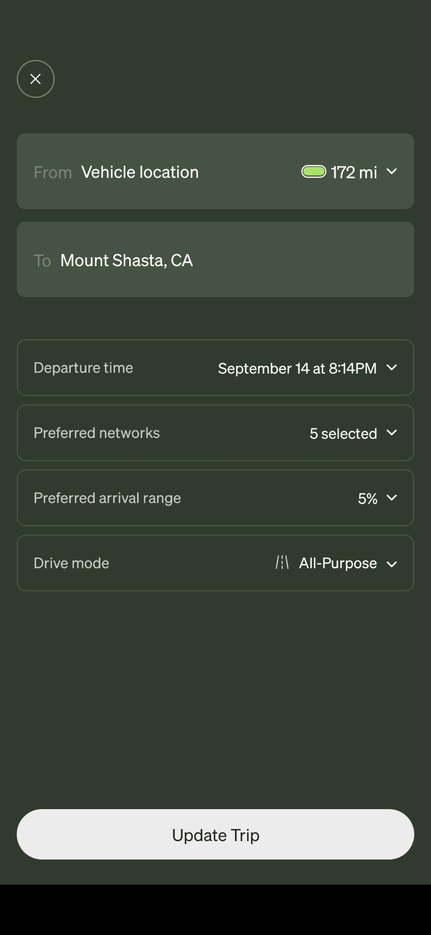

App at 2.2.0 and updated car to .34. I have R1S 22". Set starting charge to 100%, Conserve, app shows 321 miles, which is correct. Change to All-Purpose, range goes down to 172 miles - wrong, should be about 289. Go to starting charge pull-down, and it shows 100% SOC is 172, so it is not an error with the % SOC being changed.
Now exit planning session and go back to main planning map. You cannot choose a new plan. Tapping on Plan does nothing. You have to go back to car info, then back to Plan.

When you change drive modes, it resets to read your current % but must not be displaying it. Swipe it a little and it'll update.
