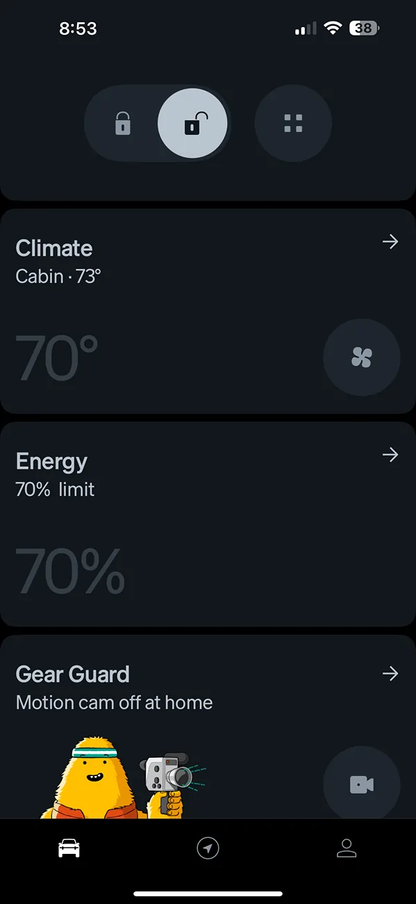

In your phone app use the following screens. Keep in mind this is iOS so if you have android it might look different.
Rivian R1T R1S New Guy Range Issues - need some help IMG_0427
This is the main screen, from here you click the climate section which opens the following screen.

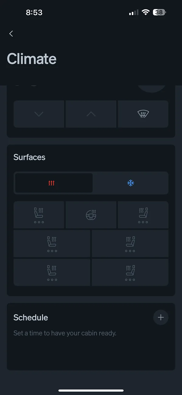

Click the tab that says schedule to set your schedule. That opens the following screen.
Rivian R1T R1S New Guy Range Issues - need some help IMG_0429

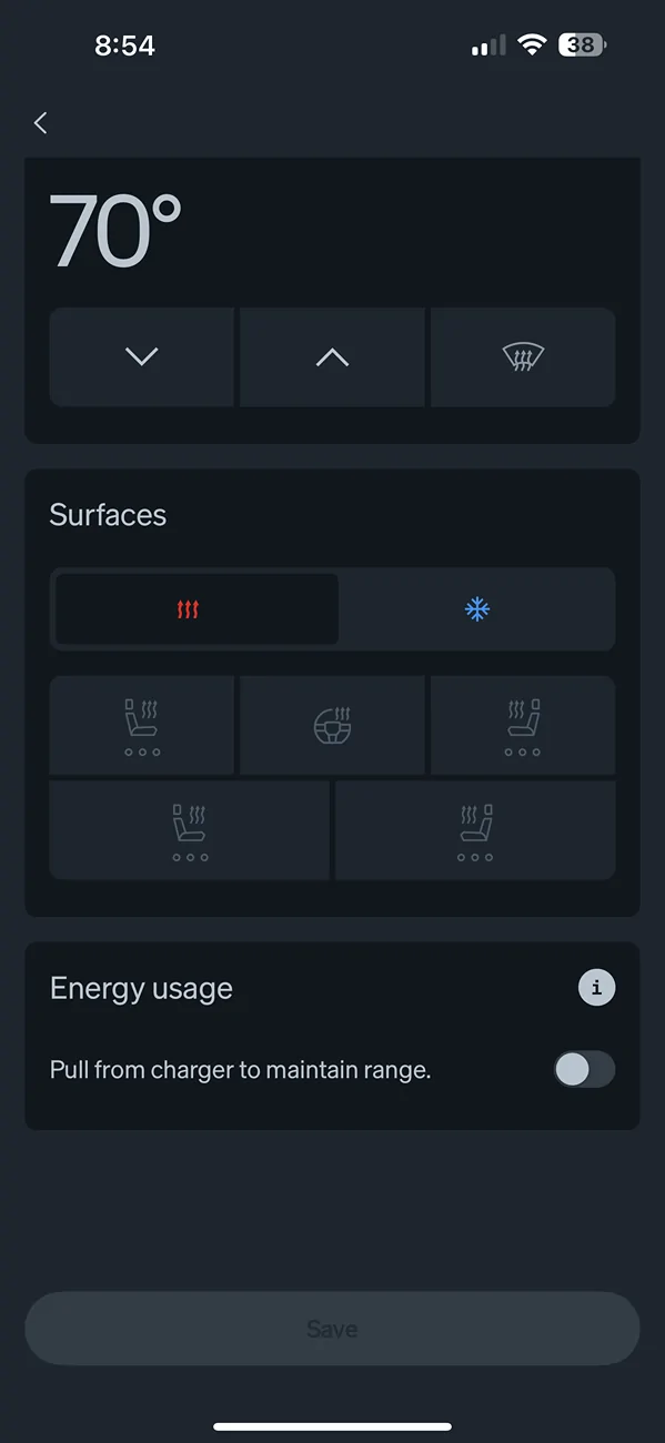

Scroll all the way to the bottom after setting your schedule, this would be your departure time, and check the slider that says pull from charger to maintain range. This will tell the software to have the car warm for you at a set time, including the battery and to use the charger power instead of the battery to do so. Using this you will have a warm car, warm battery and at your desired state of charge when you're ready to leave.
