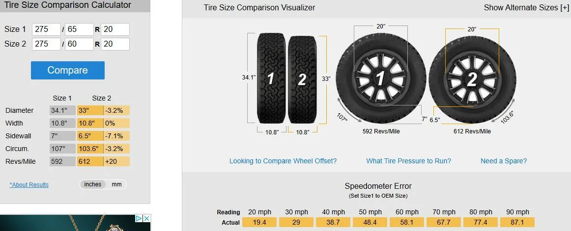

I don’t get it, 21” to 20”? Rivian offers two 20” size tires
AT 275/65/20 34.1” diameter
AS 275/60/20 33” diameter
Did they program it to All Terain or All Season?

Yeah if they did the change to the Gen 2 size 275/60/20 AS Goodyear tire then that’s great to hear. But if they did it to the 275/65/20 AT size then they did you wrong. Let us know thanks.
Spoke with a couple of people in service and they confirmed that the Gen 2 size 275/60/20 AS Goodyear tire is the ideal setting but isn't available at this time for Gen 1 vehicles (think B Digs has gotten the same response) and that the 'closest' setting for now would be 275/65/20 AT (and that is what my software is set to). They indicated that the change wasn't necessary and either setting would be fine (and not hurt the vehicle) but they currently set it to the 275/65/20 AT until they can update the Gen 1 software settings (not sure when that will happen).

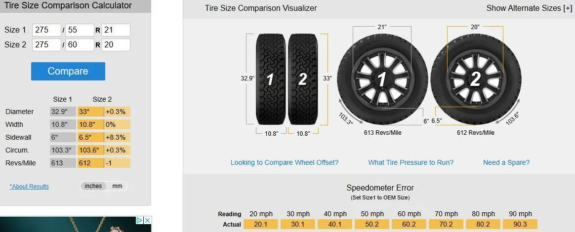

If you were coming from the 21" wheels, they should have left the software unchanged as the diameters are nearly identical...
Rivian R1T R1S New Goodyear 20” tire option - available when? 1731346925091-rh
Here is the difference now that they have updated the software.
Rivian R1T R1S New Goodyear 20” tire option - available when? 1731346837487-kz
Hopefully Rivian will eventually allow the software to be updated to the new size.

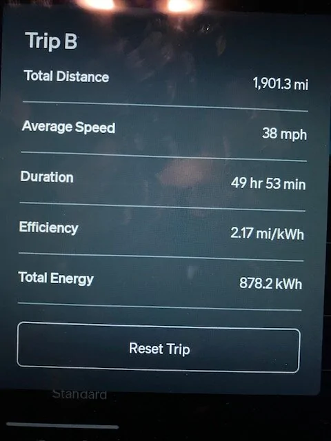

Posting results after waiting ~1500 miles. I drove 360 miles on Sunday and averaged 2.24. On the same drive ~3 months earlier (albeit in warmer conditions) on 21s, my average as 2.44. I think that's pretty decent. Honestly, I didn't expect much better than this.
