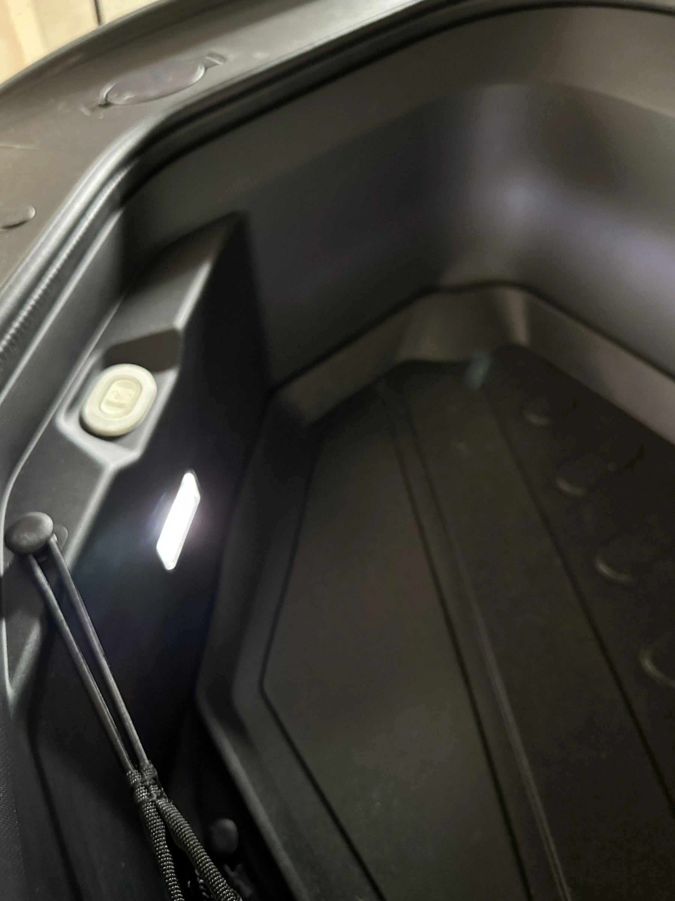

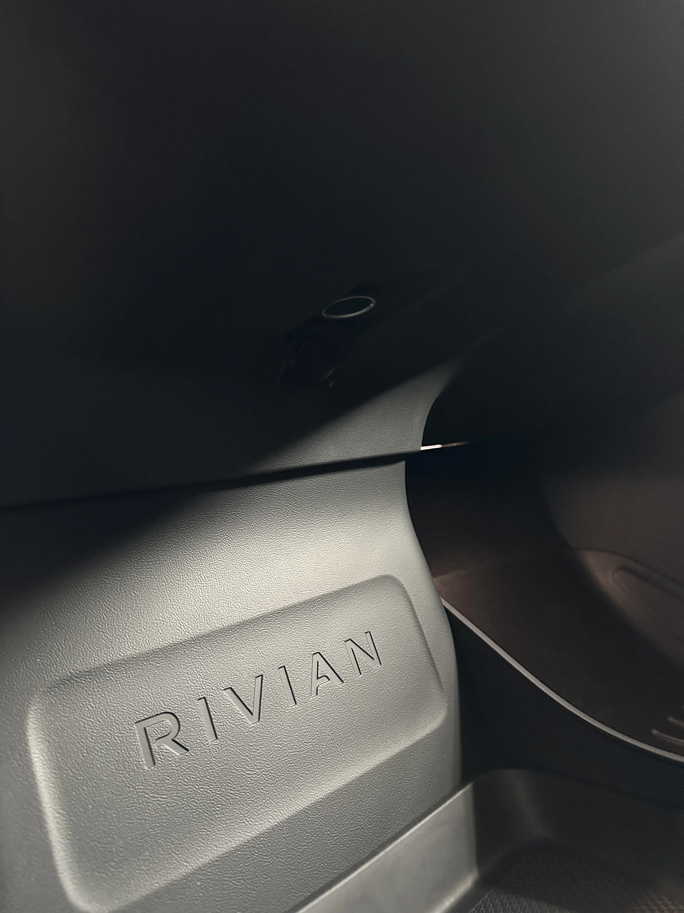

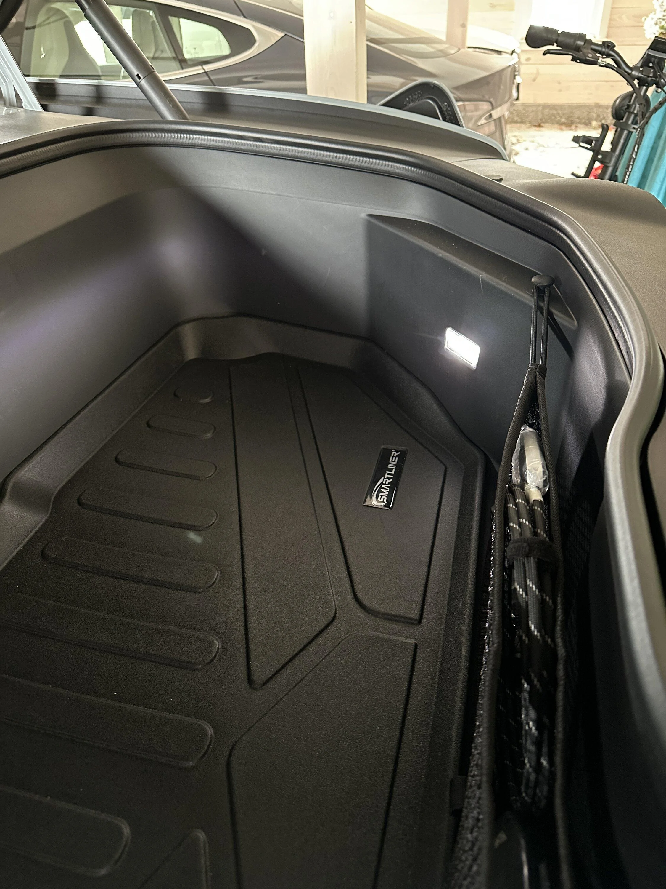

I was hopeful on the 12V in the frunk for the same reasons but alas nothing there. I'd guess someone will do an aftermarket charge mod at some point.
I did OptiCoat Pro Plus, whole car (which is pretty standard). No PPF. I did the same for my Teslas when I got them and it holds up well and i'm ok with a few rock dings every once in a while.
Some pics of the 12V under the screen and frunk with no power outlet

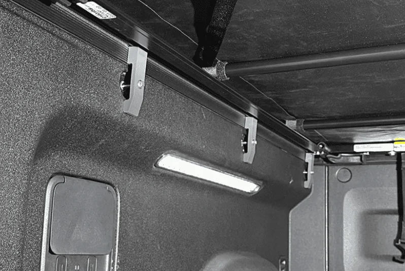

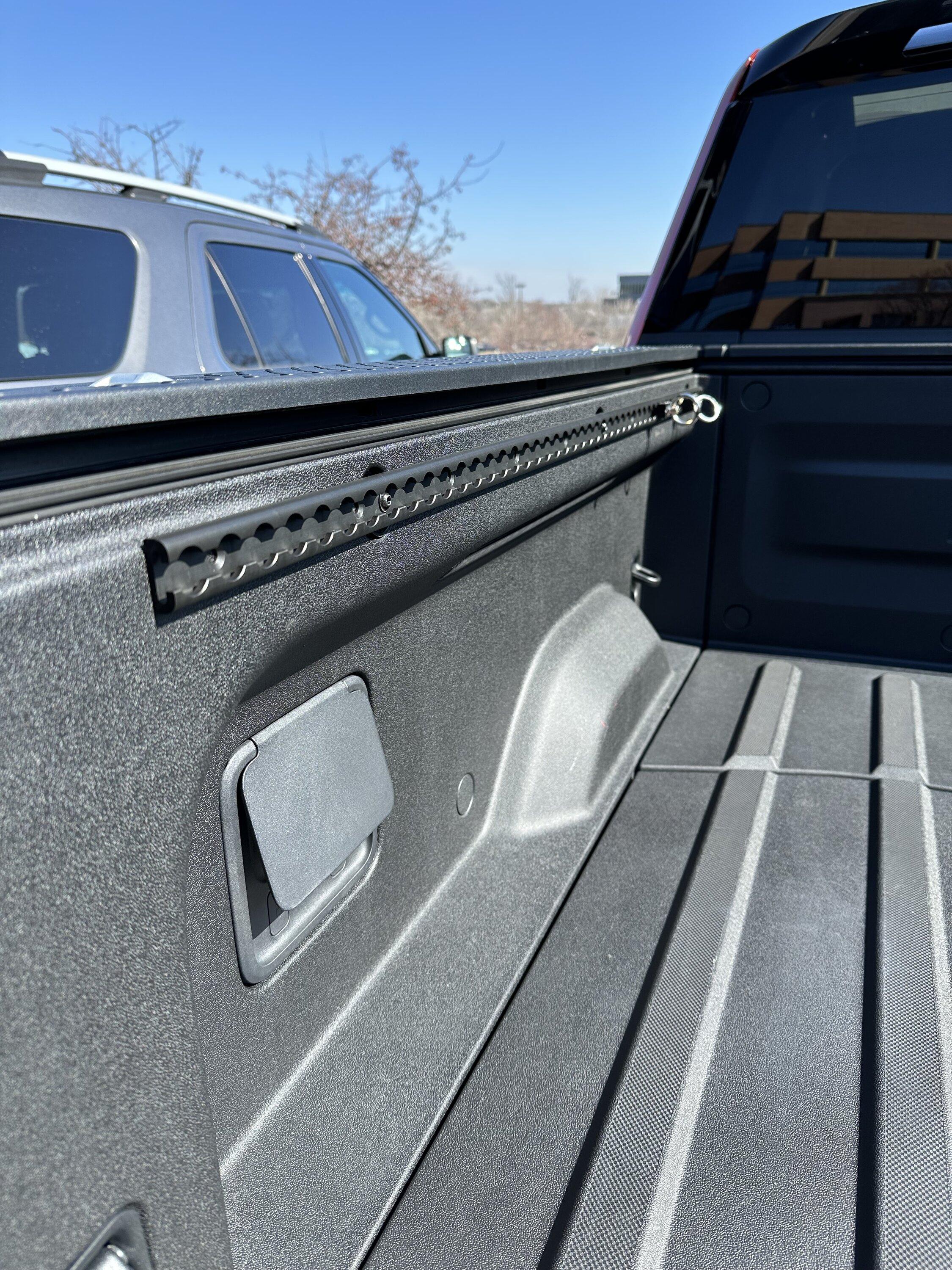

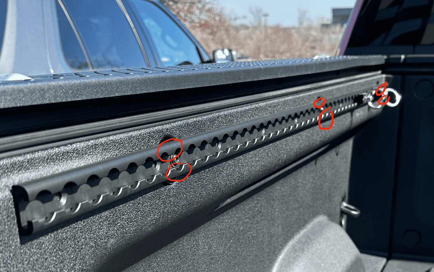

I installed L-track for tie-downs using the 3 mounting bolt locations on both sides of the bed based on another thread in here. (first pic) The tonneau cover uses those same points per mounting, and customer service said it would not be compatible. However from the tonneau pictures shown here from their website (2nd pic) it looks like the aluminum standoffs could allow a 1-1/8" x 1/2" L-track through the openings perhaps with some washers to shim if needed? Can anyone confirm the clearance?

the rail will mess up the angle the clamp connects with the side rail - that cant be angled. Youd have to cut down the rail around the 3 points, and grind off the matching thickness of the base plate, so the geometry of the clamp is right. It's doable, but fabrication necessary;

Alas, no frunk outlet. Though I do have one under the center screen along with the meridian speakers.

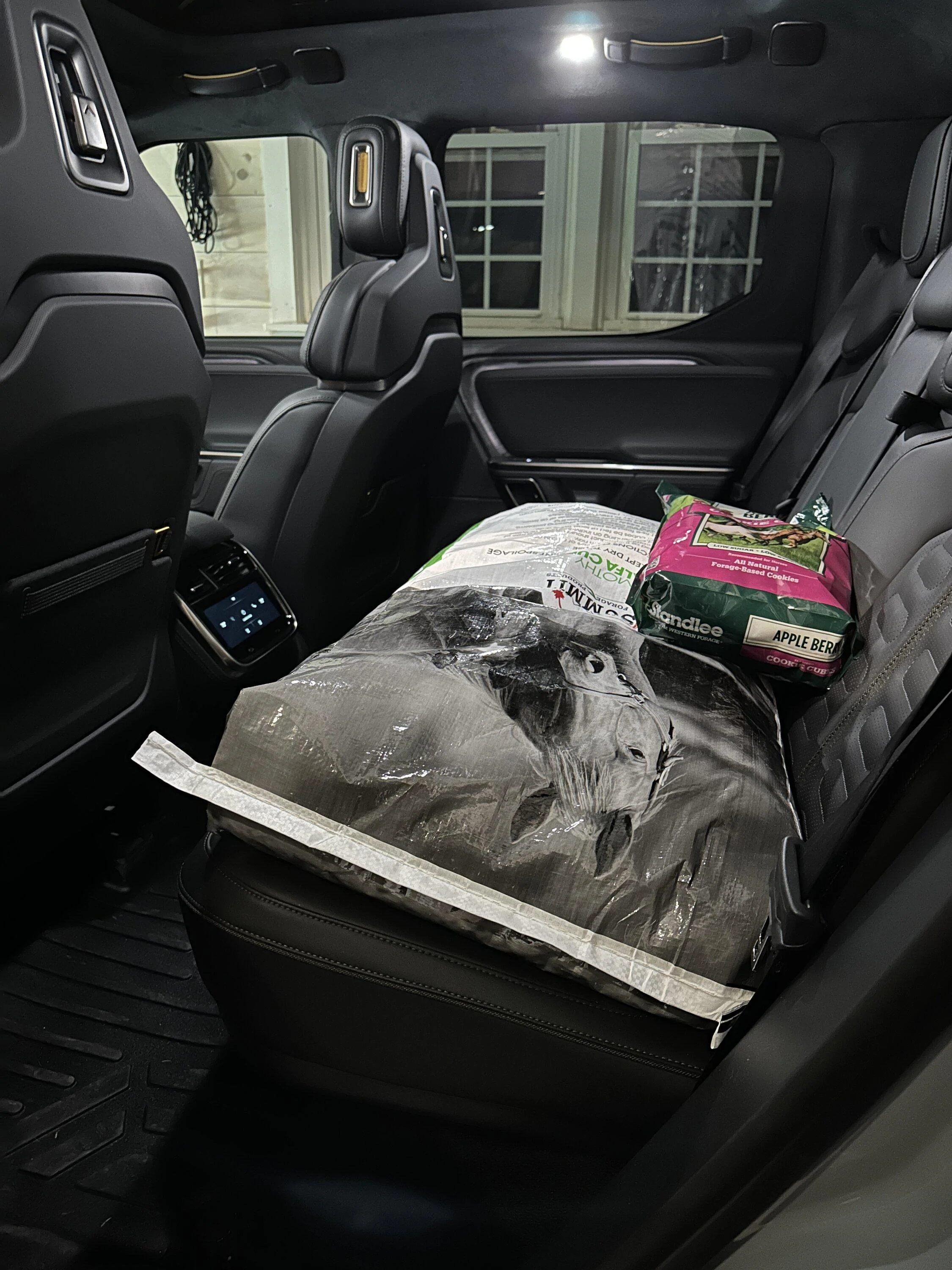

Moving the grain inside the cab when its wet until the cover comes in.
