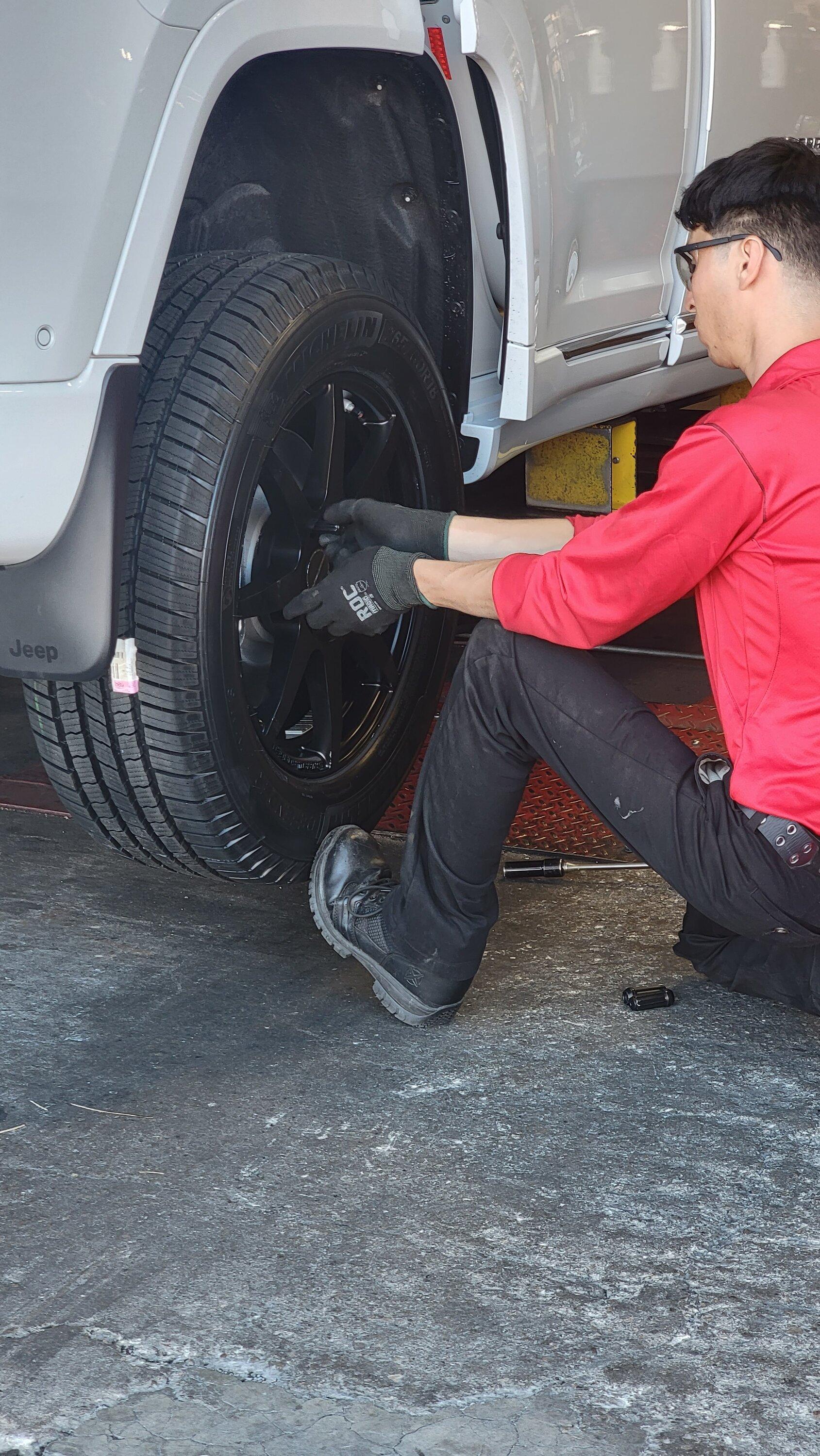

Is it an EV tire with low rolling resistance and sound deadening foam?
The ones I have o. My 2023 Jeep Grand Cherokee Summit Reserve 4xe are low rolling resistance but no foam. Not sure about the new 275/55-21.

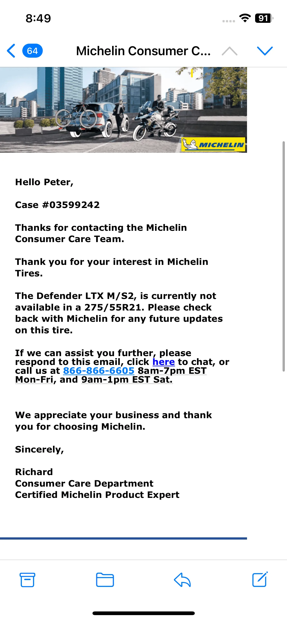

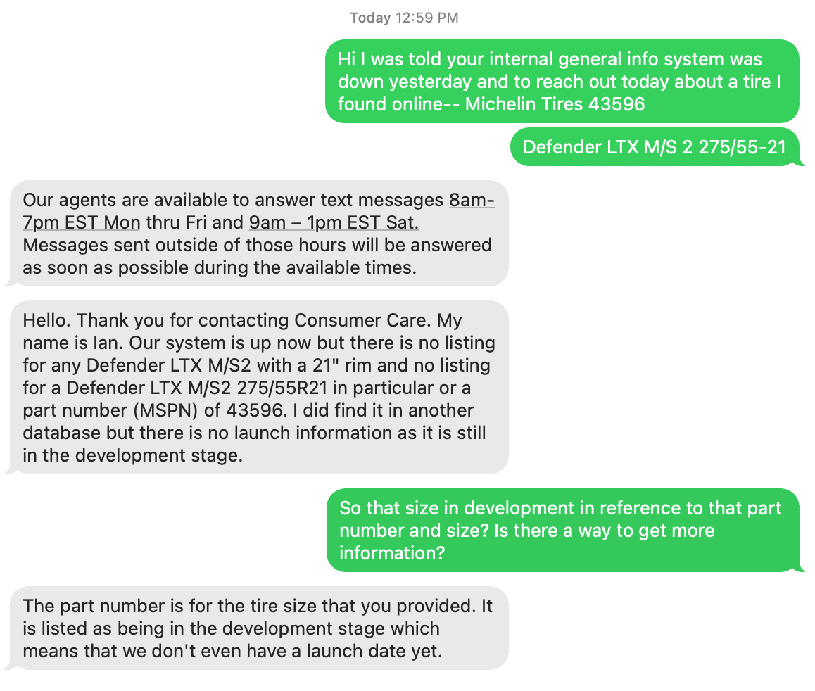

The Michelin Defender LTX M/S 2 275/55-21 is apparently a chimera, at least for the time being. This may be a naive question, but why isn't the 275/50R21 an acceptable alternative?
The OEM is 32.8" compared 31.8".
So you would have 1" less of height. The price difference is 50$ less. So not really a huge cost savings.
The real question is will the tread wear be less? That would be a question for someone riding the defenders on the 20"s

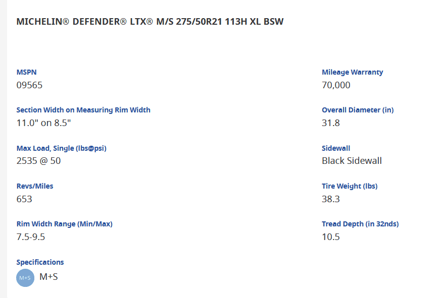

Another naive question: What is the real, effective impact of the lower height of the smaller tire? I understand that it may throw off some of the vehicle's readouts, perhaps no small thing, but other than that, what? Range? To what extent?
Regarding 20" tires. there was a recent thread about someone replacing their PIrelli AT's with the Michelin AS and getting great range. Nothing yet about treadwear; guess that will come in time. Interestingly, there were several posts about tire retailers unwillingness to mount the Michelins on the Rivian, with several, including Costco, declining to do so. Wasn't clear what the issue regarding mounting was. Possibly load index?

According to the summit link posted above (https://www.summitracing.com/parts/mhl-09565#overview) the 275/50-21 have a lower load index at 113 compared to the stock Pirellis at 116. Thats about 220lbs difference per tire. Is that enough? I dont really know anything about tires.
