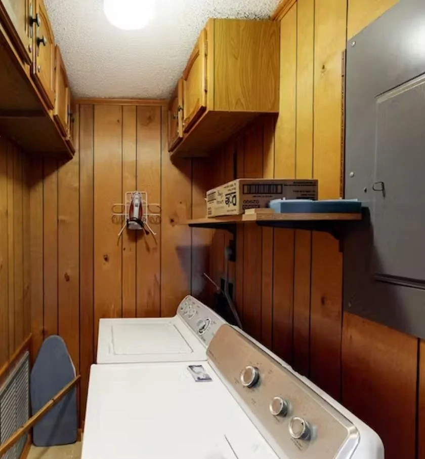

Need help identifying plug

I am going to an airbnb and need to adapt from this plug to charge. What are our best guesses as a community? I'll buy and take a couple if needed

Do many dryers run in on 50 amp outlets?

Most dryers are 30A and typically they use a 6-30. But from that picture you cannot really tell, you need to see the prongs.

Well since the panel is right there...
A screwdriver and 6 gauge Romex.
Most dryers of that age are on a 14-30, pretty standard still even.

14-30 or 10-30 my guess
This is the correct answer. The majority of electric clothes dryers are 30 amps, not 50. Also not likely a 6-30, those are typically used commercially or for HVAC equipment. As a guess, >90% of electric clothes dryers will be 10-30 if older or 14-30 if more recent.

This is the correct answer. All the options mentioning 50 amps are likely wrong; there are not really any 50 amp clothes dryers.
I agree. The dryer standard was 30 amp on a 10-30 plug (3 prong) until 1998 or so then it became 14-30 (4 prong). You can still buy cords for both standards for new dryers because the new outlet style isn't required unless new construction or modifying an existing construction like adding an addition or something.
If you look up the house in Zillow and see when it was built you can get a good idea. Since the wood paneling seems older I'm guessing this is an older home and has 10-30. If you carry both you are pretty set for anything you will encounter in a home
This answer is why i asked my question here.
