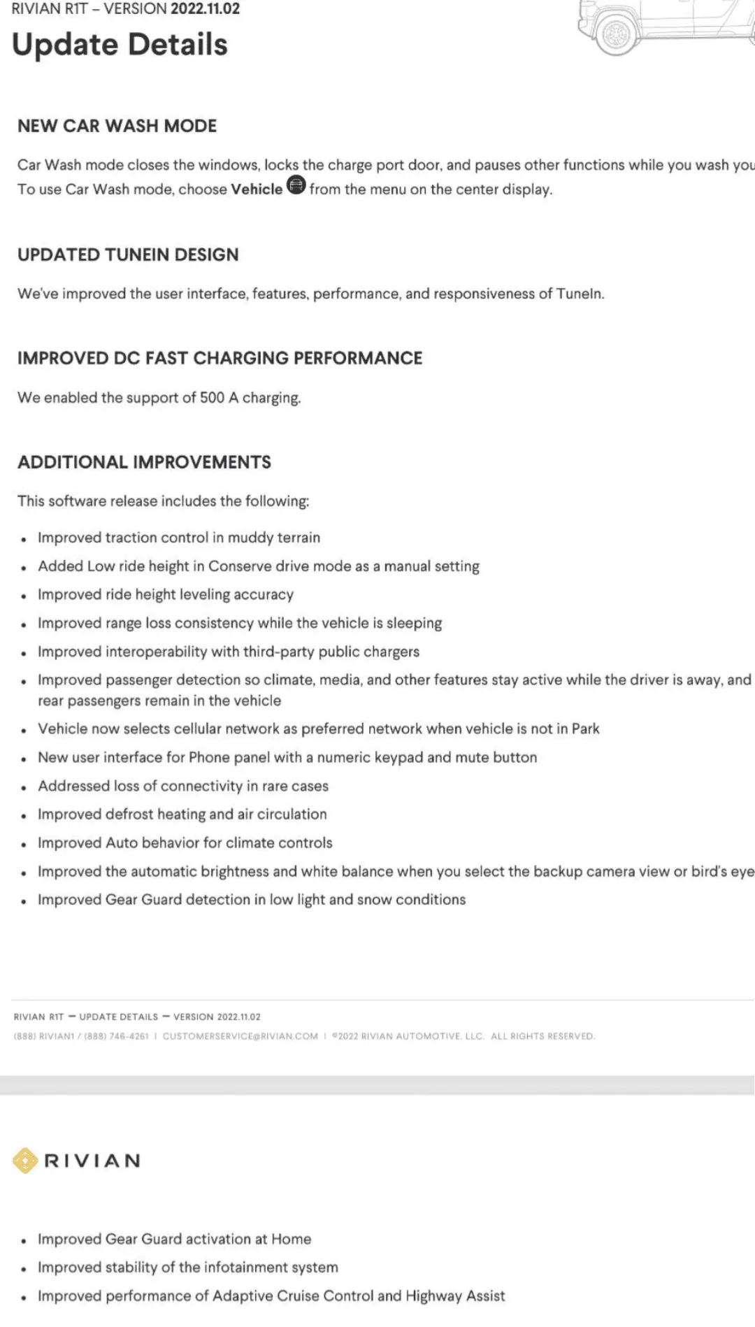

Car wash mode is coming on next OTA update - it’s apparently only been released to employees’ vehicles at this time. Someone on Reddit posted the change log of everything in the update, but that post was deleted quickly.
