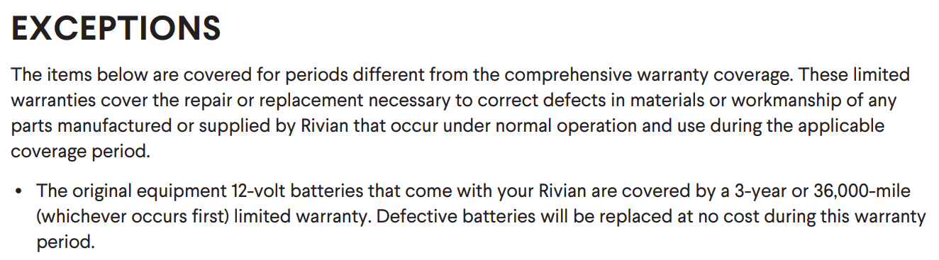

the battery pack is covered under warranty, but I guess not the 12v?
Absolutely should be under the bumper to bumper warranty. Before handing them my card I would have forced them to show me exactly where in the warranty documents it states the vampire drain and lack of 12v being covered.
These stories frustrate me. Especially as new company, Rivian service centers should be bending over backwards to make customers happy and give them the benefit of the doubt when it comes to these issues. Is Rivian really that hard up for cash? My buddy ran something over in his Tesla and ripped his underbody covering off and they replaced it for free. I've had Chevrolet dealers give better service than what's being described here.
Edit... the Warranty Guide says the batteries are covered for 3yr/36k.
