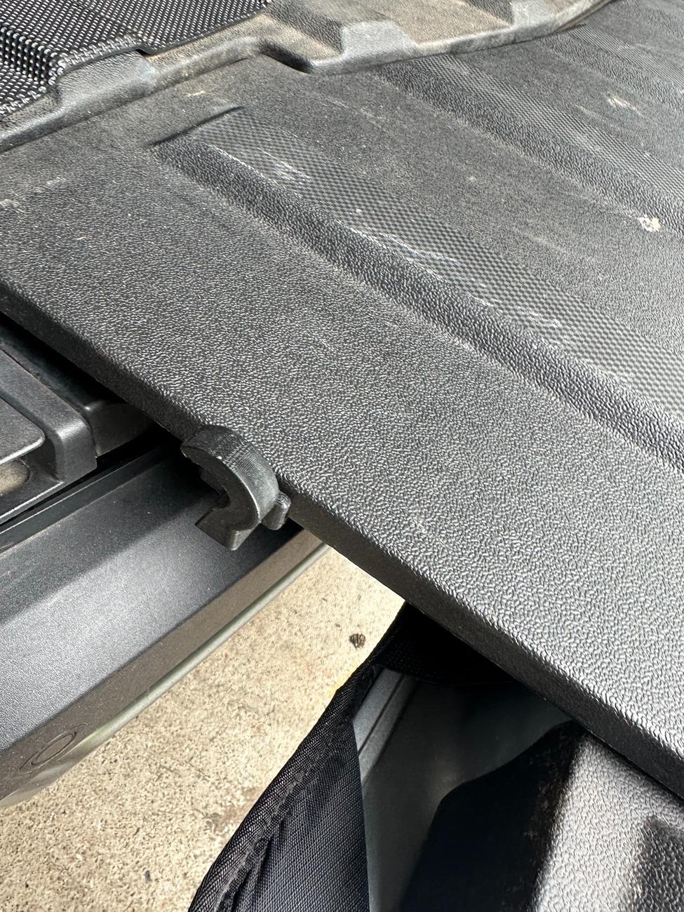

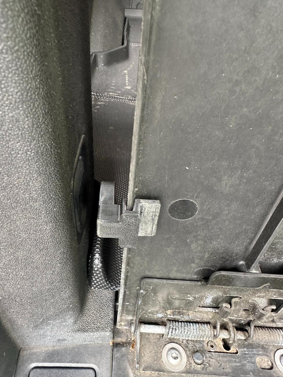

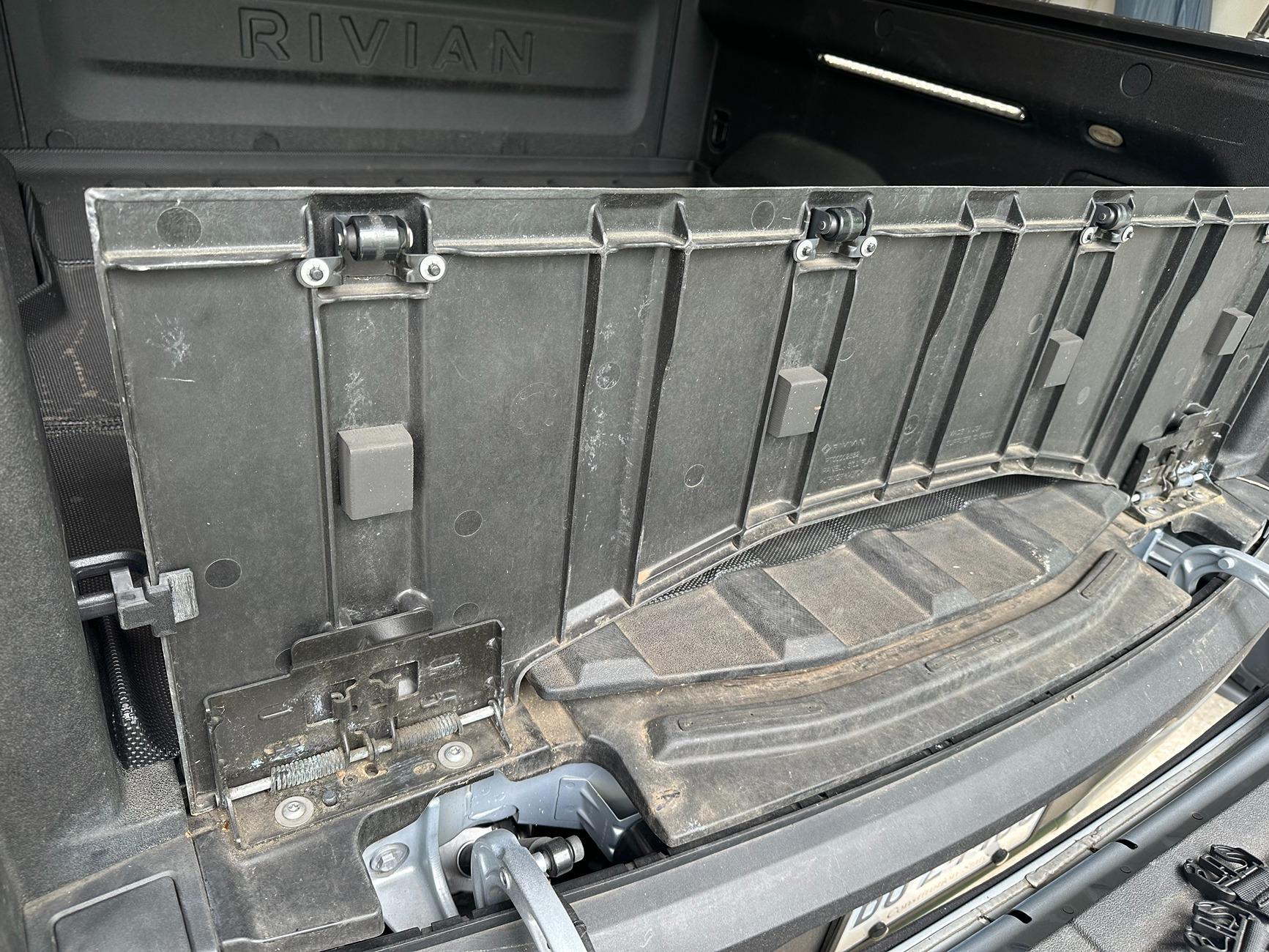

I install and remove the tailgate pad for carrying bikes frequently, and got sick of holding up the spring loaded flap with my head to install it, so designed and 3d printed a "kickstand" that uses the cargo loops as a latch to hold it up while I install/remove the pad.
Sharing in case anyone else only has two hands and is sick of using their head as a kickstand.

Because you have to feed the straps between the flap and the tailgate.
I just drop the middle straps through, lift the gate, snap them and tighten them. The outside straps don't require the flap to be moved much because they are on the edge of the gate.
I haven't had trouble with the flap but I do think it would be easier if it were out of the way.

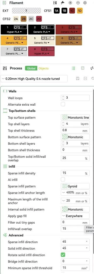

There are very strong options, and "strong" means a lot of different things. The most basic plastic is PLA, which is hard, but brittle, and not UV stable, or heat stable. There are many others. For durable car parts I like nylon-carbon fiber, which is super solid yet resilient and machinable if needed. For general car parts parts I like PETG, others prefer ASA. Both are strong mechanically, heat resistant, UV stable. Many of my shop parts are also PETG. Household things vary, depending on use.
You can also decide on wall number, wall thickness, infill percentage and type, and so much more which affect strength.
This is maybe 20% of the settings possible.
