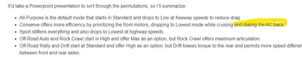

1. Tried to use Conserve mode on the highways. Driving experience is fine. But A/C isn't great in Conserve mode. It was sunny to partly cloudy, outdoor temps in the low 80's. The R1T A/C in conserve driving mode just didn't keep up in these moderate conditions, not bad, but the cab stayed around 75. A/C works fine in all purpose mode, if you put the system into recirculate, but a little worried about how it will hold up on high humidity summer days in South Carolina in conserve mode or even in Auto mode (not recirc'ing the A/C). Hope my A/C is ok. Have others had a similar experience?

I don't think conserve mode has anything to do with limited climate control use, etc. its just disconnecting the rear motors. I could be wrong, but haven't read anything about that.
Maybe I need to compare with and without the recirc again in conserve. My wife and I were troubleshooting while driving, found this reference, so we switched to all purpose mode. This website mentions
https://www.autoblog.com/2021/09/28/2022-rivian-r1t-first-drive/
I do know that other ev's have a decreased level of a/c when in conserve or eco mode. Like you, I have not read about this in the Rivian, but I wouldn't be surprised if that was a part of the conserve algorithm
