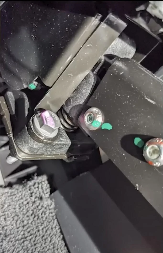

Hello All.
I have been hesitant to post this story / incident in the forum as I'm not necessarily wanting to stir the negativity pot. Overall, I (like so many) have been largely satisfied and, frankly, impressed with my truck (after 3 weeks).
One week after delivery, I was stepping out of my truck at my office (very grateful that I was in my office parking lot and not on the road) and my toe (I wear a size 14 shoe) caught behind the accelerator pedal. This is NOT uncommon for me --depending on the shoes I'm wearing. My big toe (sole of my shoe) caught just the bottom corner of the pedal and, as I tried to step out, I felt it snag it -- but not with very much force or resistance. With just slight additional force, I pulled my right leg out and felt something give. I thought for a split second that there must just be a rubber cap on the pedal that I had "popped off" or something. But, when I looked down, I could not believe what I was seeing. The pedal had broken off right at the top where the "spring housing" screwed the pedal to the mechanism up under the kick panel.
I picked it up and realized that the spring housing which attaches the pedal to the truck is plastic (and obviously very brittle).
I contacted Rivian and - within 30 minutes - had a flat bed tow truck at my office taking the truck to the service center (Salt Lake City).
The very next morning, I got a call from Rivian letting me know my truck was ready to be picked up and that they were deeply sorry for the inconvenience.
There at definitely some positive elements which you can see from this -- the Rivian customer service team are very concerned and very prompt in their assistance and very much want us to be pleased.
** I am not certain whether they swapped my broken pedal for one on a truck which had not yet been delivered (this is what I assume occurred).
Anyway, you may come across a YouTuber reviewer covering this story this week. I want to make certain that I say that I am pleased with the truck overall. Yes, issues like this can be alarming as it is definitely a safety concern to some degree. Is the brake pedal attached in this same way and with similar / weak plastic? I'm not sure.
Hopefully this was just a fluke and the plastic may have been more brittle (hopefully) due to some manufacturing flaw when molding my pedal bracket.
Thought I would share this.

Based on OP’s posts alone, and not having seen the video, this sure seems like a forthcoming safety recall or TSB. Even if it is thus far a one-off outcome, brittle plastic connectors being part of either the accelerator or brake pedals structural support and/or hinge mechanism is suspect.
Edit: have since grabbed below screen shot from video.
@TheSasquatch, did Rivian just replace it with the same part?
Rivian R1T R1S MY ACCELERATOR PEDAL BROKE OFF (in Rivian R1T)!! FAA3CD8A-6E45-448E-BB05-8876AC5D6829

I wonder if it is a meant to do this in an accident as a type safety break away? My mother was in an accident a few years ago and got severely injured as a direct result of the pedal crushing into her leg.

I'm not saying that this is the case, but breakaway and collapsable pedals are an intentional safety design element in modern vehicles. It'd be interesting to see who designed this part since most of this type of stuff is likely an off-the-shelf component.

In an accident that kind of a thing happens with the pedal all the time. You generally aren't able to reach your feet on your own to fix whatever is stuck. Some people aren't mobile enough to even be able to see down there. The fact that this is the first we've heard of this happening could mean there was a defect in OP's pedal, but the hinge mechanism being plastic makes it look like the breakaway is an intentional decision.
Agree. This isn't likely some uneducated / unexperienced design of a first time engineer. Likely a supplier item anyway and designed and manufactured by a supplier that makes pedals for probably many other vehicle manufacturers. So those jumping to the "recall...major defect....anybody who says different is drinking koolaid" is a bit presumptuous on what might be going on here. I could be wrong...but to say it might not be as big a deal as the video creator is saying, apparently in Jim Jones stuff....
