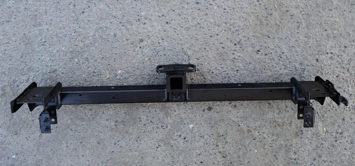

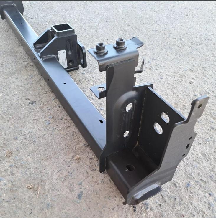

Found a picture of an OEM hitch. Certainly looks like the side frame attachments are solid. No concern there. But...
Rivian R1T R1S Motorcycle hitch carriers - Recommended or not? (~300lb bike) 1
The receiver portion I worry about. Yes it isn't simply welded on and it has some additional supports. What's everyone's thoughts?

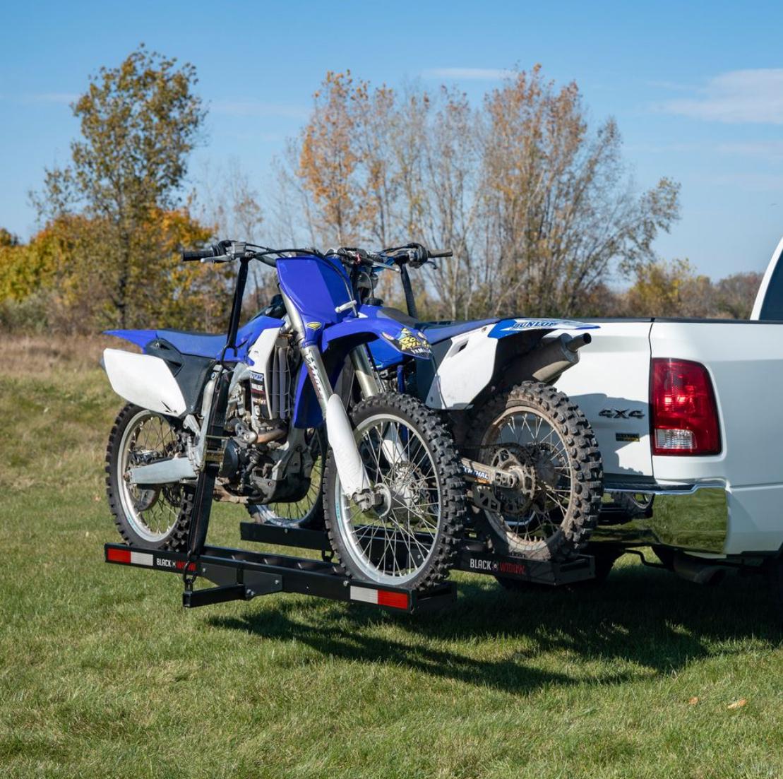

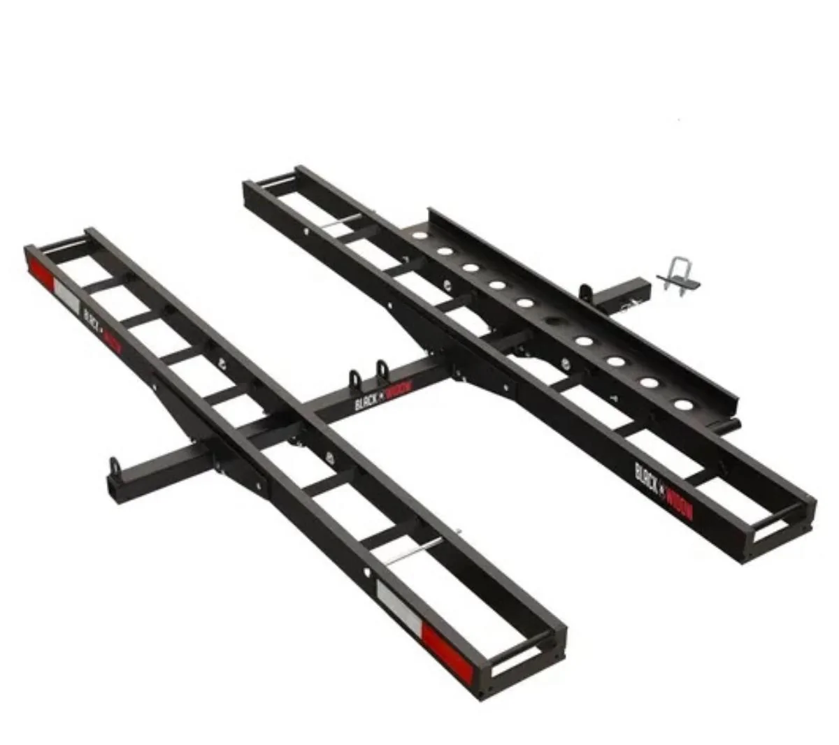

I have black widow, dual dirt bike Carrier. I put 2 Stark Varg on it.
Most importantly , get a lock bolt, so the rack doesn’t move when driving.
You will be fine. If you have good insurance, then Send it!

Over-thinking it !!!
