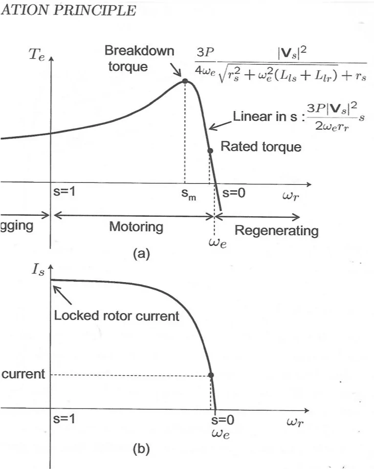

...speed versus torque curve (which is actually a straight line). Maximum torque can be applied at 0 RPM, and 0 torque can be applied at maximum RPM.
You may have just not worded things the way you intended to but the speed vs. torque curve for an induction motor is hardly a straight line though there is a portion of it which is nearly linear between the "breakdown point" and the speed where the rotor and electric field are going at the same speed. This is the "stable" part of the characteristic where the motor can be controlled and thus where it is operated in the BEV application.
s=1 on the curves represents 0 rpm. As the plot clearly shows the torque available at s = 1 is considerably less than the maximum available torque at the breakdown point. One can get higher locked rotor torque by increasing rotor resistance but this is at the expense of efficiency. There is also chicanery whereby high rotor resistance for maximum starting torque can be switched out for more efficient operation in the linear region.
As there is no relative motion at s = 0 there can be no torque produced at that speed but for s < 0 the torque becomes negative i.e. the "motor" starts to act like a generator (regen).
For electric motors the "sweet spot" is at the halfway point on the speed versus torque curve
For all the electric cars without shifting gearboxes, it is easy to know the "sweet spot", just divide the maximum speed by 2.
Think about this. What is the maximum speed? On the torque curve above I suppose you could call the maximum speed Ω corresponding to s = 0 but that's just the electrical speed and the electrical speed in a BEV is all over the map depending on how fast you are going and what slip you want.
In fact the most efficient speed is a function of rotor and stator resistances and the leakage inductances.

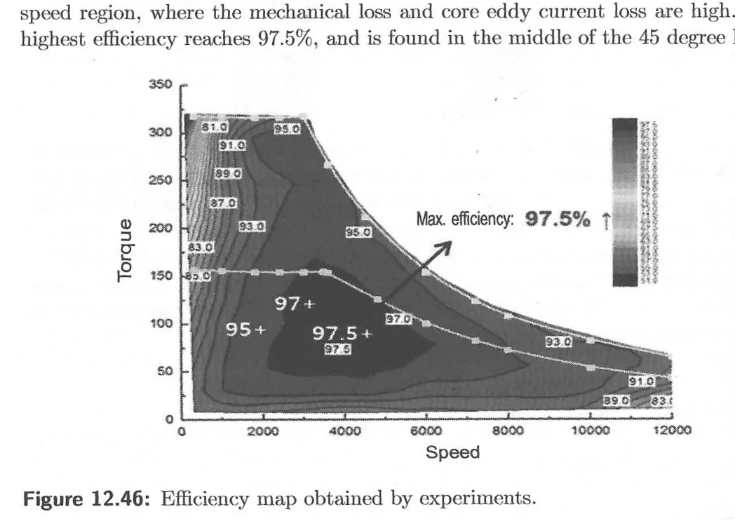

Now that's the story for induction motors. My Tesla has one of those but it also has a PMSRM with a somewhat different theory so to illustrate the point that things aren't as simple as you try to make them I'll just put up this efficiency contour diagram for a real experimental motor (more about it than that I do not know). I don't recall what Rivian is using for motors. The SW concept is very appealing because of no rotor copper loss (or expense) and 0 no rotor hysteresis loss.
The sweet spot is about 1/3 of the way between the origin and the maximum plotted torque and maximum plotted speed. The real message here is that the "spot" is huge.
My Bolt has a max speed listed as 85, so it has maximum efficiency at 42.5 mph. The Rivian is listed as max speed of 125, so maximum efficiency is at 62.5 mph. I have not looked up any Tesla models top speeds.
I hope I have adequately explained why it doesn't work that way.
