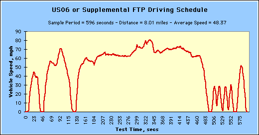

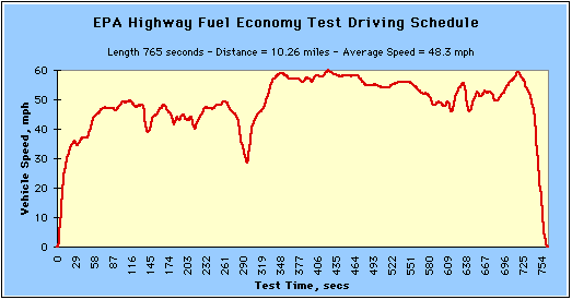

As for EPA ratings, my Bolt has an EPA range of 238 for normal driving, but it is rated at 213 for highway driving only. That is a 10% reduction, which is completely understandable considering increased drag and no regeneration. EPA highway assumes 65 MPH speed.
Actually, the EPA hwy test cycle has an average speed of 48 mph with a top speed of 60 mph.
If GM used the 5 cycle test instead of the 2 cycle test, one of the additional cycles would be the "high speed" test. The average speed of this test is still 48, but it does hit 80 mph.
The Bolt got 310 miles on the hwy test. This number is derated by 30% to better reflect real world conditions.

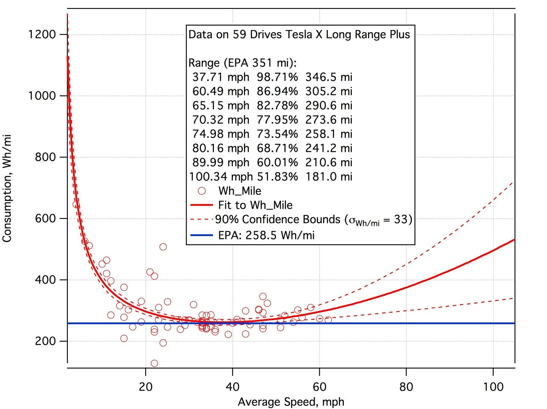

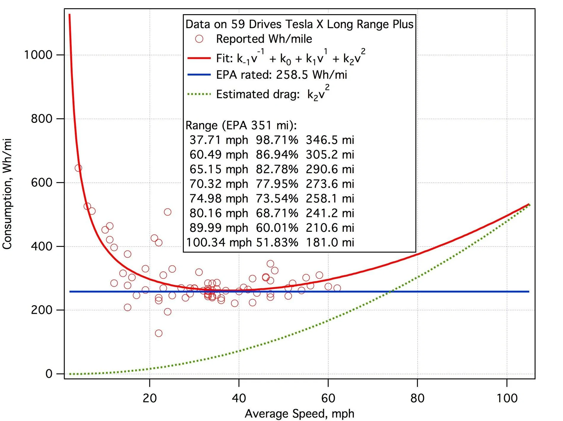

I've always found them pretty good but I suspect I drive more conservatively than many of you do.
Here's some data on my last 80 drives (with Covid quarantines we just haven't been out much).
Note that the drives (little circles) represent the consumption as a function of average speed for the drive. There is a little freeway at 65 and 70 but even so the average speed for the drives tend to be lower. Nevertheless the dominance of unrecoverable inertial in heavy traffic is plain and the v-squared dominance of drag at higher speed is at least hinted at. The heavy blue line represents the EPA overall estimate for my car (EPA range 351 miles - not subdivided into city and highway or if it is I don't have that data). As the data show I do get the EPA rated consumption sometimes, even up to 62 mpH average soeed, and sometimes I don't, even in town. Strong message to people for whom the Rivian will be the first electric car: YMMV!
For fun I fit a polynomial to the data which picks up both the inertial and drag loads pretty well. I then plotted the v-squared term separately as the dotted green curve. This suggests that drag will become noticeable at about 60 mph (where I estimate it will steal 15% of my range) and dominate above say 70. At 100 mpH I estimate, from these data, that it would eat half.
I know not many here are conversant with manipulation of data sets of this sort so I include the caveat that these data are at best representative. You will not find your R1T or R1S turning in data identical to this. Just be aware that high speed will eat your lunch. I wonder that the Germans buy these things (I assume there are still some frei fahren portions of the autobahns).

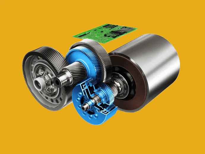

Some very good points there. Here's the obvious solution:
In case you don't recognize it it's the gearing from the Taycan. There are some interesting articles on the design of the car which touch on the issues you raised.
There is, of course, an obvious down side in terms of added weight, complexity and, especially, reliability. Evidently Tesla started out with something like this in mind but dropped it.

Unlike Tesla, the Taycan uses a two-speed transmission, which may be one of the reasons Taycans are getting significantly better range than their EPA rating in extended driving. Lucid is going to use an epicyclic transmission, but I don't know anything about their gear ratios.
Well yes. That's the point I was trying to make in posting a picture of the Taycan transmission.
Your numbers are similar to my experience with the Bolt. Here are some ranges I have actually seen on long trips, my EPA rating, which is combo of city highway is 238, but as you state this can vary with weather, driving conditions, HVAC, etc. The numbers below are all with AC on.
65mph trip - 215 miles (10% loss of EPA range)
75mph trip - 190 miles (20% loss of EPA range)
100mph trip (75 speed + 25 wind) - 170 miles (30% loss of EPA range)
I am actually surprised the 100 mph case was not worse, but part of that rip was 65mph in the city and not directly into a headwind before hitting the open road.
Earlier on, I saw an interview with a Lucid engineer in which it was said that Lucid was going to use a cycloidal transmission. A more recent interview with Rawlinson had him stating they were using an epicyclic transmission. Thinking they might be two different terms for the same design, I did a little internet digging and found they are significantly different in design and application, although both have certain advantages over conventional automobile transmissions.
Rawlinson has said that Lucid's 600-hp motor, inverter, and transmission have a combined weight of 160 pounds and yield the most volumetric efficiency of any EV drive unit.

Your numbers are similar ....
"Similar" is the word I'd like to emphasize the most strongly. Your results better be similar to mine because we are subject to the same physics. But we are using sampled data from a set where things can vary widely dependent on driving style, weather, road surface condition, terrain etc. When I predict that I'd lose 48% of my range driving at 100 mph that is just that - a prediction and predictions come with uncertainty. We have ways of quantifying that uncertainty and I'll do that but I'll just point out that predicting what will happen at 100 mph from a data set than ends at 62 mph is what one colleague used to call "bold extrapolation". I once witnessed an old, respected university professor (from my Alma Mater, yet) just destroy a young man from overseas when he presented data using "bold extrapolation" at a professional society meeting. But it is OK to do it if you understand what you are doing.
So here's my drive history again with the curve fit to the data.
But this time there are dashed line curves on either side of the best fit curve. These are the 90% confidence limits. IOW the actual Wh/mi at 100 mph lies between 339 and 659 Wh/mi with 90% probability based on the quality and quantity of the data I have. The way to improve the quality of the estimate is to get more data and have more of it at higher speeds. But that's what statistics is all about: drawing reasonable conclusions from the limited data you have.
