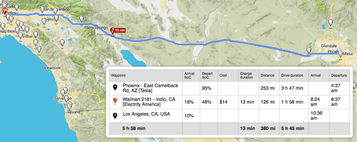

Also, keep in mind that range estimates are NOT for highway range, the faster you are traveling the less range you will get.
ABRP (if you don't have it get it) that I used to make the picture above takes speed into account.

Yes, you had a bad experience once, but how long was the power out for? That broken charger in Blythe was down for an entire month, and caused great grief to all of the non-Tesla EVs that made that trip. That broken charger cost me 2-3 hours each way on my round trip, because even though I reported the problem to EV Connect, they did not fix it in a timely manner. And since EA has not even begun to install the new chargers in Quartzsite, this is still a situation where one station failure affects many drivers. Obviously I know that the Rivian will make this trip easily with it's increased range and that is why I will only get it with the 180KW battery. But, Rivian is still not delivering vehicles yet, nor is the CT out yet. The article I was commenting on was based on today's vehicles and today's non-Tesla charging infrastructure. I will provide yet another situation about charging infrastructure, there are no CCS chargers on the route from Phoenix to Las Vegas, making it extremely unlikely that any of today's non-Tesla EVs can make that trip.
Keep in mind that today there are only 3 non-Tesla EVs with a range close to 300 miles (i-Pace, Kona, Niro), most others are less than 250. The future has not yet arrived.

I don't think anyone reading this forum would be terribly concerned about what might or might not happen to a Bolt owner or any other owner of one of todays' EVs be it Tesla or no assaying to travel between Phoenix and LA or Phoenix and Vegas. They are probably much more concerned about what their prospects will be in the (we hope) fairly near future when their Rivians start to be delivered. The CCS charging infrastructure is clearly sufficient to support a trip in a R1T from Phoenix to either LA or Vegas. The future is definitely here now in terms of the charging if not in terms of the truck.
Many here may be worried by your assertions. I'd like to make sure their worries are dispelled. Let's look at the Phoenix to Vegas route a bit further. It's about 305 miles. The fact that there are no CCS chargers along that route would be of no concern to the 180 kWh battery owner as he's got 400 miles in the tank and thus does not need to charge between Phoenix and Vegas. Or does he? If he want's to drive 30% above the speed limit he'll have to stop off at Anthem and leave there at 95% SoC. What happens if a big headwind comes up? The on board indicators would show the necessity to charge and he would go to one of the numerous camp grounds with NEMA 14-50R chargers available. Clearly another BEV with less range than the Rivian could make the trip using these stops for recharging (and evidently do from the logins shown on PlugShare).
