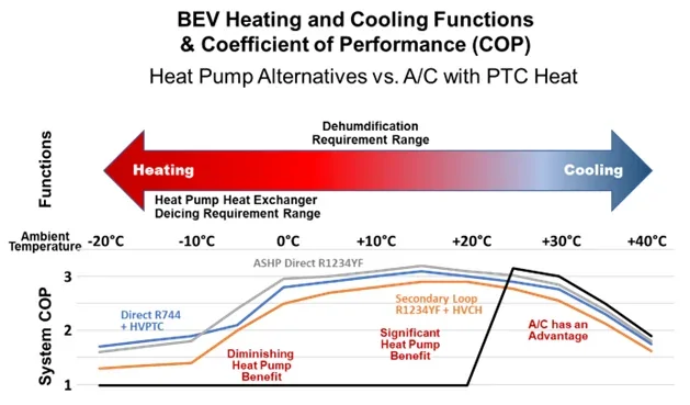

…The heatpump may matter to those who don't live in very hot climates as heatpumps aren't as efficient as typical AC when the temps are 90+.
Totally serious, honest question (not being snarky): What are you basing this statement on? An AC is a unidirectional heat pump. Why would a bidirectional heat pump be any less efficient at cooling? Wouldn’t it totally depend on the specific hardware you are comparing?
We can say with certainty that heat pumps are WAY (2-4 times) more efficient at heating (under normal operating temperatures) than resistive/PTC heaters.
I don't claim to be an expert in this area but I've read several articles and my experience with a non heat pump Model 3 and the same version with heat pumps showed I had worse efficiency in the Texas summers. Heat pump efficiency is typically less than traditional AC units at higher temps if this graph and article is to be believed. It aligns with other articles I've read.
Also keep in matter the faster you go, the less heating/cooling are a portion of the overall energy used and matter less than at lower speeds as aero dynamic drag is largest consumer of energy.
I'll also add there is a very good thread here where someone has compared their efficiency over the same route in the Gen1 truck and Gen2 truck and basically no difference in efficiency between the 2.

https://www.itbgroup.com/blog/2023/02-battery-electric-vehicle-heat-pump-system-value
