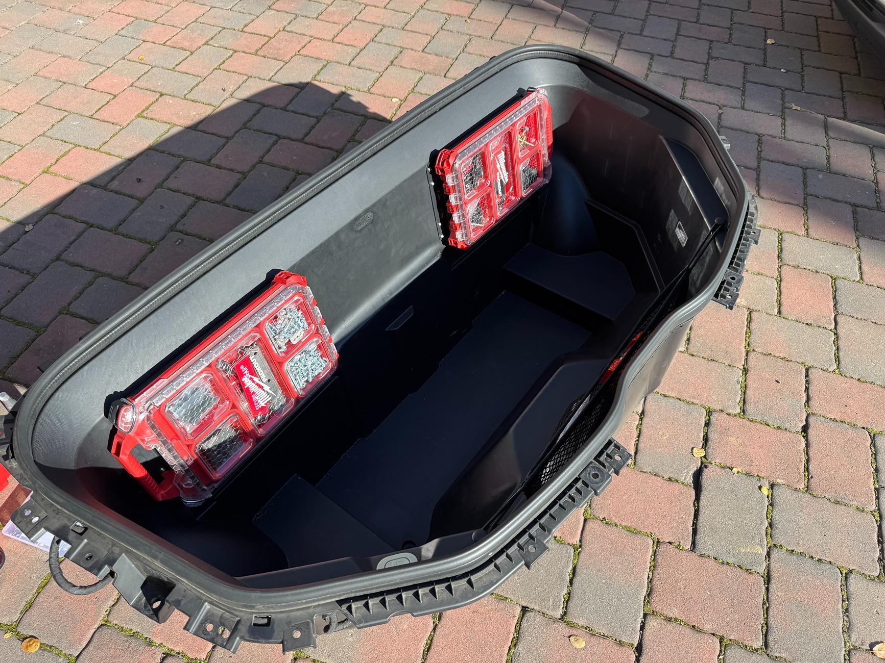

Love those Milwaukee Packout organizers. Have started to use them in the garage, for tools, parts and more and more so on the truck. I have a set of them on a Mole panel in the back of the truck and was looking at adding a few small ones to the frunk. Found a great aluminum mounting plate on Amazon and after my Mobile Service appointment earlier today, thought it was a great sunny day to install a pair for the frunk:
Rivian R1T R1S Milwaukee Packout organizers for the frunk IMG_0411
8 Stainless steel M6 bolts with stainless flange nuts in the back. Made sure they all cleared and did not touch or rub against anything.
Rivian R1T R1S Milwaukee Packout organizers for the frunk IMG_0397
Rivian R1T R1S Milwaukee Packout organizers for the frunk IMG_0403
These now hold all my Yakima and Küat nick nack as well as Mole Panel screws and fasteners.
Total time about 75 min to install.
Bonus: Got to blow out all those leaves that have accumulated in recent month inside all the cracks and the entire front section of the truck.

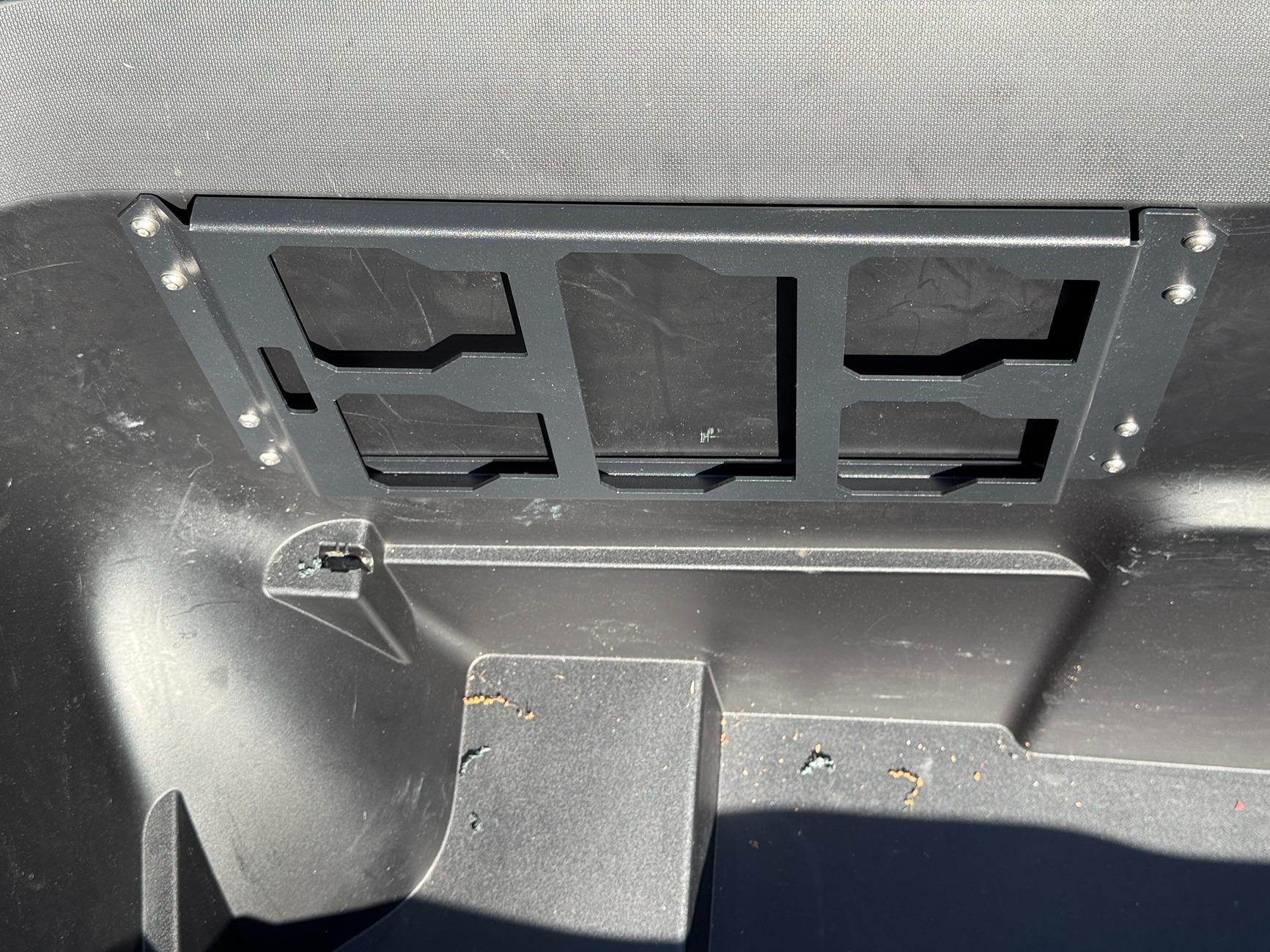

Looks great! Do you have a picture of how you did the back?
Here we go. Used shorter bolts on the bottom to further reduce the chance of rubbing against something. Used Blue loctite on all of them. The are stainless steel flange nuts - the extra surface area helps with the plastic.

........... stainless steel flange nuts - the extra surface area helps with the plastic.
curvature of plastic might limit the use but I have found "fender washers" to work well - wafer thin, large OD and small ID
