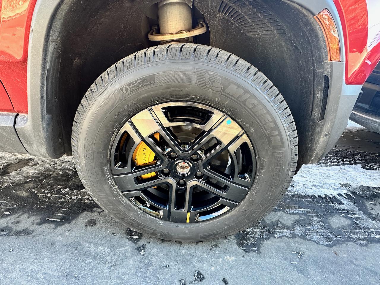

Put me down as another happy Michelin Defender LTX owner. I took the Pirelli Scorpion All-Terrains off of my 20" wheels a couple of days ago, and instantly prefer the Defenders: smoother, quieter, quicker, better ride, better handling. Though to be fair, none of those a HUGE differences.
But I'm also hoping for (too early to tell) better efficiency, longer life, and lower cost.
I stuck to the OEM size of 275/65/20. I would have liked to size down, as I suspect (not positive) that would be cheaper, lighter, more efficient, and handle better. But the OEM size won't cause objections from tire shops, should cause fewer objections from Rivian, doesn't require reprogramming (or living with speedo/odo differences) and likely has a better ride and less chance of damage from potholes and such. If nothing else, a Defender in the OEM size is going to be better than the OEM Pirellis on the things I care about.
It's true that the Defenders don't look as good, and they certainly don't off-road as well - but I don't drive off-road.
With the new tires:
Have you been able to find what the diffence is between the original and the defenders as efficientcy gains?
