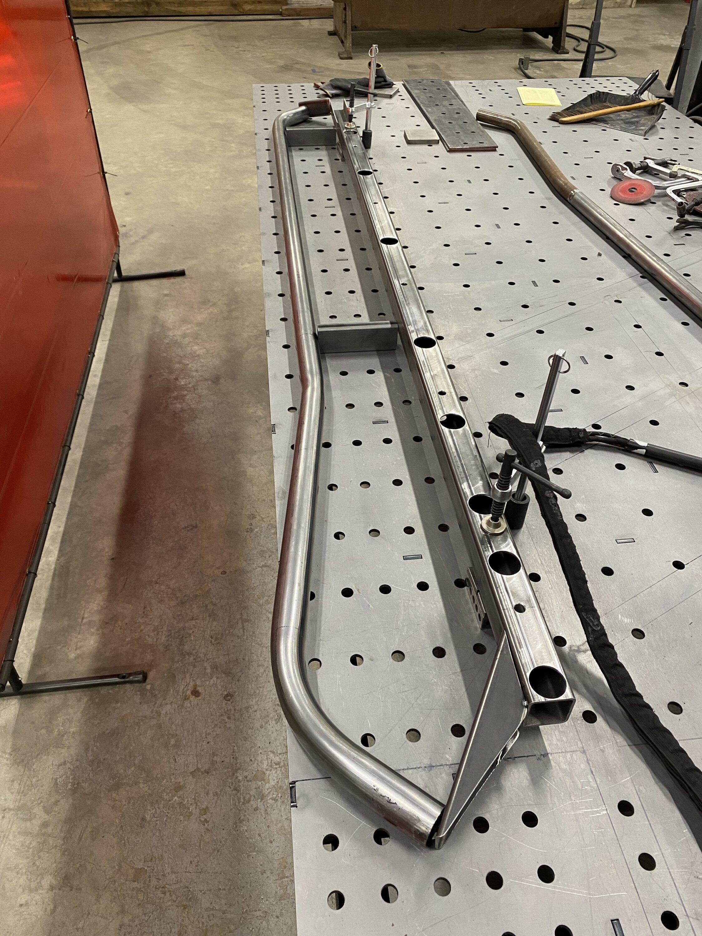

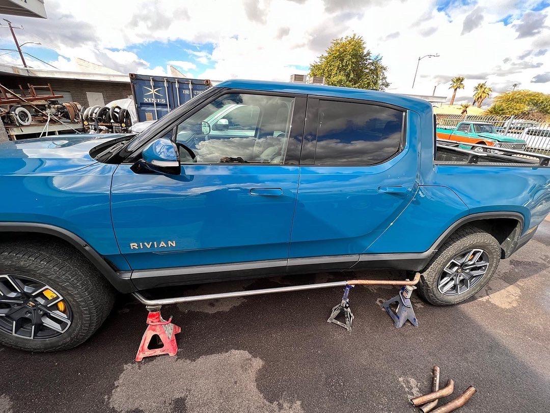

Exciting news to share. Per my post here, I am proud to provide you all with an update regarding performance rock sliders from Megawatt™, which will be available at Electruck4x4.com!
The team has been working tirelessly over the past few months to bring together race-proven designs and trail-tested construction and adapt them to the already capable R1T. What we've arrived at is a no compromise, tough as nails solution that is a rock slider first with the added benefit of being a full length running board step. Given the weight of the R1 platform, we thought this approach was absolutely critical to ensure reliable protection of a ~7100lb, ~$100,000 truck.
The performance rock slider from Megawatt™ will be the only rock slider on the market that incorporates .188" main rail protection with a stylish, yet highly functional kick-out. It will also be the only rail to incorporate a hybrid mounting configuration that utilizes direct-to-frame mounting (no standoffs) with a unique bracketing system for added roll support.
These units will be priced at $1500 a pair with a 15% discount going to all pre-order holders. We anticipate final production of initial units to occur on January 31st. I didn't want to photoshop anything. So, I will post additional photos in the next week or so. In the meantime, teaser shots and current specifications are as follows:
Rivian R1T R1S Megawatt™ Rock Sliders for R1T. Coming soon to Electruck4x4.com CEE77E97-585A-47BE-8172-6DD847E12F7A.JPG
Rivian R1T R1S Megawatt™ Rock Sliders for R1T. Coming soon to Electruck4x4.com Rivian Step 1
Rivian R1T R1S Megawatt™ Rock Sliders for R1T. Coming soon to Electruck4x4.com IMG_1166
(Image notes: Final design will include more rub rail supports and a step plate)
Highlights:
  • Full-length vehicle coverage
  • Laser cut, welded step-plate for convenient vehicle access
  • Integrated rear kick-out
  • Powder coated in texturized flat black for maximum grip, abrasion resistance, durability, and rust resistance.
  • End-to-end rub rail to main rail tie-in for maximum rigidity
  • Boxed ends add strength and prevents debris accumulation
  • 100% made USA by expert fabricators.
  • Precision TIG welded (no MIG welding) for superior welds
Specifications
  • 100% DOM heavy wall steel
  • Main slider:
    • 2" diameter box steel
    • .188" thickness
  • Rub rail:
    • Heavy wall 1.75" diameter tube steel
  • Mounting brackets:
    • .125" plate steel
  • Weight: About as much as an extra adult passenger. (Exact weight figures will be available within the next week or two).

They're definitely the most robust thing out there for these trucks. They should be though, as they were benchmarked on sliders for trucks of similar weight.
I'll be posting some of the requisite color-shaded CAD images that show our simulations. That said, we definitely plan to take/post real world testing media ASAP.

  • How much does each side weigh? We're still putting the finishing touches on the design. At this point if I had to throw a number out that I'm sure I'll regret because of its inaccuracy, I'd estimate ~120 lbs per side. This not unheard of for high-performance sliders that support vehicles of this weight. Think of it like brining an extra buddy along. However instead of taking up space, he saves you thousands in body repairs :).
  • How much clearance do they take away from the vehicle? We need to get them back on the vehicle, but I would estimate about .5".
  • Will the sliders (outer edge) be capable of supporting the vehicle on a pivot?
    100%. This is a non-negotiable.
