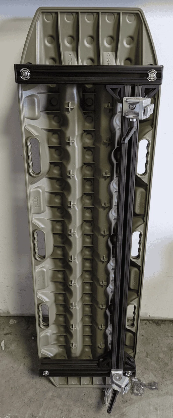

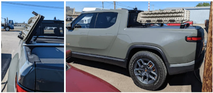

I made these out of 80/20 with a pivot so I can lay them flat or tip them to the angle of the side of the cab.
This looks awesome. When you get a chance, can you show a close up of the attachments. Did you use the maxtrax pins? I'd love to replicate this. Thanks! PS nice config :)

I ordered the Maxtrax and pins together from Maxtrax USA directly. The mounts Rivian show are basically just a plastic part that mounts their pins and has holes/slots to put the cargo bar spacing correctly. The pin spacing on the trax is roughly 4 in further than the spacing. If I was going to keep them flat all the time, I would probably just 3D print the bracket similar to Rivian's version. Just a thought if you maybe plan to keep them flat. I'll go grab a photo of the back. I had taken them off for now because I had to haul some stuff for work. (Don't mind the garbage on the floor :p Guys haven't swept in a couple days.)

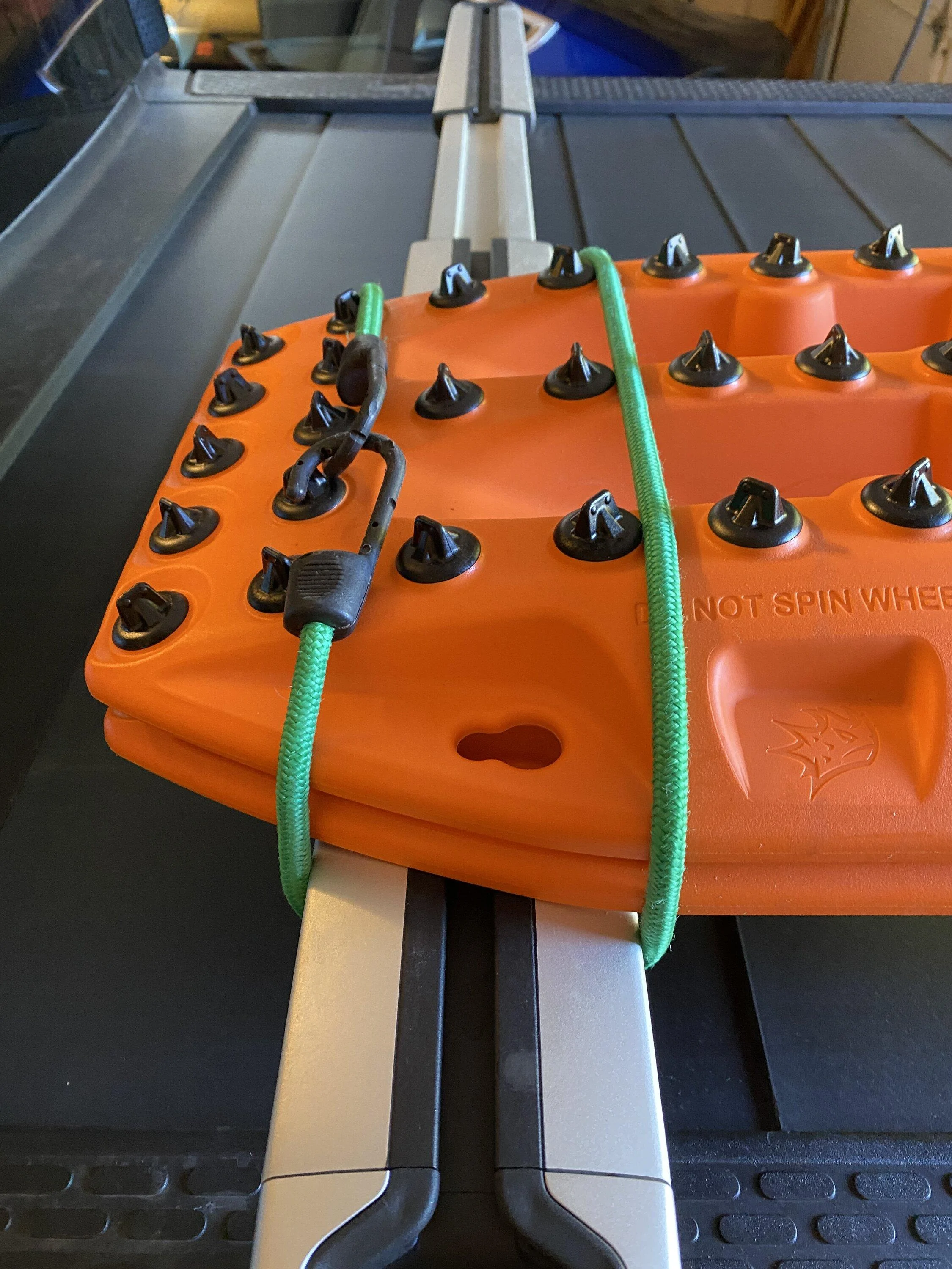

Why spend $130 when a pair of bungee cords will do the job:
(another bungee on the other end plus a cable lock to deter thieves; too bad the gear guard cable won't work with the tonneau closed)
