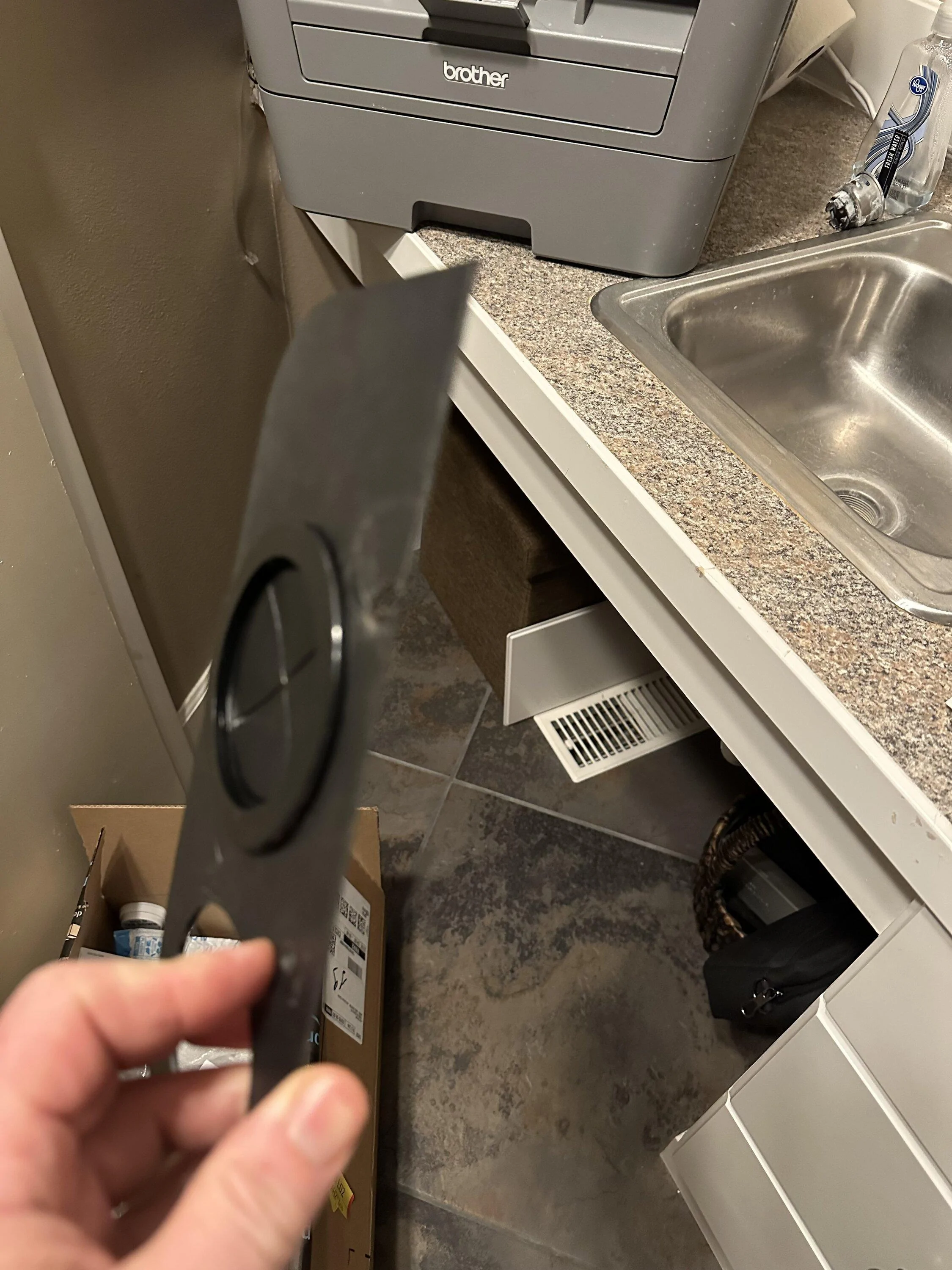

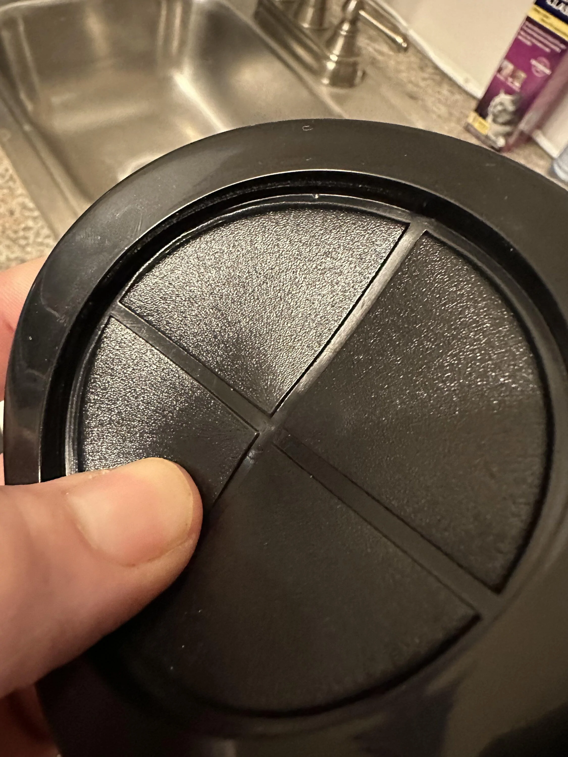

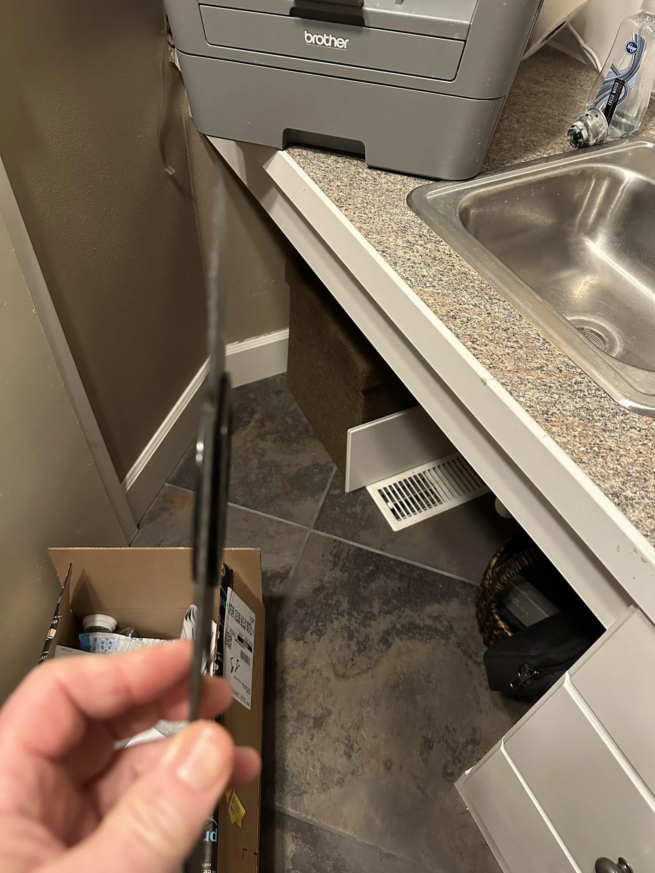

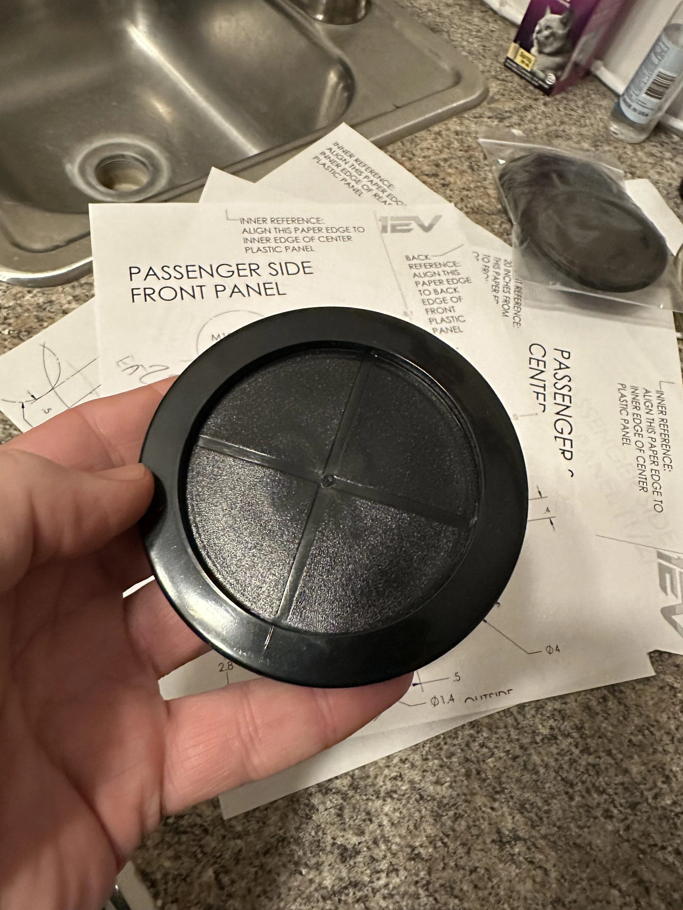

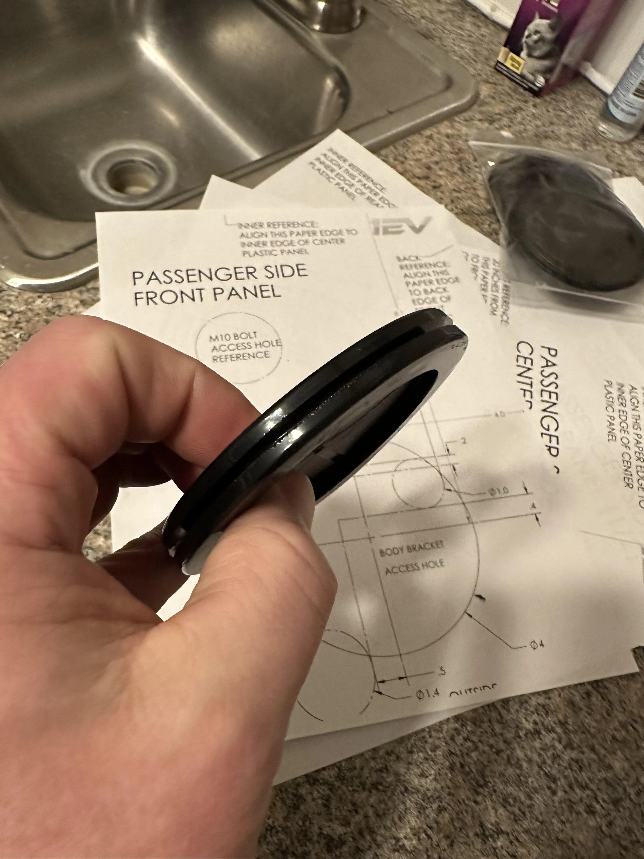

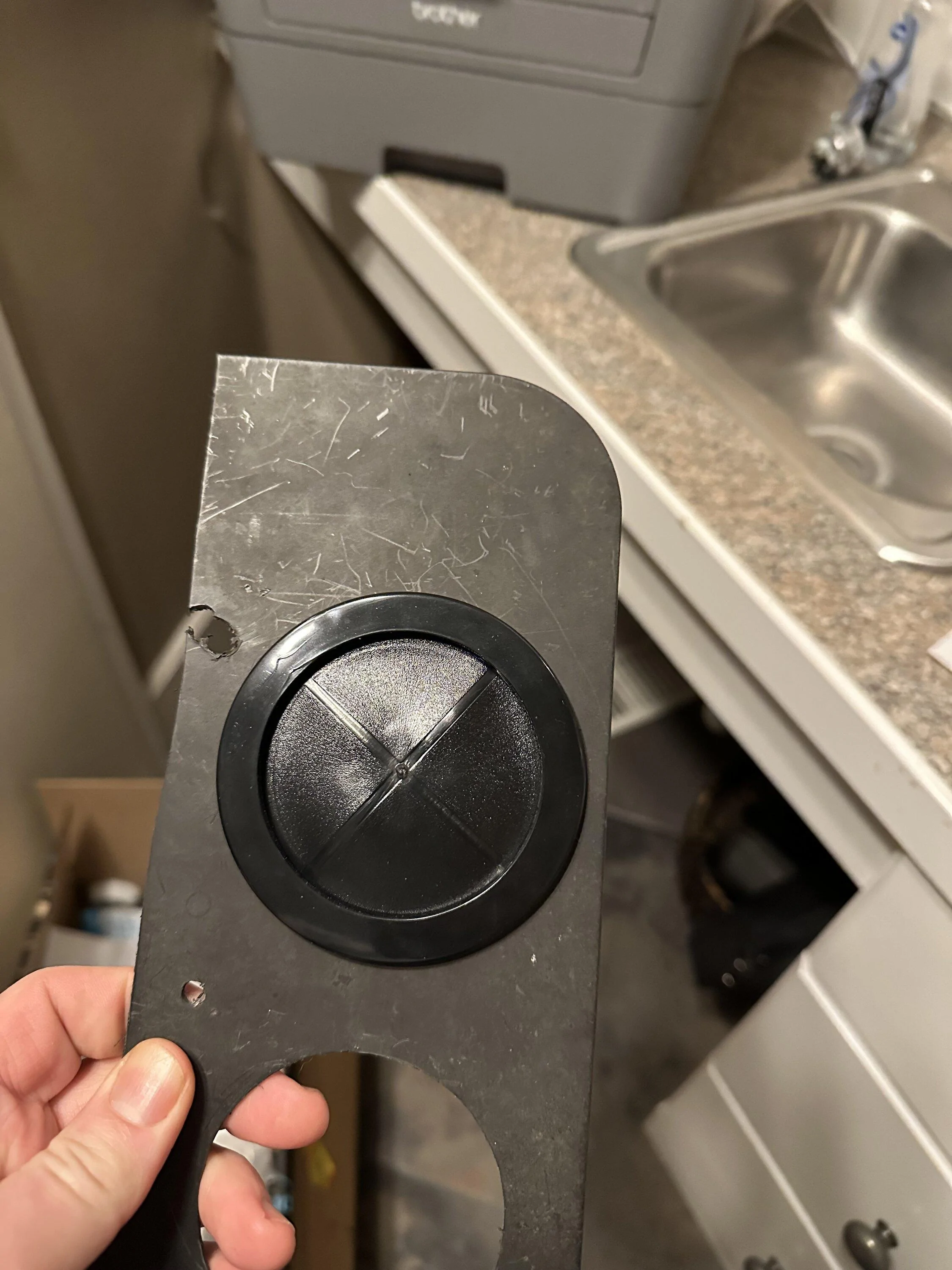

Set 1 of 4 of the Chinese rubber plug sets have arrived - These are the 80mm hole size ones. Enjoy in good health! 90 or 100 MM are probably the right ones, if not the thermoplastic plugs posted earlier.
Edit: Not a fan of how thin the material thickness is at the "pre-cut" "Plus" lines, however. I may just stick with the thermoplastic plugs, we'll see....

Are those 80mm holes or 100mm?
See my post you quoted. :giggle:
The pictured plugs are 80mm, as stated. I do think 4" thermoplastic caps, or the proper 100mm rubber plugs are the best path as going that route will allow a "Retrofit path" for those already with 4" holes - assuming those 4" holes were properly positioned when drilled to avoid bracket interference at the plug margins....
