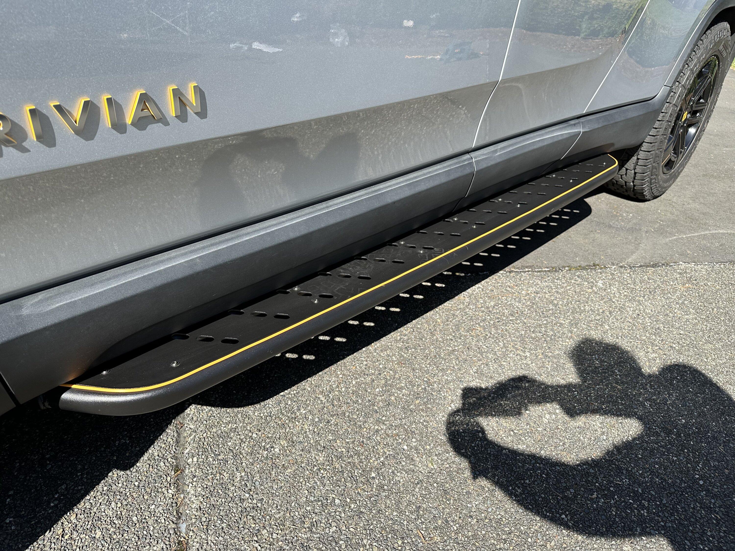

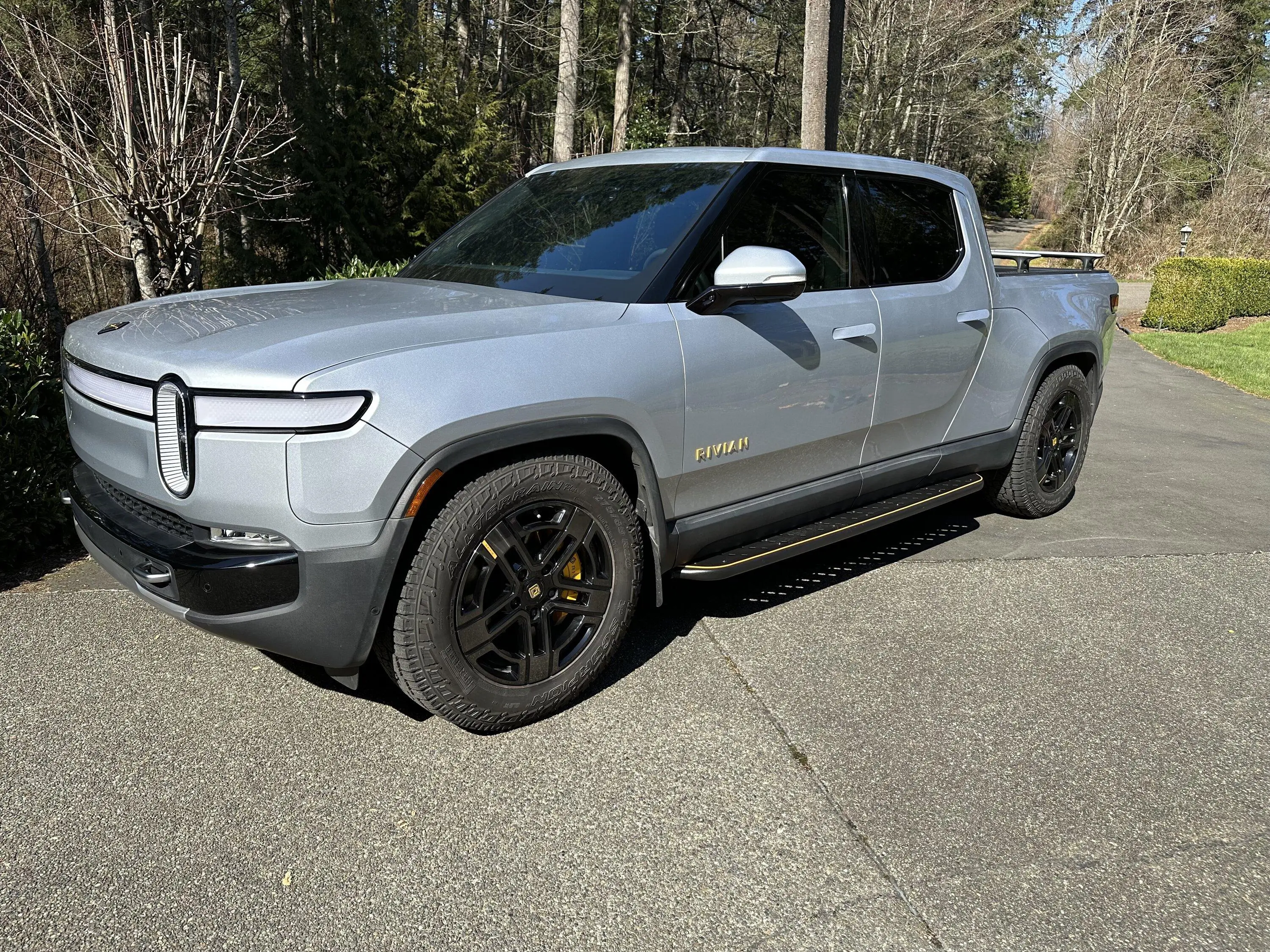

It's all good, i am actually pretty handy on my own. So i installed them last night and they came out. Here are photos of the final product.
Thats the look I wanna go for eventually, once I pull the trigger on changing my wheels.
Looks nice! Are you going too add some welting?

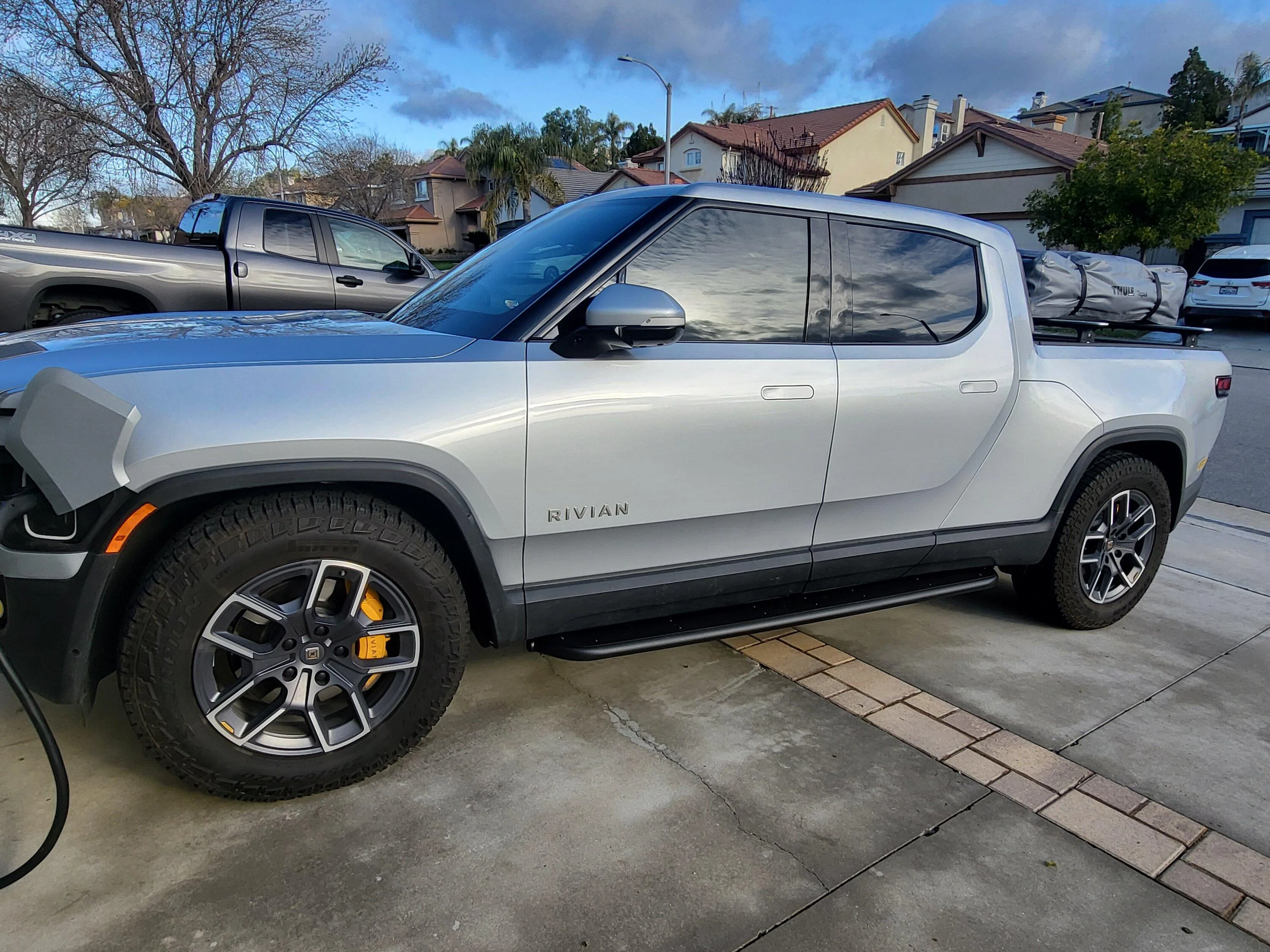

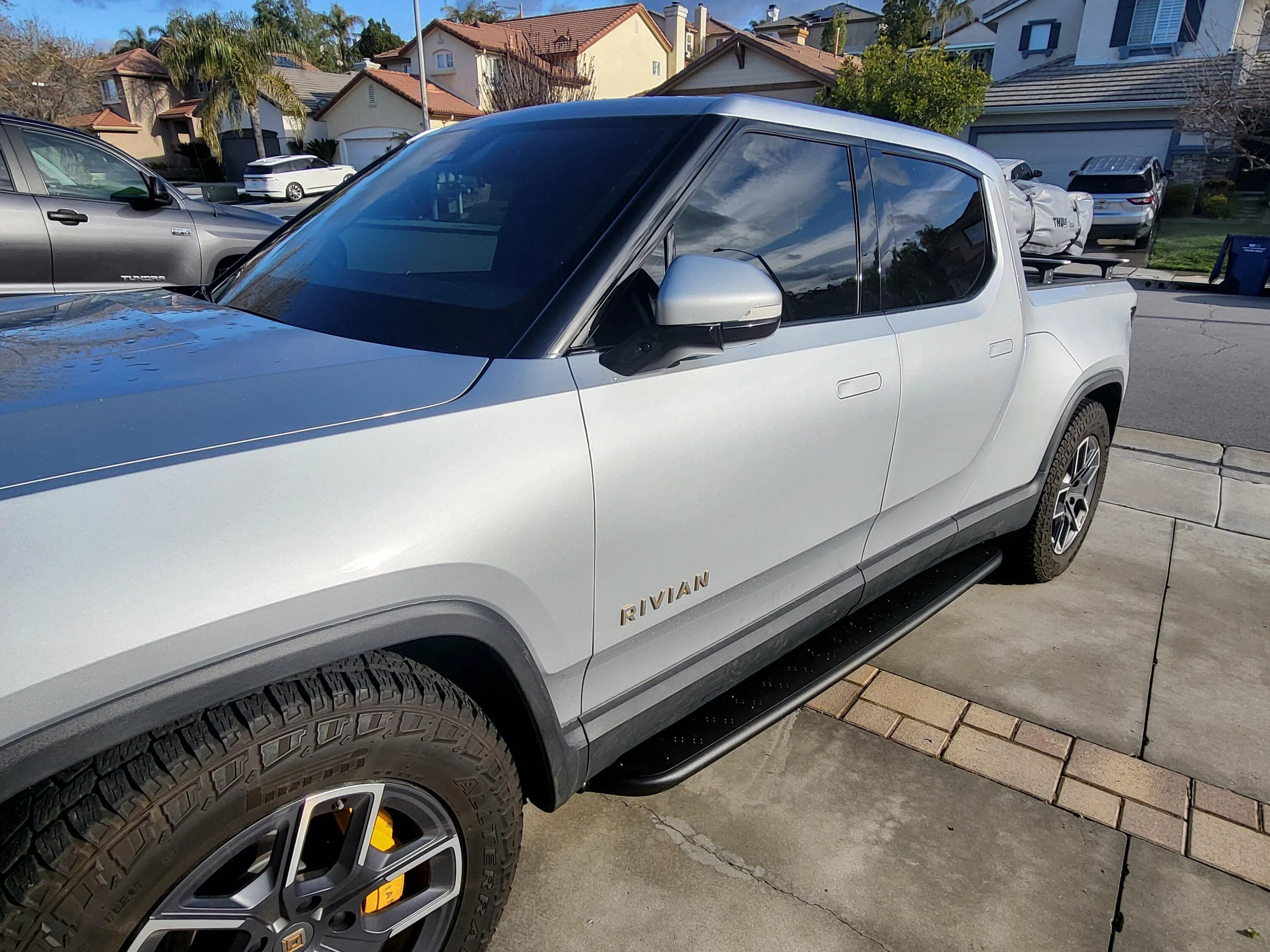

Rivian R1T R1S Master Thread:  Review of the EV Sportline RMaxx Running Boards/Sliders (from Team 1EV) 20230324_082948

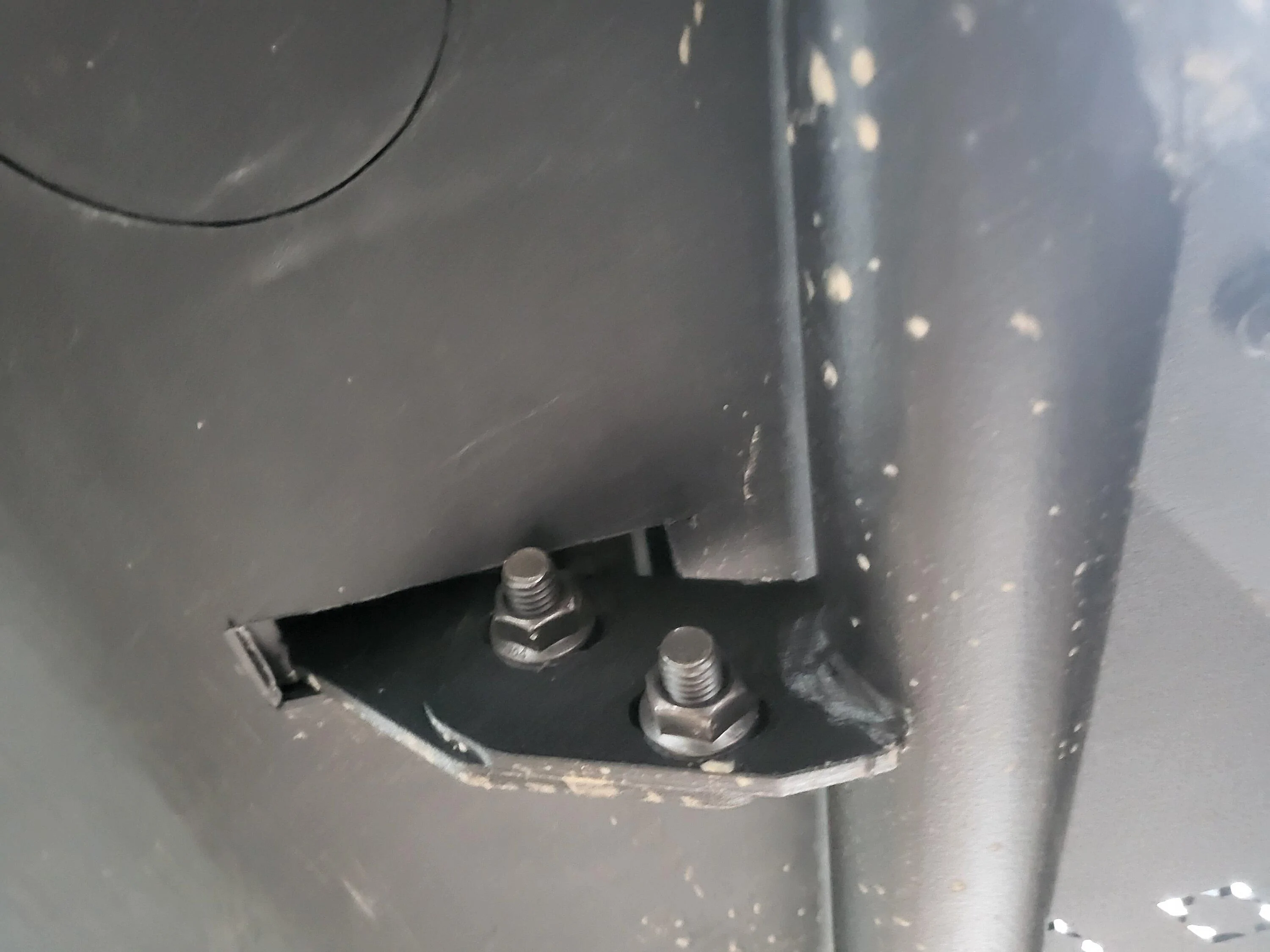

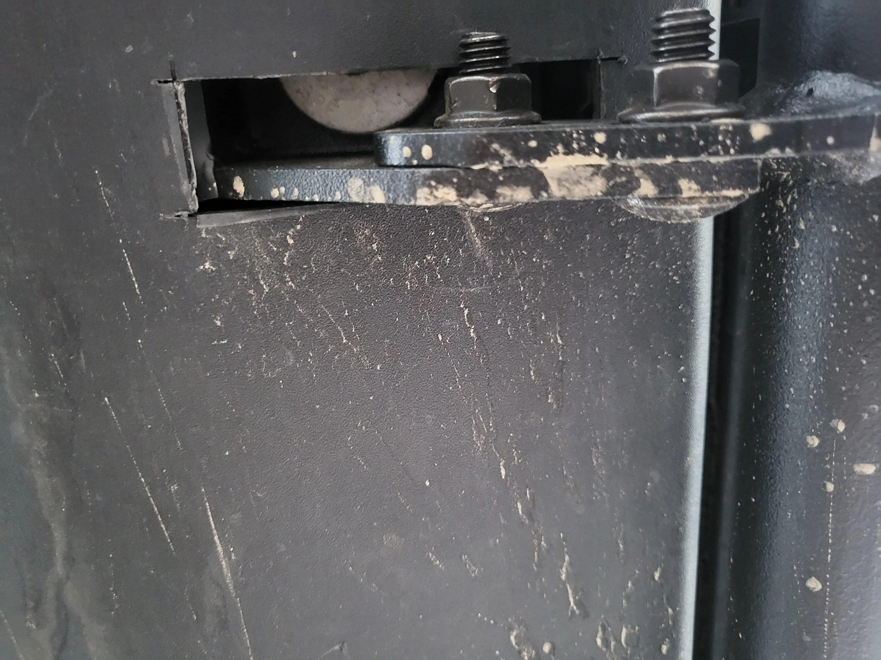

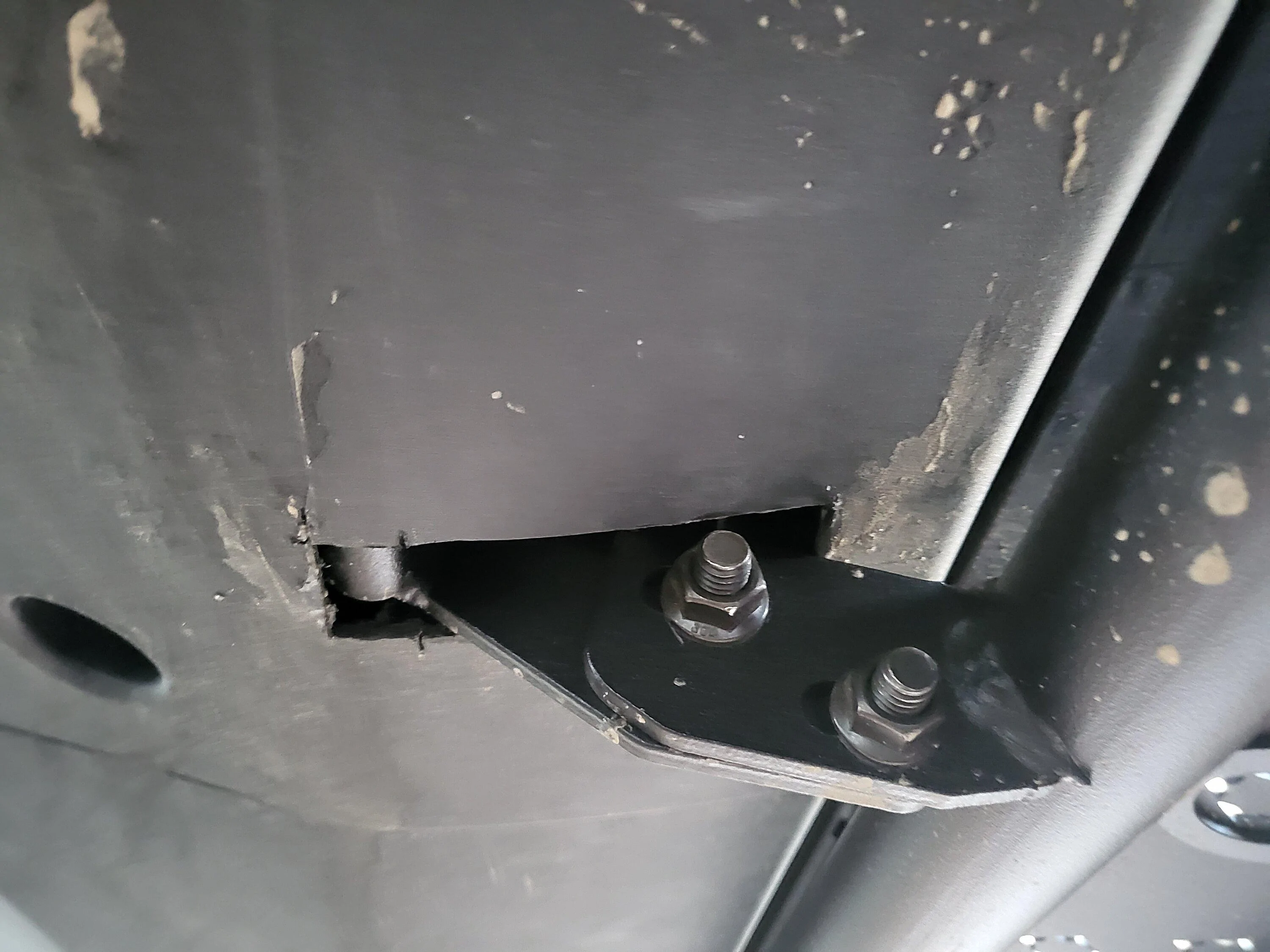

I skipped the hole saw and went with an oscillating saw to cut slots into the plastics but i also had to trim the plastics to fit the arc in the brackets connected to the frame. Took me about 3 hours taking my time.
Can you post some pictures of the slots and fit? Do you plan to seal them with the help of the Gorilla?

Rivian R1T R1S Master Thread:  Review of the EV Sportline RMaxx Running Boards/Sliders (from Team 1EV) 20230324_185616
Rivian R1T R1S Master Thread:  Review of the EV Sportline RMaxx Running Boards/Sliders (from Team 1EV) 20230324_185618
Rivian R1T R1S Master Thread:  Review of the EV Sportline RMaxx Running Boards/Sliders (from Team 1EV) 20230324_185610
I don't plan on adding anything to close up the holes more. The plastics on the bottom are mostly deco and aero finishes. When i took them off, there was plenty of dust in there from a couple desert trips and nothing else in the cavity that would be impacted from the weather conditions in my area.
