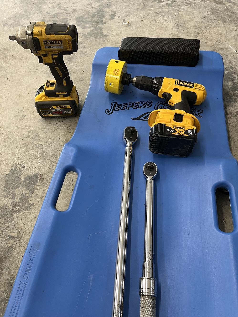

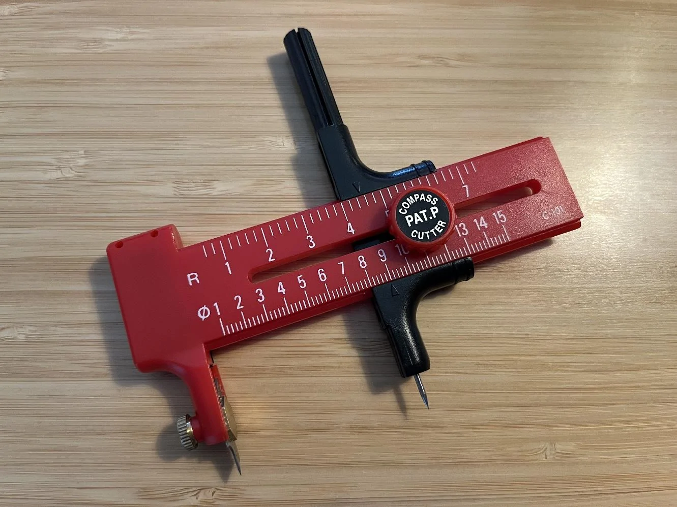

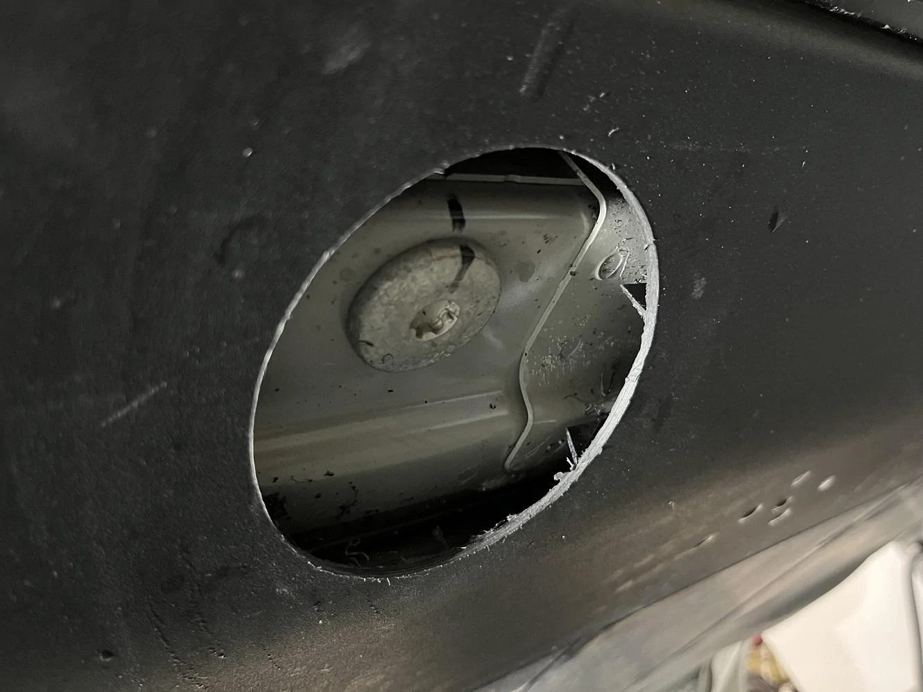

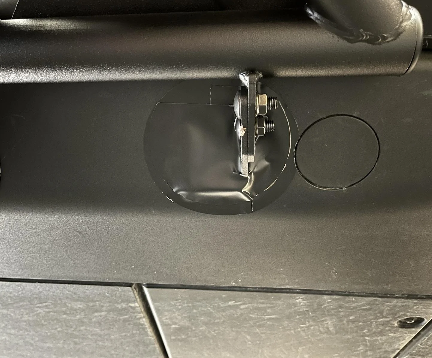

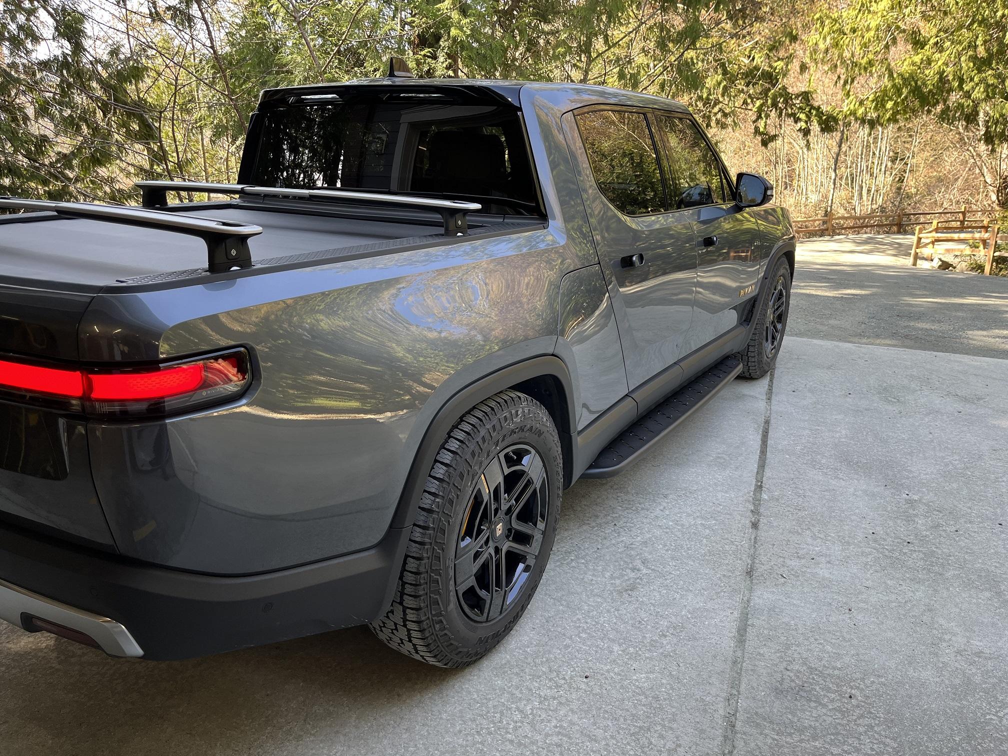

Finished the install today. Nothing difficult about it. Here's my install timeline:
  • Friday - marked holes - 25 minutes.
    • Cross checked hole position against step bracket position - 20 minutes, tweaked a couple locations
  • Friday evening - unboxed everything, broke down packaging, rewashed the mount areas, swept floor of install area - 30 minutes
  • Saturday morning - Full install - cut holes, mounted plates to steps, mounted brackets, mounted steps, torqued everything - 2-1/2 hours
  • Extra credit - cut and installed Gorilla Waterproof Patch & Seal Tape (3 semi-circles per hole) - 1-1/2 hours
  • Cleanup, put away tools, took some pictures - 30 minutes
  • Lunch, mini-DQ Blizzards, scenic drive - 3 hours
Install tips
Use a high quality hole saw. Make sure the pilot is drilled out well first, keep the speed low-medium before moving in for the hole cut. The Starrett 4" I used was purchased specifically for this project. I left my ACE hardware special in the tool box. The cuts were very clean without any cleanup other than running a finger along the edge to get the shavings to come loose.
I used a compass cutter to cut the tape semi-circles. I used a modified @jebinc method. I tried to keep tape off the mounting hardware and I added a 3rd semi-circle perpendicular to the first two.
Pics below.

Tell us more how you feel about the Gorilla seals and method?! Did you try plugs?
I have 4" plastic plugs and there's no way these would ever work. Maybe with 5" holes but getting the slot right, and doing it 8 times doesn't seem fun, even with my creeper with it's pillow. Even with more beer.
The Gorilla "tape" method is probably going to work fine and it's reasonably clean and sealed up, but not perfect. I'd redo them all if I could, but that stuff is very tenacious and probably not coming off easily.
The EV Sportline instructions say 100 ft-lbs for the TP55 and that's what I did, using the long torque wrench.
Same conclusion on the plugs. I would need medication trying to get 4” plugs to work, even 5” ones. F that noise!
I went with the DCE supposed Rivian torque value of 55 ft-lbs - as no instructions were in my RB box or hardware bag.
Yeah, that Gorilla seal isn’t going anywhere. See my ruined shirt post! 😂
