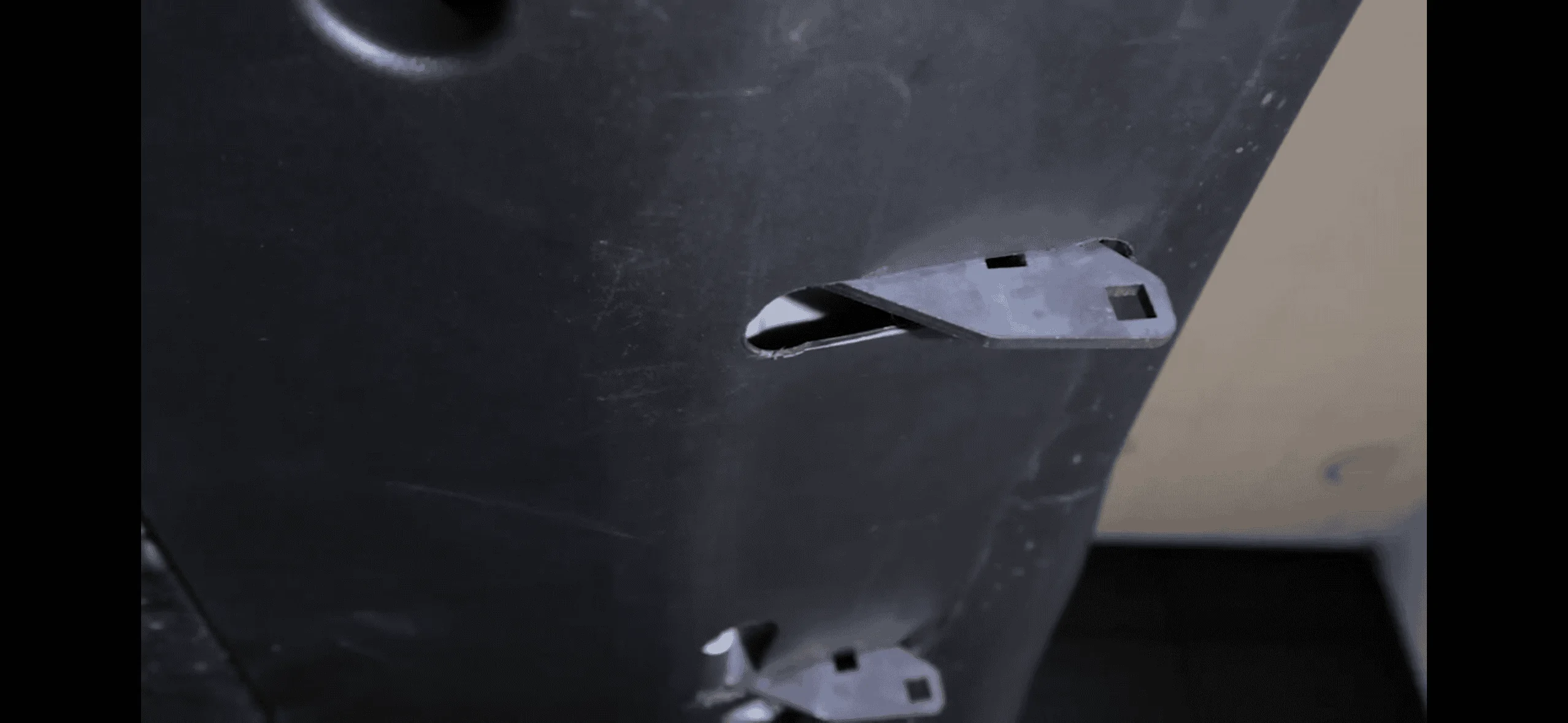

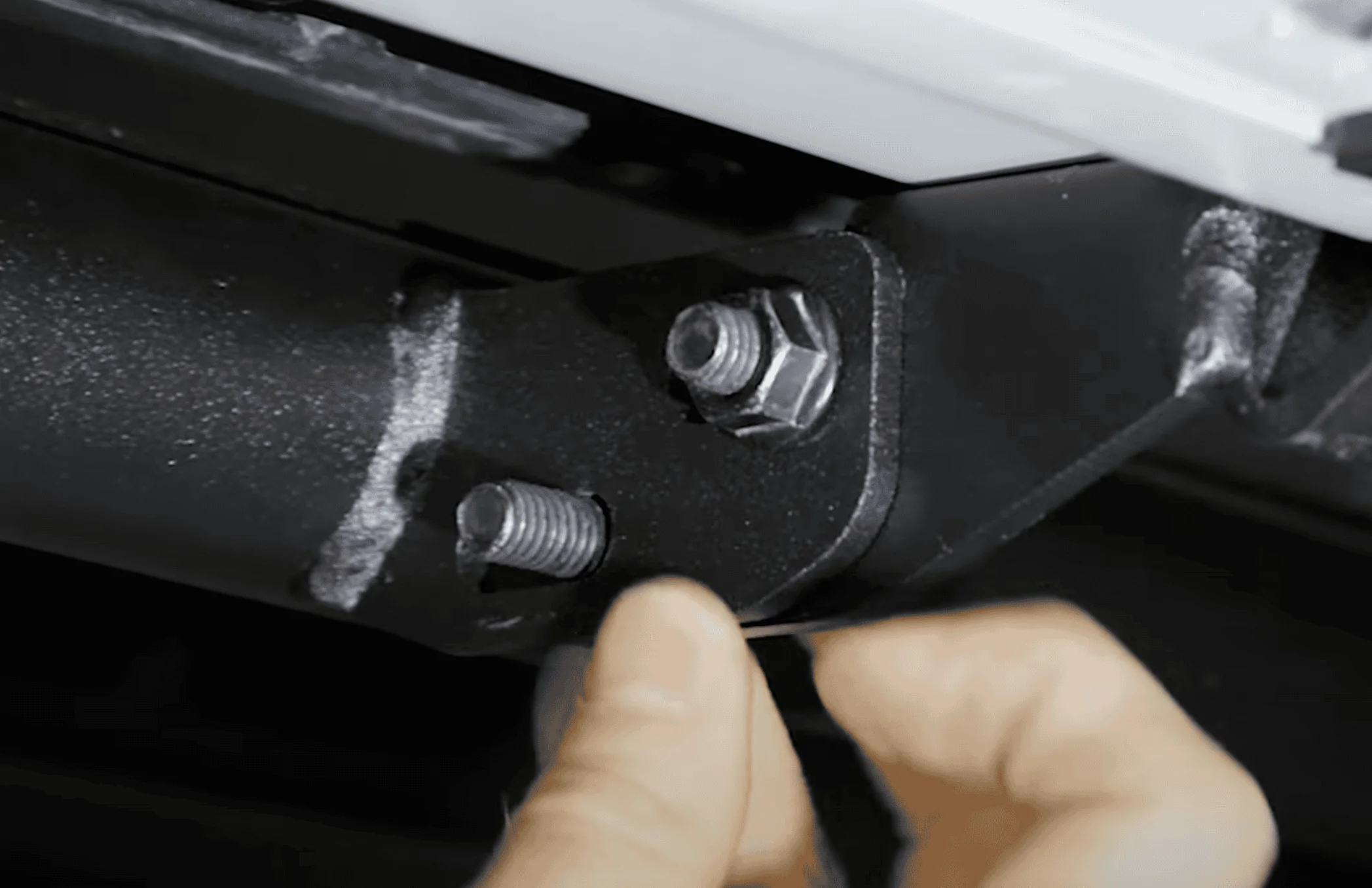

Update #2
I see another @EV Sportline plastic panel mod video was just released in the main product thread. Not a fan of "Option 1," eight 4" gaping holes. Re "Option 2," I might have to revise my "P3" above a bit, as it appears from the video (see attached screenshots taken from the two videos), that slotting the panels as shown may not allow access to the upper bolts on the running board brackets so you can bolt the boards back on to the brackets - after reinstalling the modded plastic panels. Bolts and nut interference with plastic panel (aft/rear side of each bracket, where bolt shaft and nut will reside), it seems to show.
Can’t tell for sure until after I receive the product…

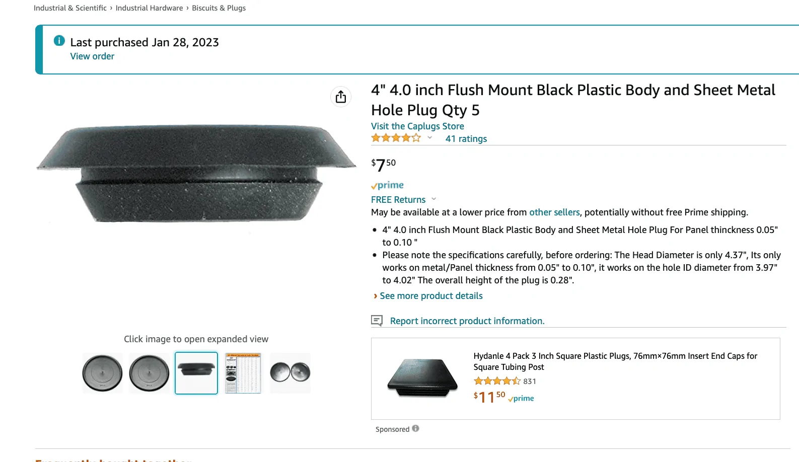

Absent a product in hand to work with, I'm still trying to figure out a viable alternative to the two @EV sport line proposed plastic panel mods - as having eight gaping 4" holes is not ideal ("Option 1") - visually, aero, wind noise, and most importantly (to me) water/dirt/mud/Fir needle/gravel accumulation (between the plastic panels and steel frame). This is not an issue with the stock panels as there are no openings large enough that would allow debris/mud to build up between the panel and steel frame, only enough for water to drain. This issue also exists when leaving the panels off all together - dirt and debris will collect between the aft most remaining plastic and frame, in front of the rear wheels, as there will be nearly a 1/2"-1" gap there. "Option 2" appears to have bracket bolt/nut interference issues, rendering it possibly not viable (see above post).
So, as I continue to noodle about how to make "Option 2" more viable, while continuing to "stick" with my "P3" approach (see above), I've given some more thought to improving "Option 1".... For those that go with the 1EV's "Option 1," a possible improvement (to mitigate the concerns I've listed above) is to slot and install 4" rubber plugs in these eight 4" gaping holes. A set of five can be had on Amazon for less than eight dollars (link below). I may also experiment with 3" holes and plugs as well. More to come (eventually) when I receive my set...
https://www.amazon.com/Flush-Mount-Black-Plastic-Sheet/dp/B011HCOUZ0/ref=sr_1_9?crid=JCFUS9B8REDD&keywords=4"+rubber+plug&qid=1674921249&sprefix=4+rubber+plug,aps,160&sr=8-9
Note: I would have posted this info in the EV Sportline/1EV/RMaxx product thread, but for some unknown to me reason I do not have "sufficient privileges" to post in that one any more as I receive the following error message in only that thread, "You have insufficient privileges to reply here"...
Edit: Added plug picture

Very curious to hear if those 4" plugs work!
I'm confident they will work, but who knows when I will have boards to mount and confirm. Shipping continues to slide (mid December to now perhaps February), unless you're getting an install at the ATL shop...
