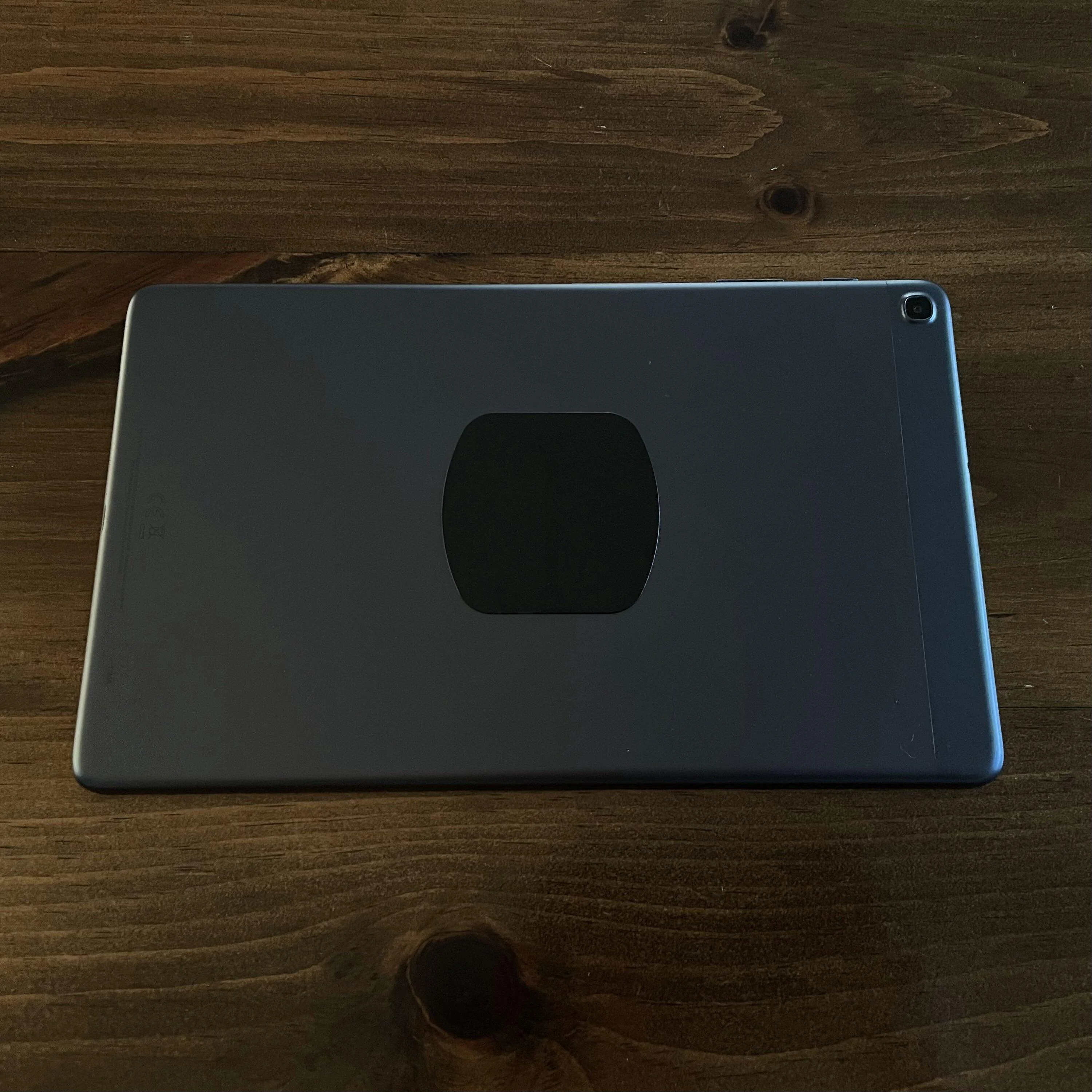

They come with a metal plate to stick on the tablet, and once this is on, the magnet is super strong.

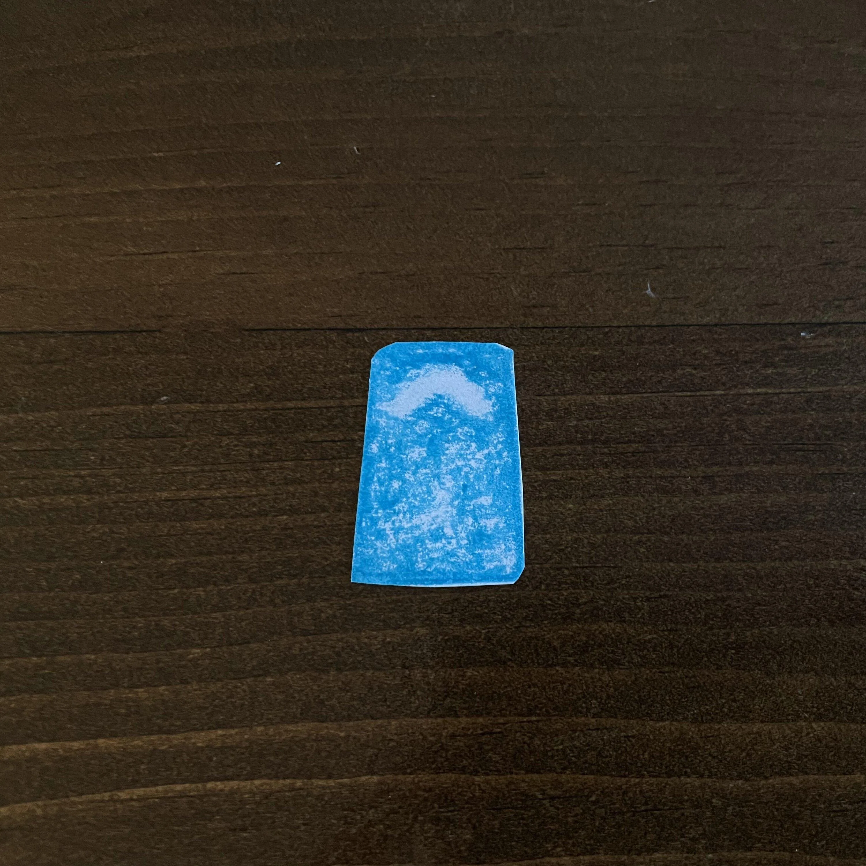

To mount them to the headrest hook, it is just 3M adhesive. The magnet mount is larger than the hook on the truck. You can just peel off the tape and stick it on, but I didn't want it attracting dirt and fur (dog, not kids) on the overhanging area, so I broke out my art class skills and made a crayon tracing of the hook, and cut that to use as a template for where I should remove the backing.
Rivian R1T R1S Magnetic Tablet / iPad Holder Mounts installed: feedback, review, notes & photos 20220625_233857812_iOS
(It is symmetrical on the truck, but apparently I need to attend some remedial art classes to refine my tracing skills.)

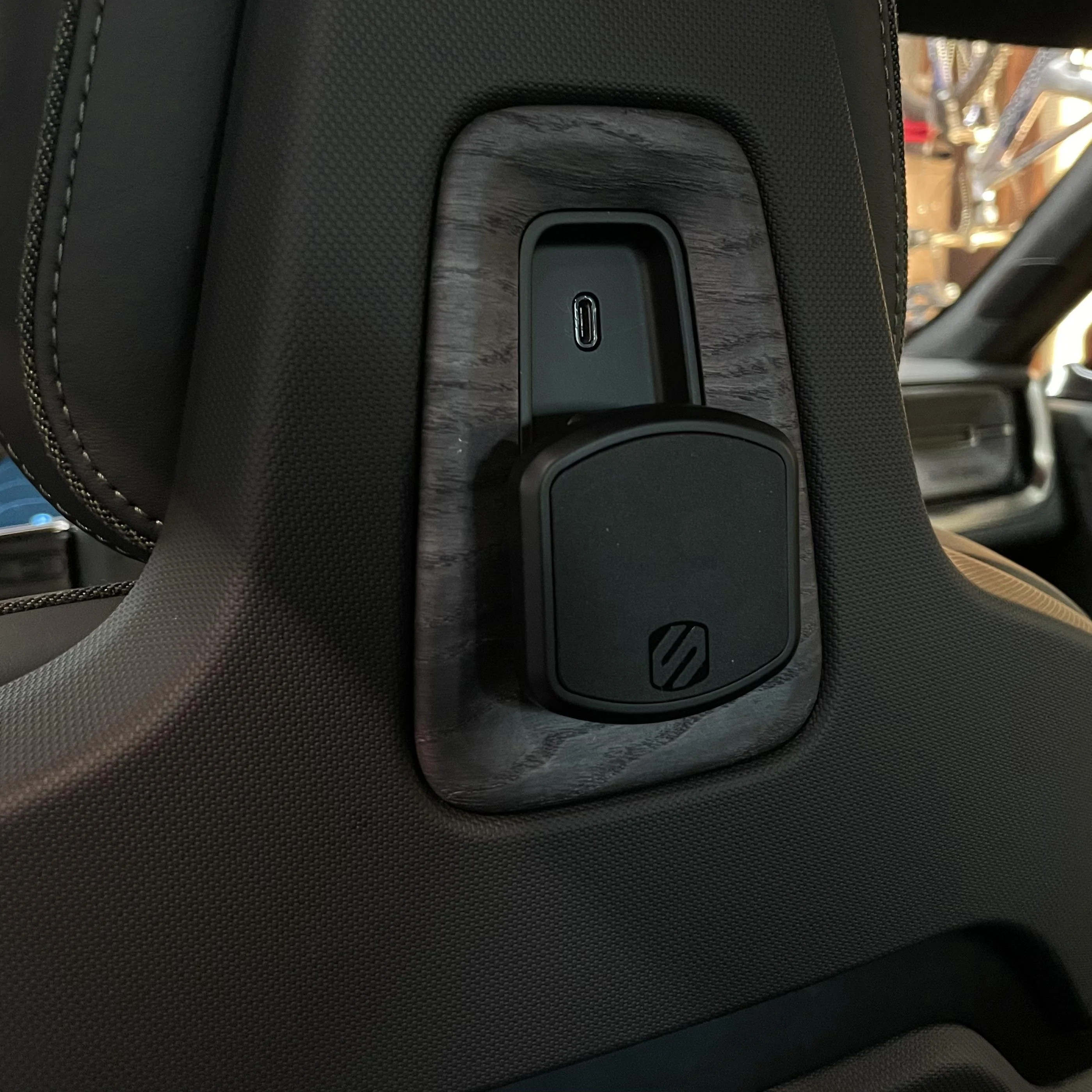

I used a knife to cut the inside of the line and then stuck it on. You notice I offset the mount so it was biased to the bottom. This was to give clearance for the power outlet.
Rivian R1T R1S Magnetic Tablet / iPad Holder Mounts installed: feedback, review, notes & photos 20220625_234222672_iOS
The mount comes with black and silver trim rings. I chose the black so it will blend in more. The silver ring will also be used later.

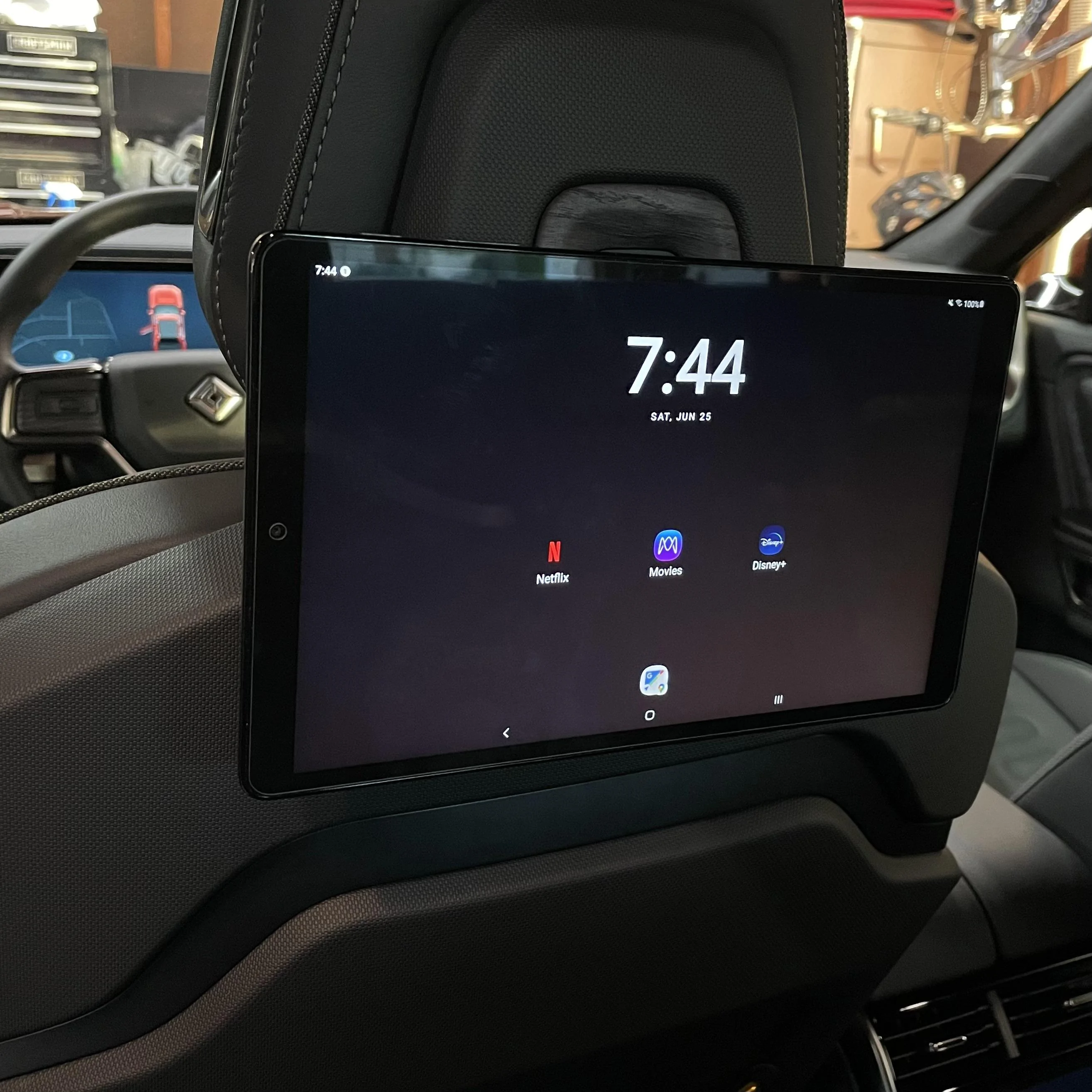

The tablet fits perfectly there, and looks great.

A short right angle USB C cable will be used for power, but you have to be careful with the style of the right angle as some aren't sharp enough and will not fit with the wood piece. I would have loved to use a 1 ft cable, but the shortest I could find that worked was 3 ft. I will just wrap it around the mount to keep it tidy.

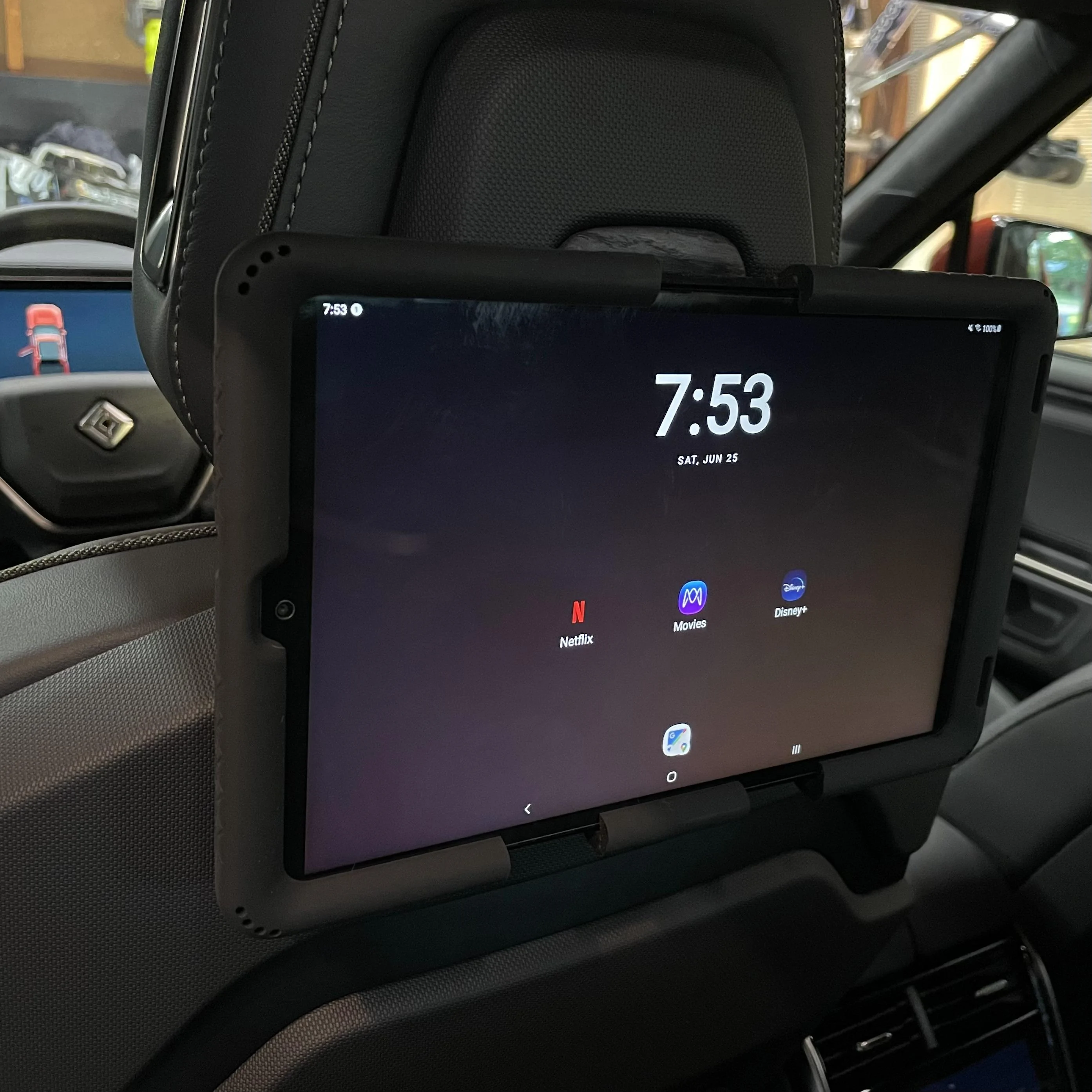

You could stop there, but I know I don't like the bare tablet there as I have knocked one off the old car and shattered it, so I wanted to put some kind of bumper style case back on it. The problem was the case was thick so the magnets don't work well through it, but that shouldn't stop you.
I used the extra trim piece as a template for the shape to cut into the back of the case. Some careful measurements, cutting and a little trimming gets a hole in the back of the case where you won't see it (so it doesn't have to be pretty), but allows for strong magnetic attraction. I used the case I had cut previously for our old mounts because new cases won't be here before we leave, but everything worked as expected so I will order new cases for a cleaner appearance.

Finally the finished product ready for adventure. Probably best for on-road adventures, not sure if I would trust it bouncing over rocks, but the kids shouldn't need more than the windows for entertainment then anyway.
