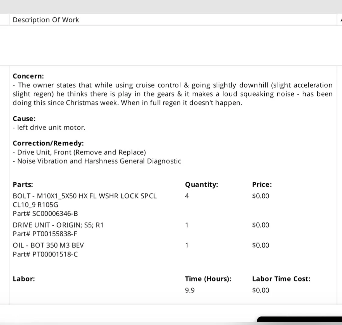

Not sure if my issue applies since it's hard to hear your noises in the vid. I had some noise while in conserve on freeways while in Driver+ and slight downhill where the drivetrain is in kind of no man's zone going between very slight accelaration and regen. I thought the SC wouldn't do anything but they contacted engineering and replaced my front drive unit

Thanks for the response. I’m hoping it’s not a bad drive unit.
Would you be willing to share a screenshot of the work order paperwork? It may help me describe the issue to the SC I’ll be using (Richmond).

Here it is. I didn't tell them it squeaks. Said it makes an eh, eh...eh...eh...eh eh...eh like noise.
Thank you for sharing!
