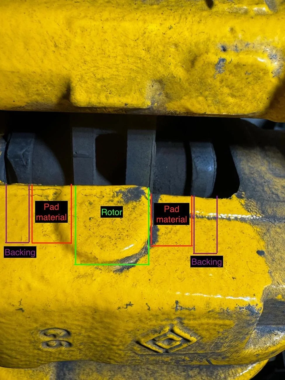

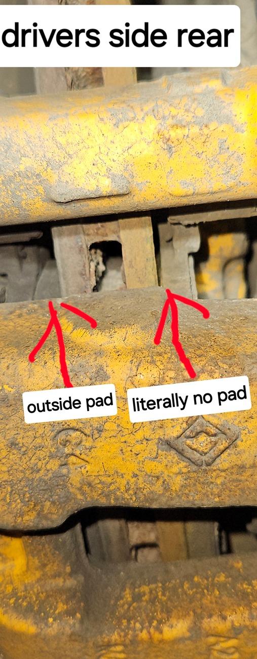

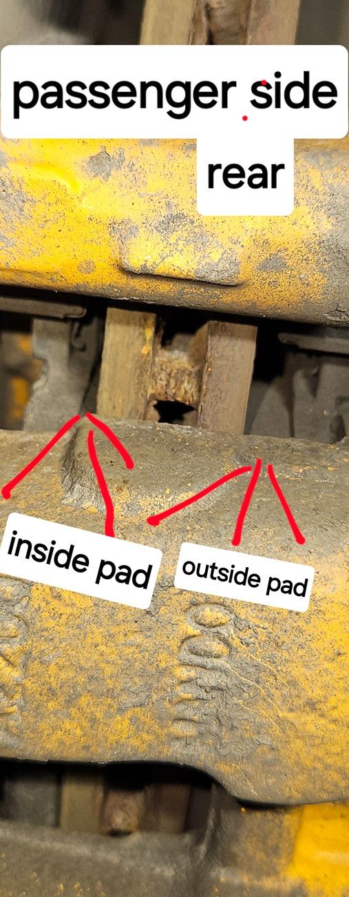

Rivian R1T R1S Lotta Brake Dust - R1S Quad 1000020312
Rivian R1T R1S Lotta Brake Dust - R1S Quad 1000020313
But as I have posted many times before. Rivian will tell you this is normal and charge you $1,000 to replace. Blended brakes feature never on.

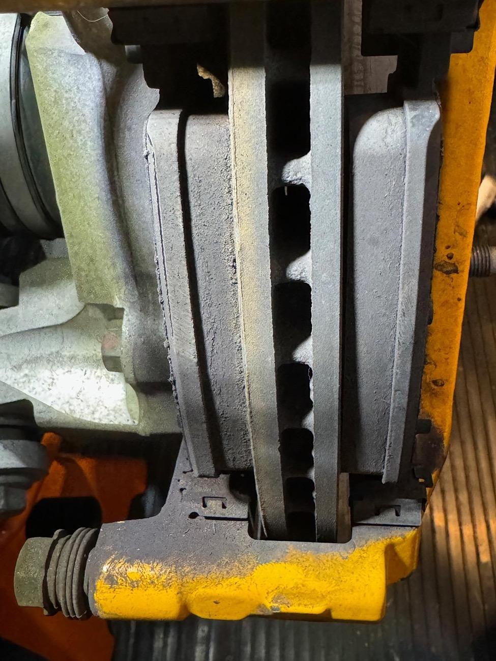

These are my rear brakes at 32k miles. Virtually zero wear anywhere.
