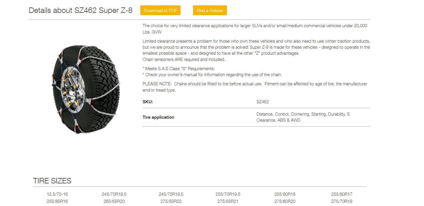

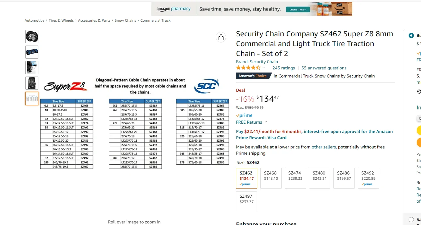

We just spent the week in California R2 chain controls.
4WD with M+S tires okay, but must carry chains. (er.... "traction devices")
For 21" the manual explicitly recommends using snow cables 16mm or smaller.
These are what we brought with us. Didn't use them, but they fit perfectly:
https://www.amazon.com/dp/B000HZFDSC

CONFUSED. The fit guide doesn't list the any 21" tires, much less the specific 275/55/21s. What am I missing?

Yes, thanks. I saw it listed at the Peerless.com site and it linked me to Amazon site too. But once at amazon, no joy. Hopefully Aroohoo or Smitherly can confirm; seems like they actually fitted them.

Question - You actually put these on the tires? Wanted to confirm before I order. Can you also send me the exact model/sku for it? much thanks.
Smithery
Oct 16, 2020
404
737
MX 100D, XC70, Cooper S JCW, R1T Large
Yes, of course. Your Rivian's wheel/tire looks exactly like the photos on the Amazon listing.
SZ462 is the right one.
You can verify on the companies website here
