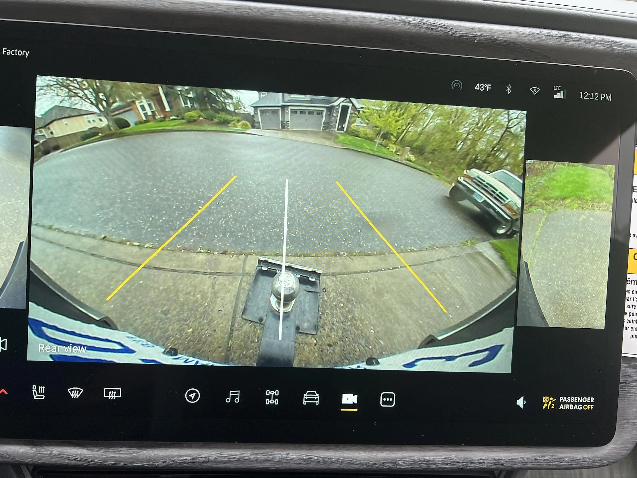

Since I haven't seen close-up photos posted yet - I had my First Mile test drive today, and they let me take the receiver "hatch" off to poke around.
Rivian R1T R1S Let's talk towing R1TReceiver
Standard 2" box receiver with 7-blade socket. No 4-pin, so you'll need a 7-to-4 adapter for 4-pin.
Rivian R1T R1S Let's talk towing R1TCameraBall
Backup cam *DOES* show the ball just fine (I had a 1-1/4" box-to-ball adapter handier than a proper 2", so it's just loose in there, hence the ball not being centered quite right.)
The "black rectangle" around the ball is the receiver cover sitting on the ground underneath. Hadn't realized it was lined up that way when hopping in the truck to check the camera. :-D

Thanks for pics and description of the hitch receiver @CharonPDX.
That receiver still looks tucked under quite a bit, do you think we will all need hitch extenders for proper turning and clearance?
Cheers.
CharonPDX
Charon
Jul 12, 2021
1,113
1,584
Cascadia
InfoSec Geek
It wasn't that far back, considering the bumper is essentially flush with the back of the tailgate.
