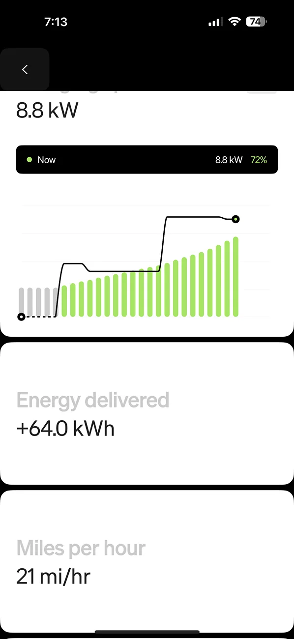

2023 Rivian R1T
2023 R1T Performance w/Max Pace using a 40amp Tesla Wall Charger with a A2Z adapter.
Software: 2024.51.02. Problem started with 2024.50.01
SOC was 27% and scheduled to charge at 9pm in a 60 degree to 75% in a heated garage.
From 9pm to 3am, charge rate is 20amps.
From 3am to completion, charge rate is 40amps.
It appears from about 10pm to 3am, the charge rate drops about 10-15%, then gradually goes up.
I have two Tesla Wall Chargers and I'll try the other one just to rule out the wall charger.
Will be calling Rivian today to see if they have any answers.
Rivian R1T R1S L2 Charging at 50% is back IMG_0400

I feel like I've heard of people having issues with AC charging rate while using adapters with Tesla Wall connectors. I have only personally experienced behavior like this one time (ironically at my friend's house with a Rivian EVSE). I've never had issues charging with my openevse unit.
