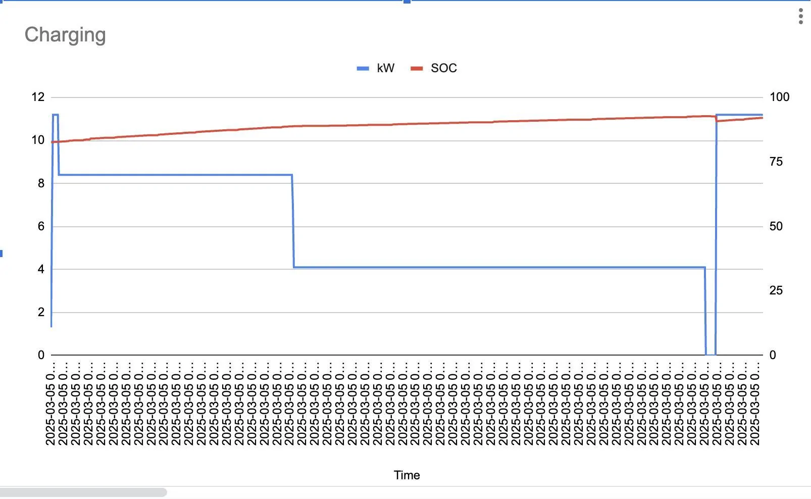

So, I finally got my R1T Tri Max and did some testing. It said out in 40F weather for 72 hours and got cold soaked. I upped the charge limit to 100 and watched it derate pretty aggressively. At 92% I took it for a very spirited drive for 9 miles. Watched it climb back to 92% at 11.2
This is almost exactly what I saw on my Gen 2 Dual Max this past weekend when I increased the charge limit to 100% while plugged into my 48A Tesla HPWC. Temperatures were somewhere around 40 degrees as well. Hopeful that the update rolling out fixes it!

I just tested this on .10 and while my pack wasn't as cold as before (49F vs 46F) it held 11.1 kW up to 85%.
