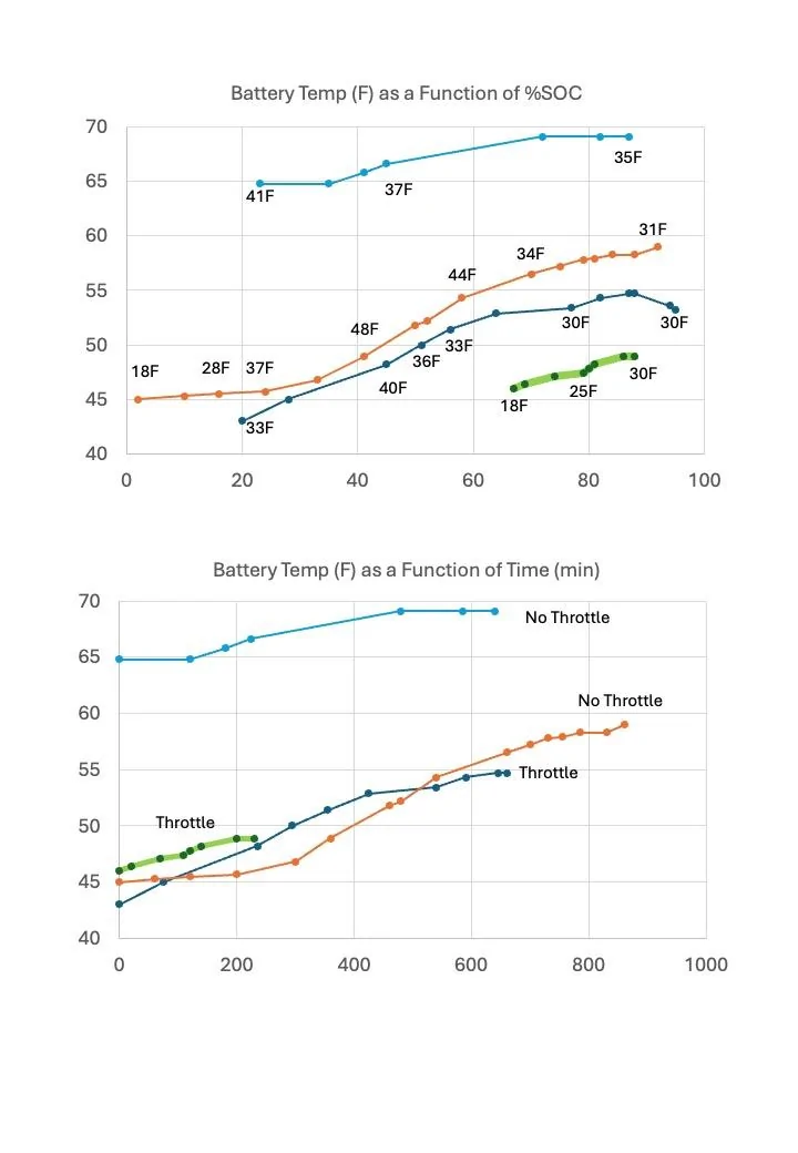

I had a very long charge session yesterday where I did not experience throttling up to 95% SoC. ABRP battery temperature was around 58F at the critical 80% SoC. Rivian temp was 4-5F lower at start and end of session. This charge session was pretty similar to the one where ABRP temperature peaked at 54.7F and throttling occurred. Inspired by watching the preconditioning behavior on my first long road trip with multiple DCFC charging stops (another topic, but sadly unimpressed - took an extra 2 hours to cover the 600 miles compared to my Ioniq 5 - charging curves were awful, dropping to 60-70kW at ~40% SoC on Tesla, EA, and RAN chargers - not sure if I will use the Rivian to raod trip again - it's turning out to be a summer-time local play vehicle), I plotted up battery temperature data as a function of time and SoC for my post software upgrade charging sessions to try to understand what might be happening.
Rivian R1T R1S L2 charger down to 2.7kwh at 24F.. Should I be worried? Rivian Charge Plot
The plot of battery temperature as a function of SoC seems to be more systematic. The red line is yesterday's "successful" charging session. The dark blue line is the "unsuccessful" session. The data hints at a couple things:
1 - There appear to be differences in "heating rate" as a function of SoC. Heating seems to be faster between around 30 and 60% SoC, and then slows down.
2 - For some reason, the heating rate slowed significantly above 60% SoC in the unsuccessful charging session - the battery temperature actually fell as the charging session continued.
3 - The only differences between the successful and unsuccessful sessions are (a) starting battery temperature in the unsuccessful session was 2F colder, and (b) ambient temperature through the critical 30-70% SoC was about 8F colder for the unsuccessful charging session (even though the successful session started much colder). Ambient temperature had fallen to arbout 30F when the heating slowed in unsuccessful session.
I think the data suggests that the software is not telling the truck to "heat to X degrees", but rather that there is a set amount of power going into heating (if it is even that sophisticated), and that when the ambient temperature is colder, there is too much heat loss to allow the battery pack to hit whatever exact temperature is required to avoid throttling. This is different from how the battery preconditioning for L3 charging seems to work - the truck is pushing the heating to reach a specific temperature.
One other observation that I am at a loss to explain is that 45 minutes after I stopped charging, ABRP battery temperature had increased another 3.5F to 62.2F. This is much faster heating than at any time during the charging session - almost 7F/hr compared to a peak heating rate of 2F/hr during charging. Am curious if anyone has any thoughts. In the session with battery temps in the 60s, the battery pack temperature dropped 9F in the hour after charging stopped.

@COMtnEV This is great data! Do you think this supports the theory that once a session has been throttled, the truck cannot recover from it? To state it another way: the session will be throttled unless the pack has reached appr 55F prior to 80%.
Re: the discrepancy between the temp shown on ABRP and the Rivian Drive Mode menu, my hunch is ABRP is reading max cell temp and the Rivian Drive Mode menu is giving minimum or maybe average cell temp. From using the CarScanner app on other EVs I’ve seen all of these variables and assume Rivian is monitoring them all as well.
I’ve had good luck with the ABRP team being responsive to feature requests. I may hit them up to plot out temp as a function of SoC.
At this point, I would agree that once the truck throttles, it will probably continue to throttle. The only caveat being that if the battery pack is truly warming after charging stops (I am going to track that a little more carefully going forward - I've seen it at least once before), it might cross the magic threshold after 20-30 minutes, and then if you started charging, it wouldn't be throttled. at t
