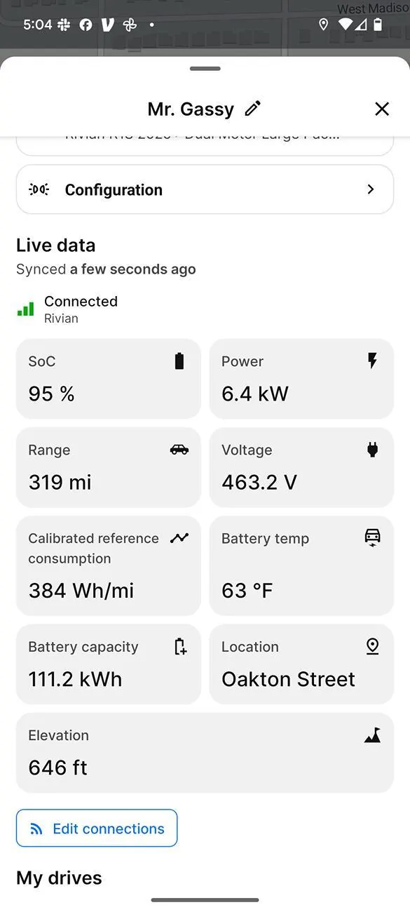

Tried the fast charging precondition trick today for the first time. Didn't throttle until 95% but it did still throttle. Battery temp at start was 54F according to the car and 59F in ABRP (first time using that as well -- why different readings?). ABRP battery temp 63F when it started throttling.
Forgive my ignorance of ABRP, but that shows your battery capacity as 111.2kWh?

I must have missed it earlier in this thread. (I am following this pretty closely.) I was under the impression that this was a Gen2 Max issue. Are you saying this impacts the Large as well?
IMO throttling at 95% is not really unusual. My Mach-e starts throttling over 95% (I am not sure exactly where, but if needed I can find out,) L2 throttling at 80% is not normal for the BEV industry. My MME has never throttled at a SoC that low, even when the battery was frozen.
Another question I have is: do you have a Large+, or a Large? If you have 80% throttling and have a Large+, that throws out the capacity theory.
OYLman
Jan 11, 2025
2025 R1S
It's a large, not large+. And throttling has affected me since I got the car in December.
