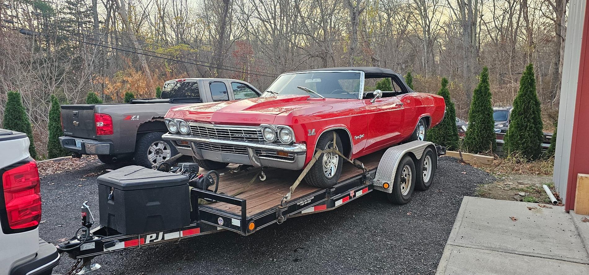

how about posting some pics of the ragtop :)
