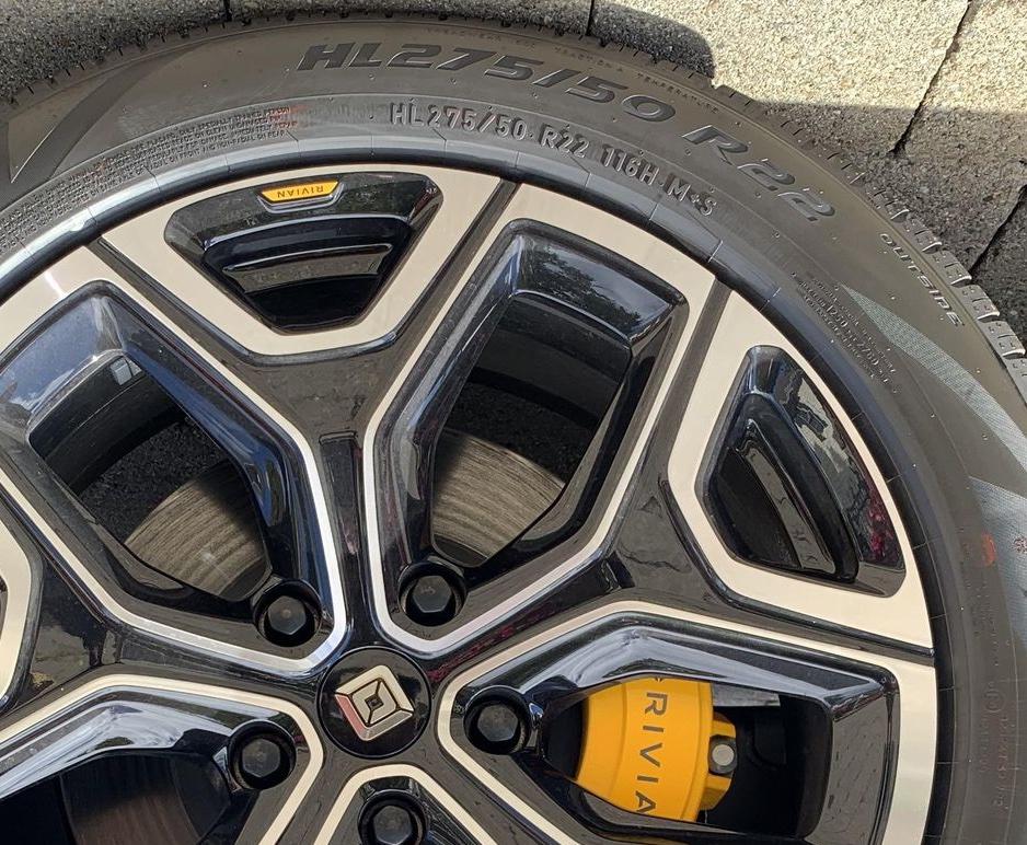

Wow ok well I hope tirerack is sending out the right ones because on their site it says 115h
The 22's that shipped with my truck are 115H. I wonder if Rivian bumped the spec up to 116H for the Max Pack trucks...

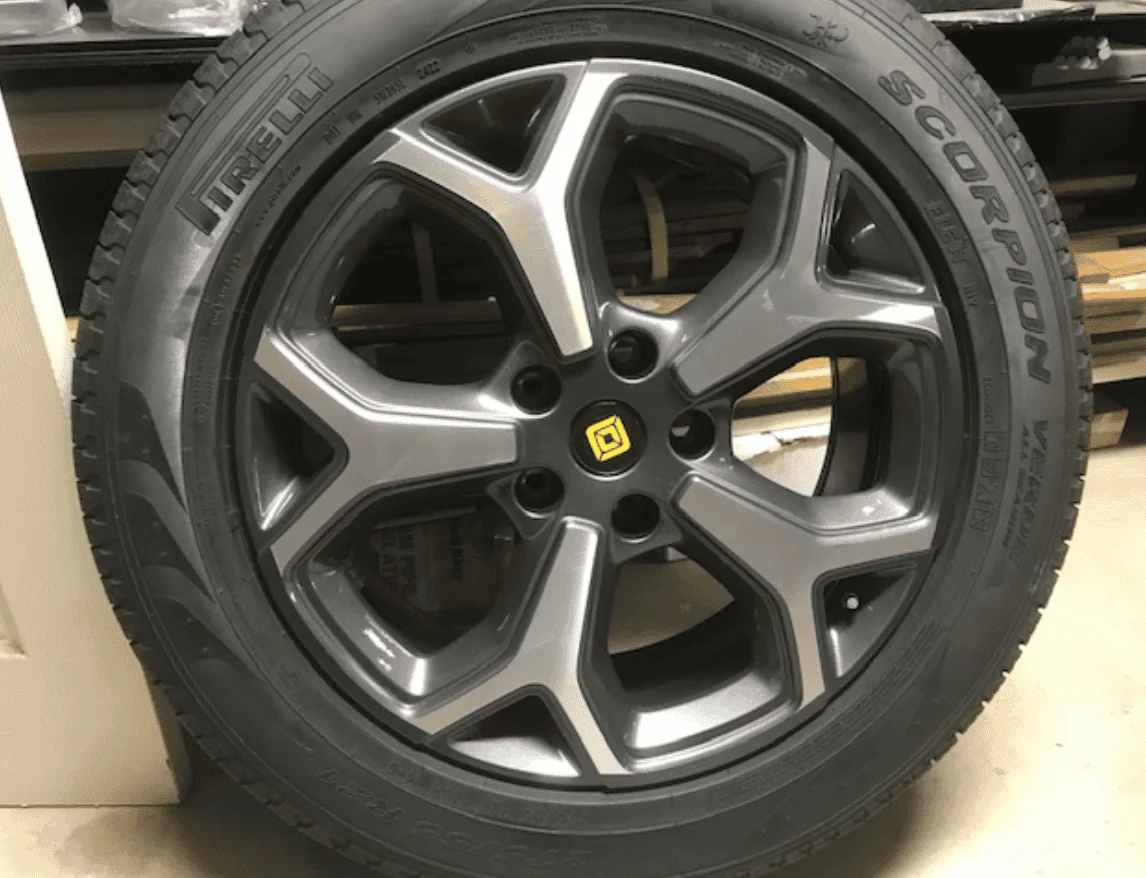

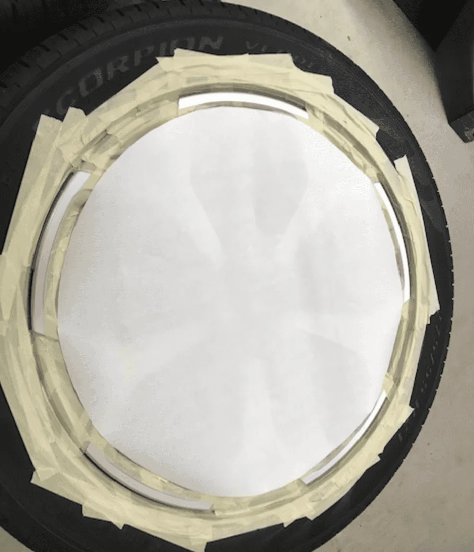

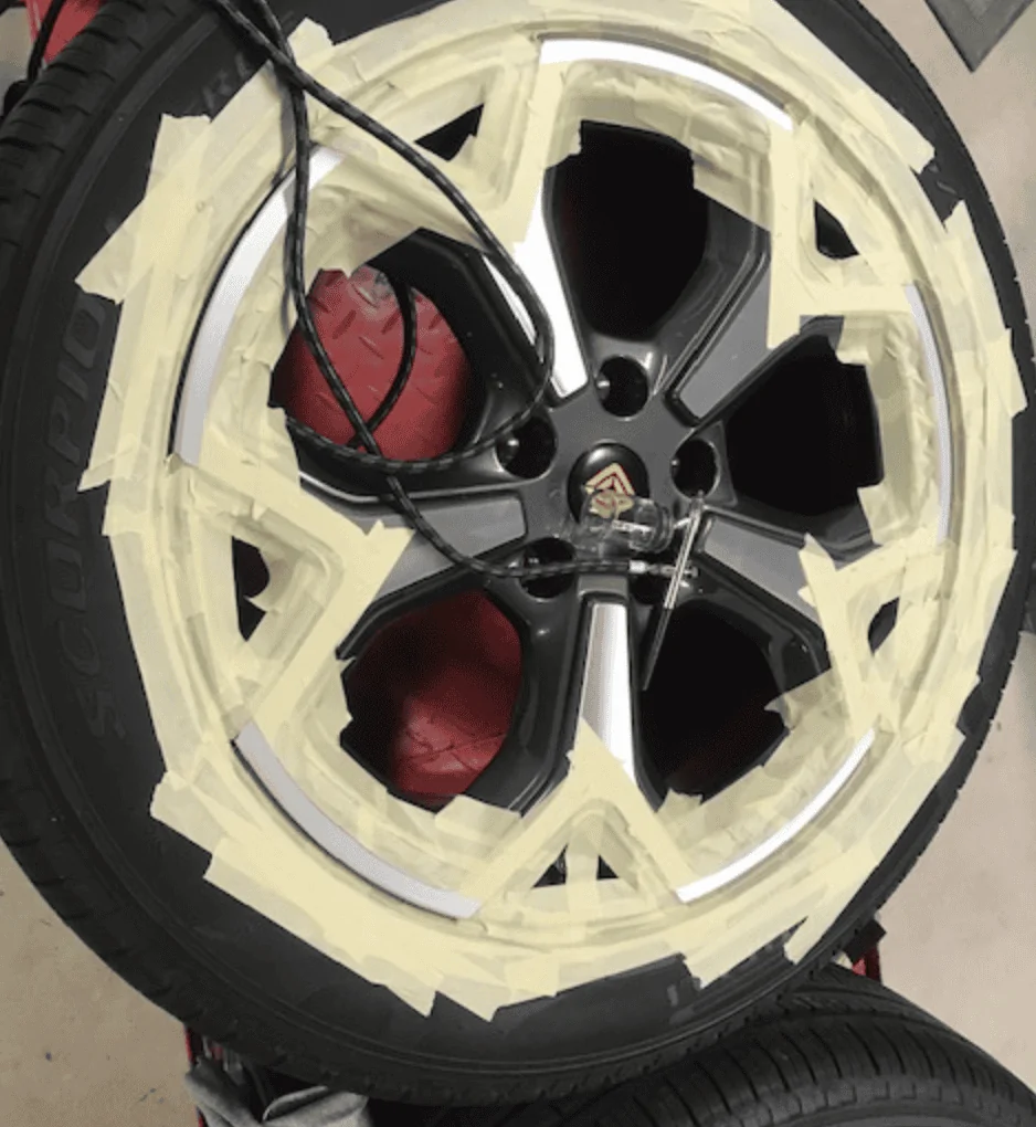

A lot of people do not care for the look of the 21", this is the main reason I got the 20". I was able to purchase a set of 21" and did some cosmetic changes. I think, now, I actually like them better. The difference is subtle but I find it much better looking. I will use the 20" for my snow tires in the winter. At least this method gives you a choice you may not have thought about.
I only matched and airbrushed the outer polished rim of the 21". It did take a while to mask. After spraying the color, I remasked and sprayed clear coat so as not to leave a "lip" at the edge of the paint.

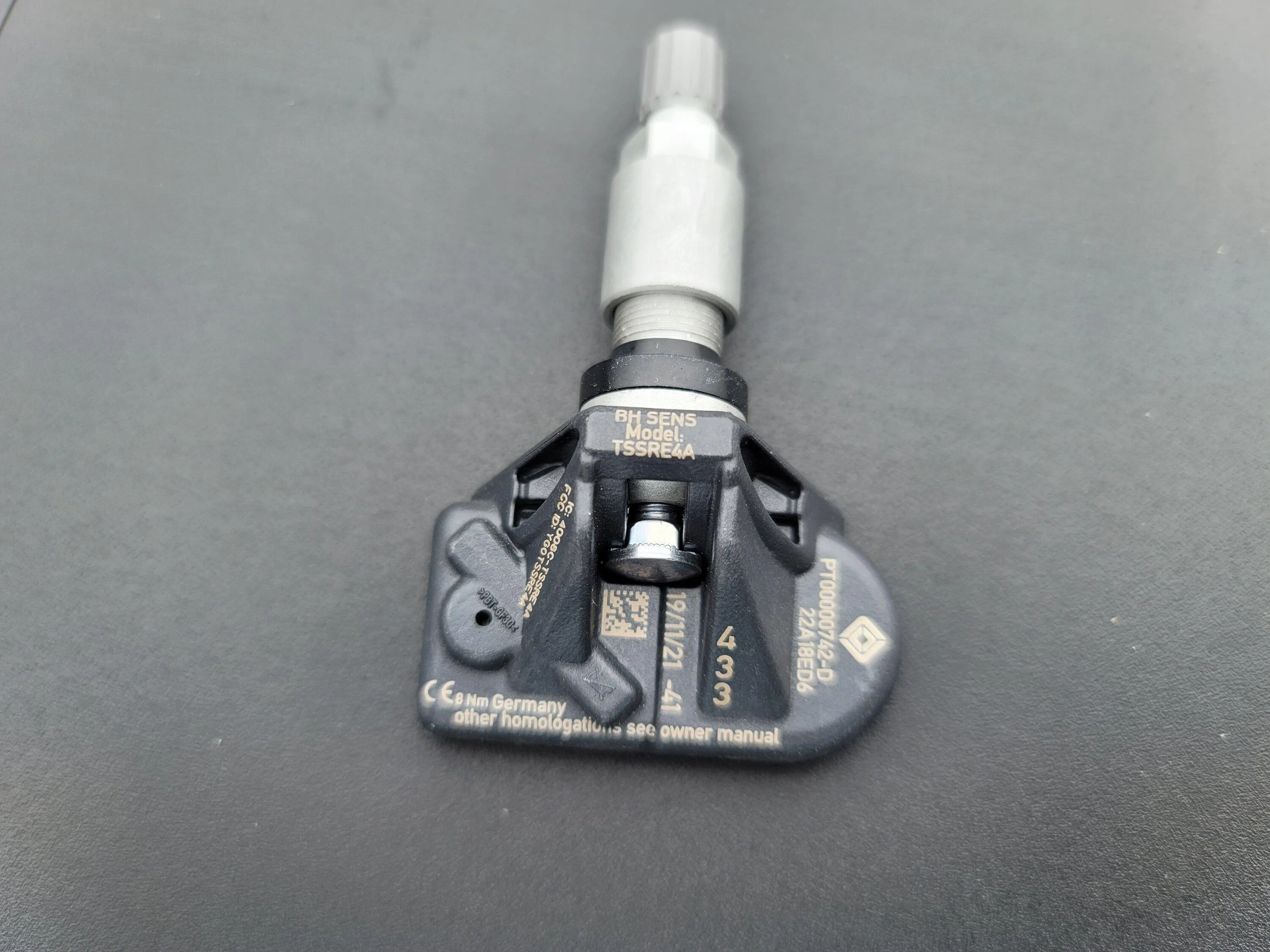

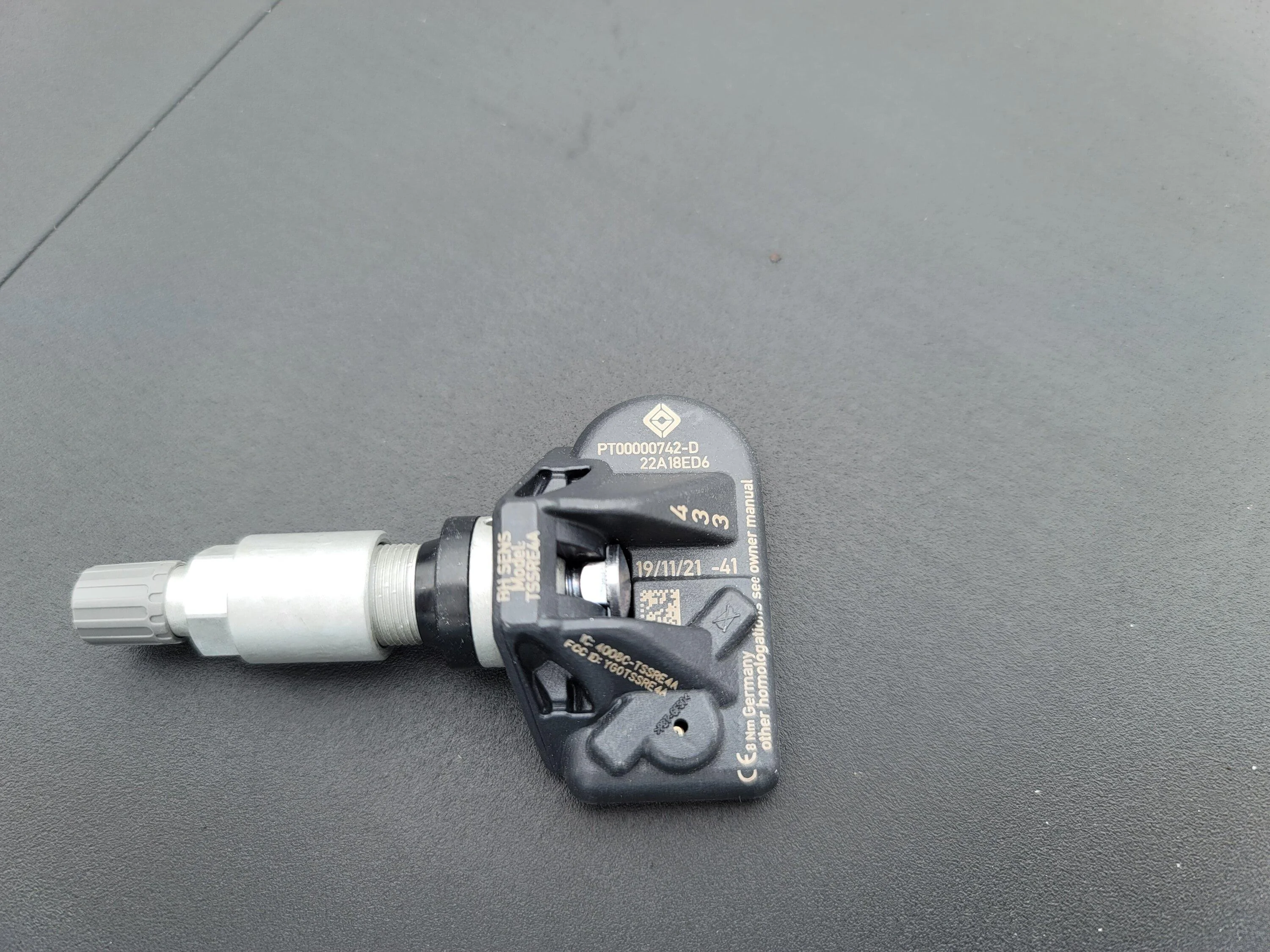

Just picked up tpms and center caps for the 20s just now... if anyone's interested I have posted pictures below of the tpms in case you think some aftermarket ones will work
In here at discount tire and definitely had to have them think I'm installing these on a different truck...I told them a navigator but it would be better if you found a truck that has these similar specs on tires and tpms that use 433hz frequency as they kept telling me not to install these tpms on these wheels lol... even though it clearly has rivian on the wheels in bright yellow 🤣

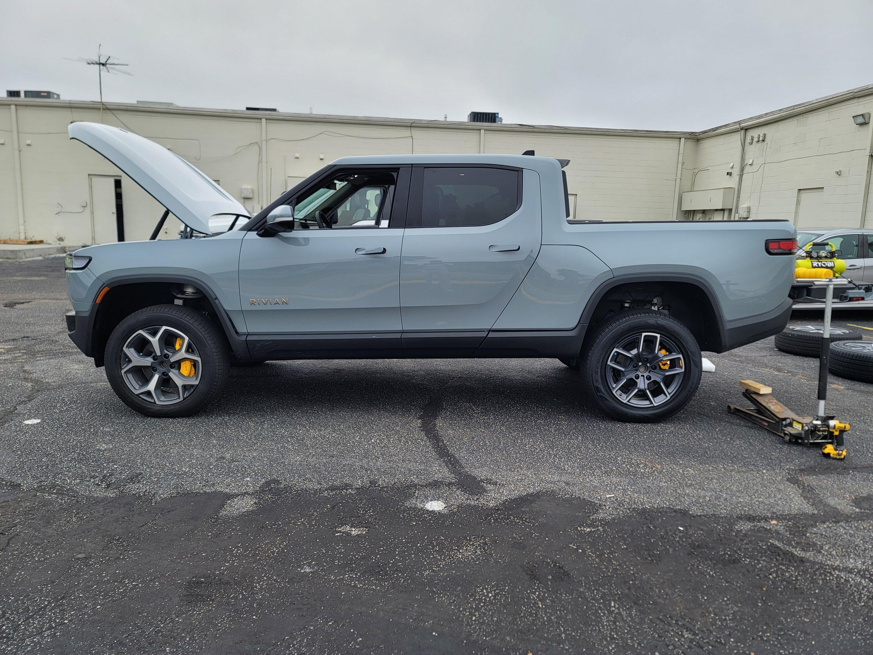

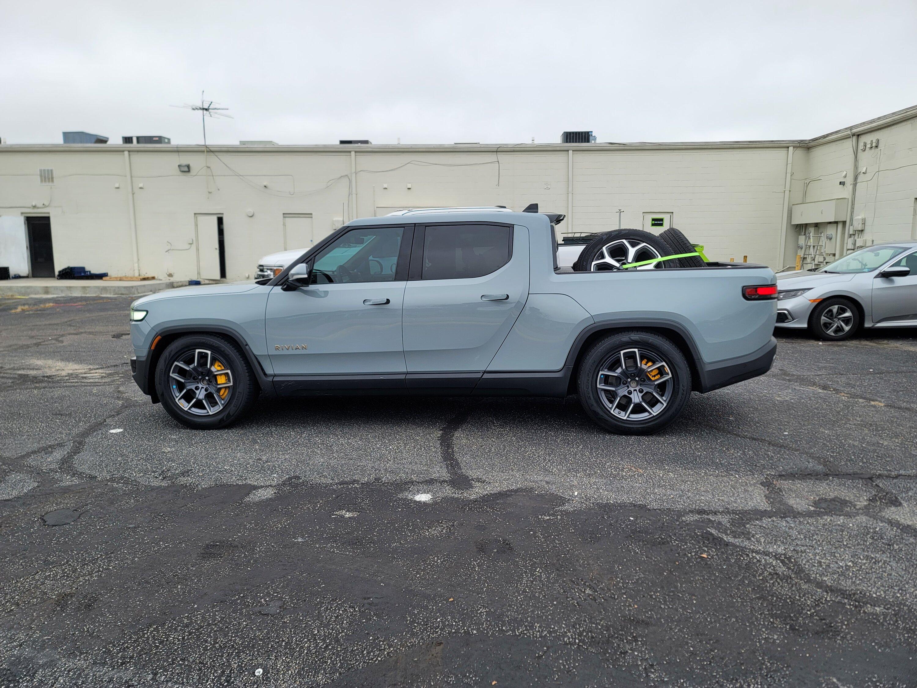

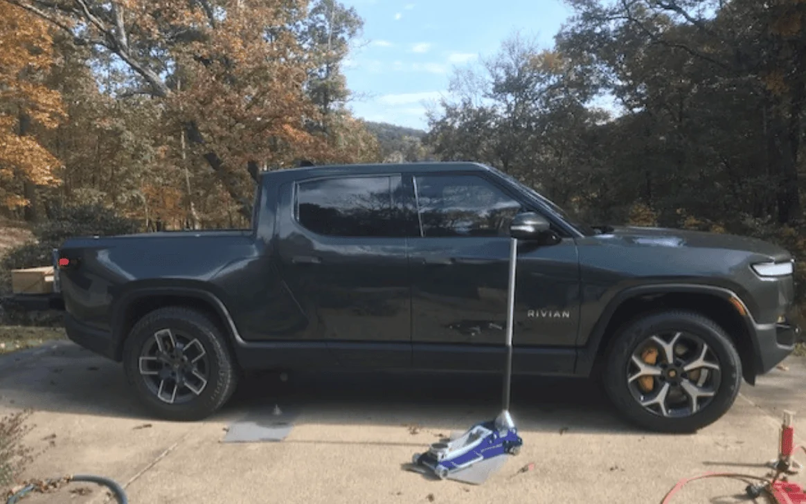

Initial impressions of the 275/60/20 pirelli scorpion as plus 3s vs stock 21 pirellis is that they feel slightly more compliant/ comfortable... other than that there seems to be no difference in noise feel.
I've driven about 20 miles on the highway in comfort and seems to be getting about the same efficiency also but I'm going to charge to 100% tonight and drive it down to 0 in the next couple days to compare... weather for next 3 days are going to be about 70f and sunny so prefect timing.
Also included a picture of the difference between the looks of 20 vs 21 side by side

Thank you for posting! SBS pics are incredibly helpful.
Also the first pic I’ve seen of the 20s wearing road tires. It occurs to me that much of the aesthetic appeal (to me) of the 20s is the tires. I still love the 20” wheels, but they take on a very different look with roads vs. ATs.

Absolutely...I definitely like the aggressive looking tires better but definitely don't want to daily with them... plus I really want the efficiency which I feel like I'm always chasing.
I really do hope these end up being a little more efficient as the entire setup is about 15 lbs lighter than the 21s
